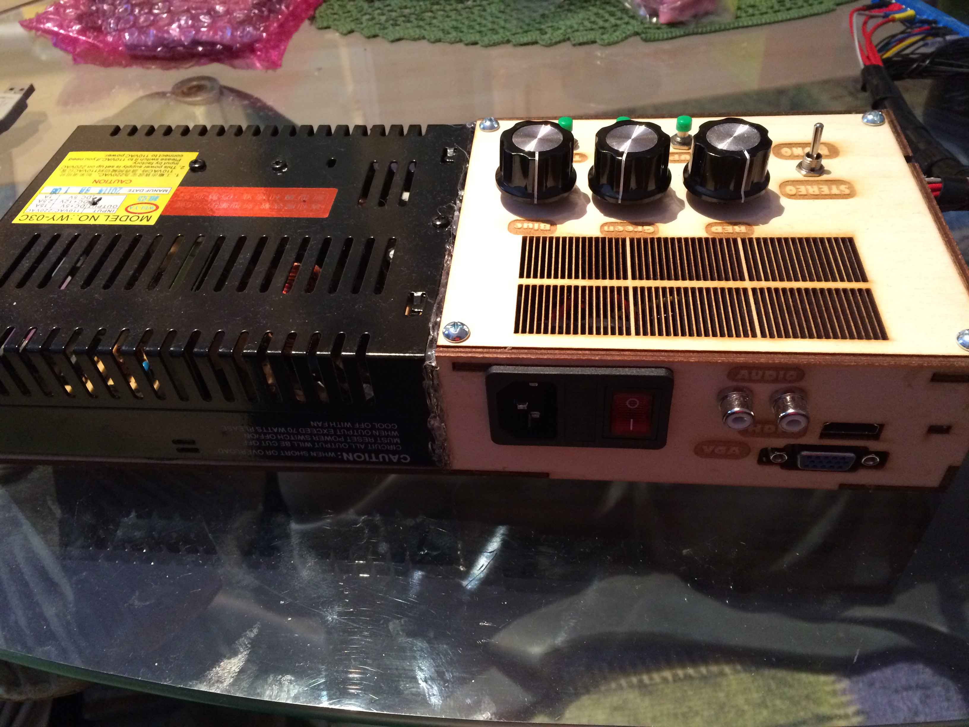

Which supergun do you have?
My very own design. :whistling:
But I doubt that its a problem of that. Since jamma is basically wiring a button to the connector on the pcb.
