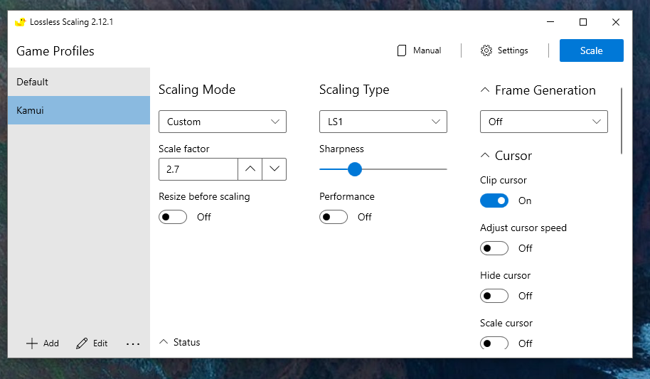

Lossless Upscaler for Older Games
You can override older games that are limited to small window modes, have bad full screen support, etc using lossless scaler (Kamui,Raiden III,etc).
Kamui crashes on every computer I own when trying to use fullscreen mode and I have to use window, lossless scaler allows me to overrite this,
Max Window Size
Lossless scaler forcing a fullscreen mode and scaling max window
Settings example for Kamui, Raiden you can leave it on Auto and it does well.
Max Window Size
