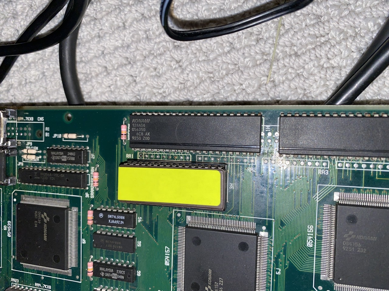

tacobell Grand Master Joined Jan 17, 2020 Messages 484 Reaction score 1,239 Location SoCal Nov 26, 2020 #1 I loaded up Mystic Warriors after almost 2 weeks of not using it to find some graphics issues. I’m not sure how to fix this one as this is above my skillset too. Any suggestions welcomed. Thanks in advance! Attachments A544D13E-8676-45A4-B514-5409B6DF573D.jpeg 512.4 KB · Views: 208

djsheep Multi Boyz Overlord Immortal Multi Boyz Joined May 20, 2016 Messages 8,551 Reaction score 16,003 Location Brisbane, Australia Nov 26, 2020 #2 Reburn the ROM. Someone here might help you.

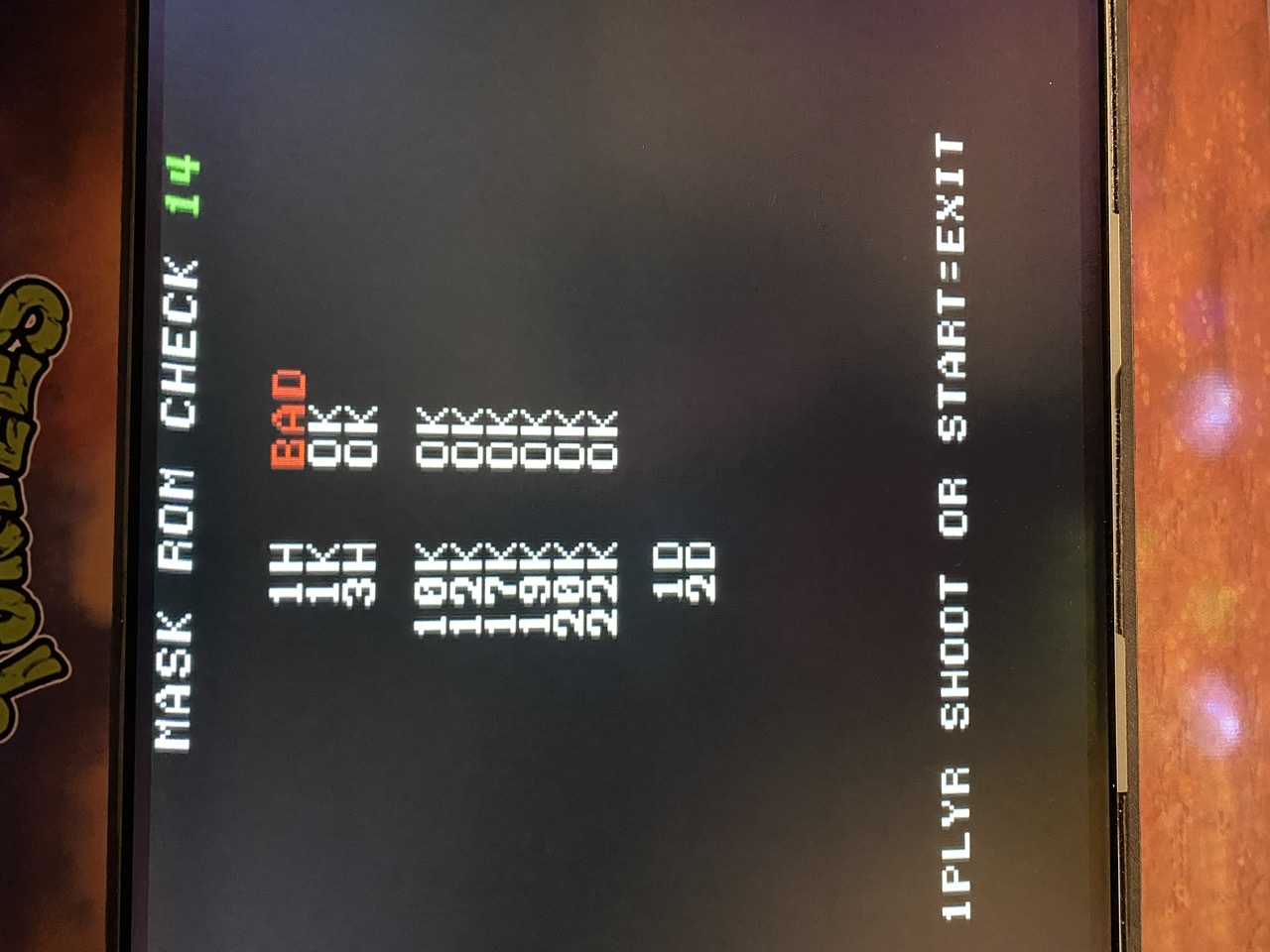

A Apocalypse Nov 26, 2020 #3 djsheep said: Reburn the ROM. Someone here might help you. Click to expand... It's actually a soldered mask ROM. First check traces continuity. If all OK pull the ROM and burn a replacement (IIRC you can use a 27C800).
AlxUnderBase Enlightened Joined Jan 25, 2018 Messages 2,831 Reaction score 3,616 Location Constanta,Romania Nov 26, 2020 #4 @dannahan ... Yes sir ... follow the Apo advice for your refference : 22K , 20K , 19K , 17K , 1K, 1H = 27C800 3H , 12K , 10K , 19G , 19F = 27C040 1D,2D = 27C160 20F , 20G = 27C2002 6B = 27C1001 18F = GAL22V10B - 15 as reference : 1H , 1K , 3H keeps GFX1 on them (graphics) Hope will be fine and it's a only an eeprom and not any faulty ic . Also ... there's sounds missing . The game should start with a nice soundtrack , Terminator 2 movie style Cheers Last edited: Nov 26, 2020
