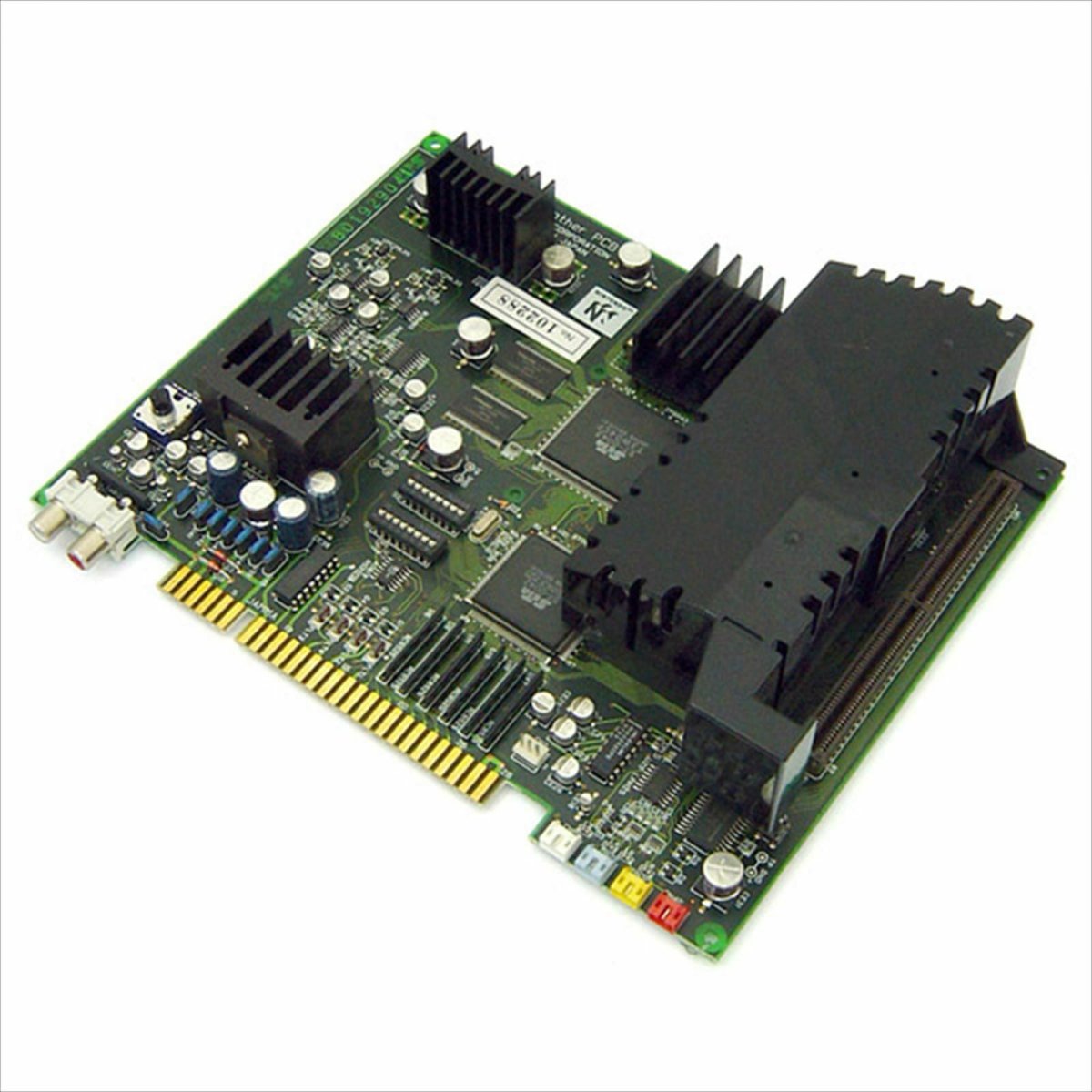

For those that Don't know the Seta Aleck 64 hardware is essentially just an arcade version of the Nintendo 64 console. In-fact the games will just run without modification so long as the cartridge pins are wired up correctly I first proposed this here: https://www.arcade-projects.com/threads/n64-carts-on-seta-aleck64-hardware.12153/
and it was further proven by AMS here: https://www.arcade-projects.com/threads/seta-aleck-jamma-board-to-nintendo-64.16130/

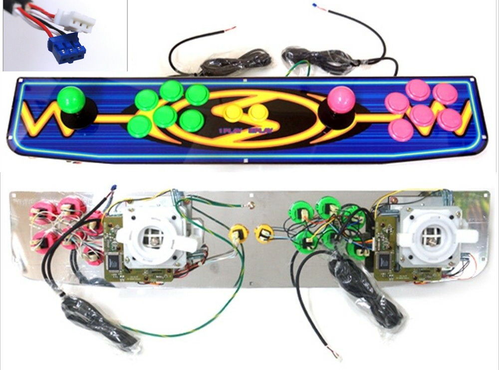

One thing about the Aleck 64 hardware is it's designed around a special control panel.
In addition to the JAMMA adapter the mobo also has 4 connectors that while shaped different are essentially the same electrically as the N64 controller ports. (you could build controller port adapter).
the Aleck64 control panel then has a PCBs that convert that signal into the joystick and buttons. The joystick functions as BOTH an analog stick AND a normal 8-way and the 6 buttons plus start are all wired to the PCB on the control panel as opposed to the JAMMA edge.
While this is required for some (but not all ) Aleck64 games, it would be required for ALL N64 games that would be used by an adapter. Also given that an N64 has some games that would require the analog stick and D-pad be used independently and has an L, R, and Z buttons that would not be mapped to the 6-buttons on the control panel, it not only requires you have a special control panel to go with your Aleck64 hardware but also limits what N64 games would be playable with this setup.

To be clear I'm not making or selling control panels. Only pointing out that if you were to buy such an adapter you would NEED to find and use the original Aleck64 control panels.

For other info, You can hook your n64 controller direct to the aleck if you take a n64 cable extender and cut of 1 end and connect it to the 3 wire plug on the system .

so I've talked to someone who used the Aleck64 panels with an N64 for a game that needed L/R/Z and supposedly they have pads for those buttons there and it was mostly a matter of remapping the panel buttons to use them. Obviously not the best solution for a wide variety of games, but an option if there are specific ones you want the setup for.

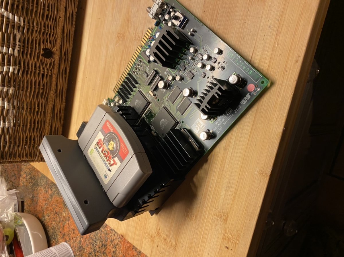

Shipped some off to @twistedsymphony and @TheDeath earlier today :)
Adapter plugs into Aleck64 mobo, insert N64 cart with label facing up, that's it. Edge connector is gold plated and beveled for easy insertion.
$50 + shipping
I have 3 left right now. Got lots of pcbs, but waiting on more cartridge connectors which should be here before the end of the month. Send me a pm if you want one!
