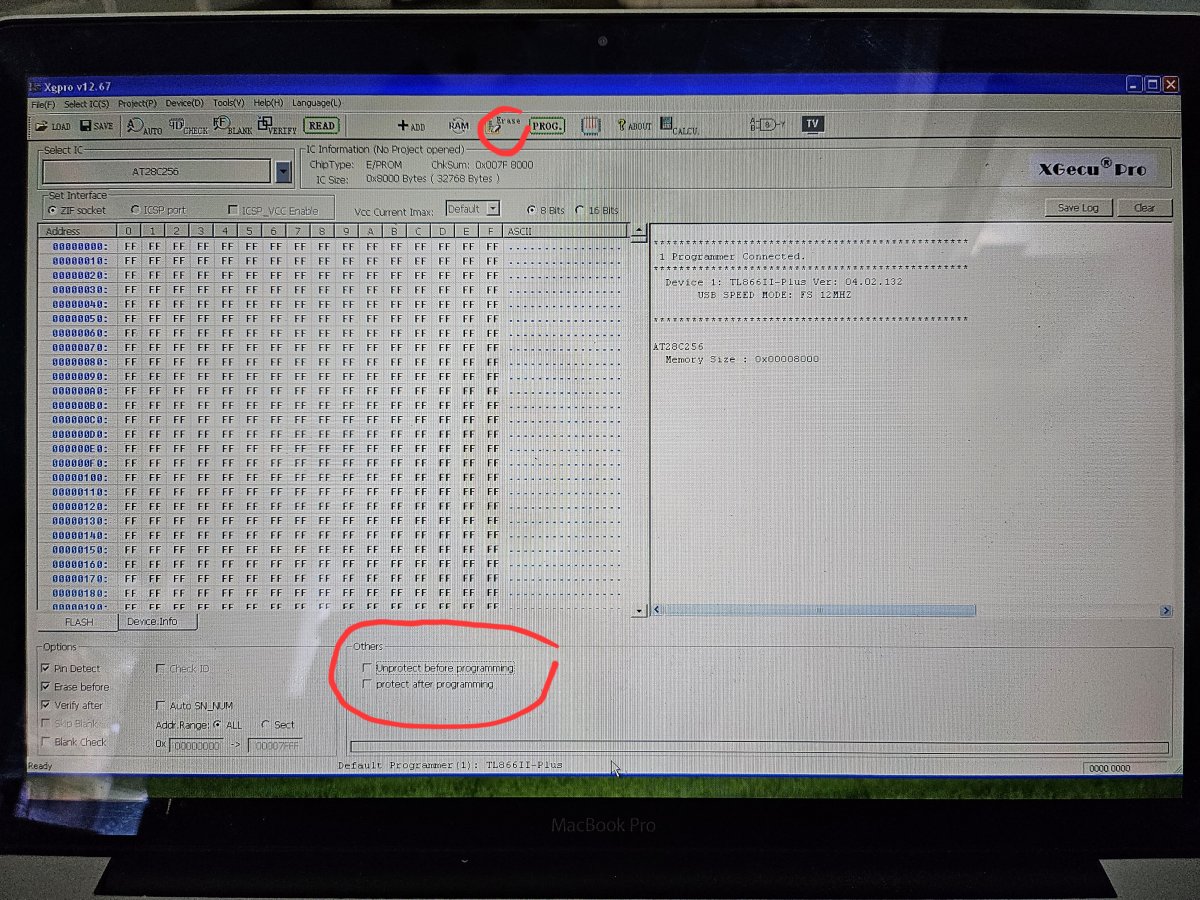

DIP SW 4 CONTROLS THE NV RAM BANK SO YOU HAVE 2 'SAVE' SLOTS FOR EACH GAME
BY DEFAULT THE MULTI IS LOADED FOR ALL GAMES SWITCHED TO 2 OR 4 PLAYER ON SW 4.
HI SCORES CAN EASILY BE EXCHANGED WITH OTHER USERS BY COPYING THE RAM DUMP
WHEN READ / WRITE THE NVROM IN PROGRAMMER MAKE SURE THE DEVICE IS NOT LOCKED WHEN FINISHED.
THE 3 JUMPERS CONTROL RAM ACCESS GIVING THE BOARD FULL ACCESS TO THE RAM FOR DEVELOPMENT PURPOSES.

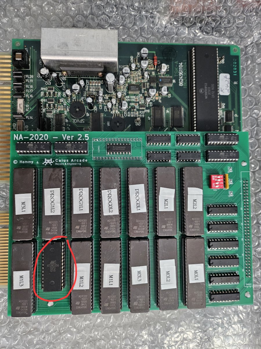

For more support cut the 'tit' off the missing peg so it's flat, there's too many via's for a hole
Knuckle heads has a good test mode on start to verify your romset is in the correct sockets, use this after burning to check.
Cosmo gang only uses lowest program bank and will run with just the prog 0 roms installed for quick h/w test.
A 27c160 can be used in spot M2 L2 as sub for 27c322.
A atmel 28c16 can be used as a (smaller) substitute for the ram. (dip sw4 becomes unused)
When running 28c16 PIN 24 needs to be removed from socket and tied to +5v. (ram goes into back of socket - pin 1 = empty)
