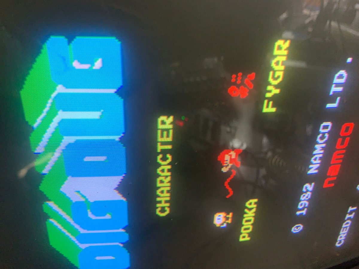

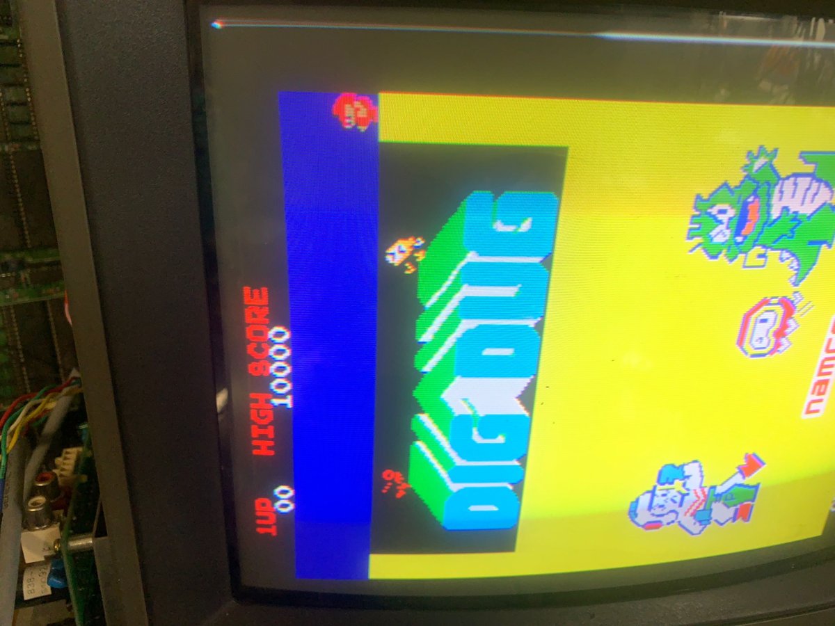

hello maybe someone can help me have a problem with dig dug and the colors have set pictures
where should I start is the problem on the video board custom chips pins are clean and look good

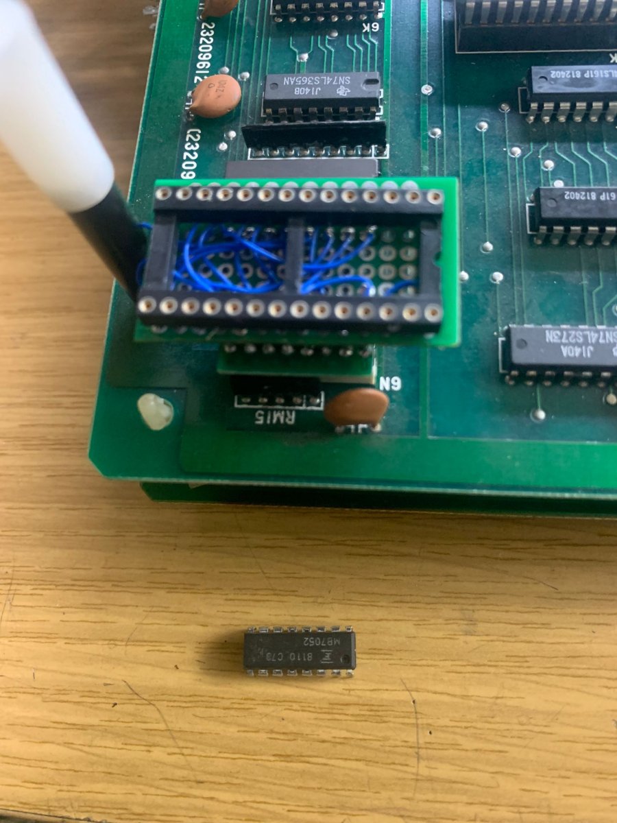

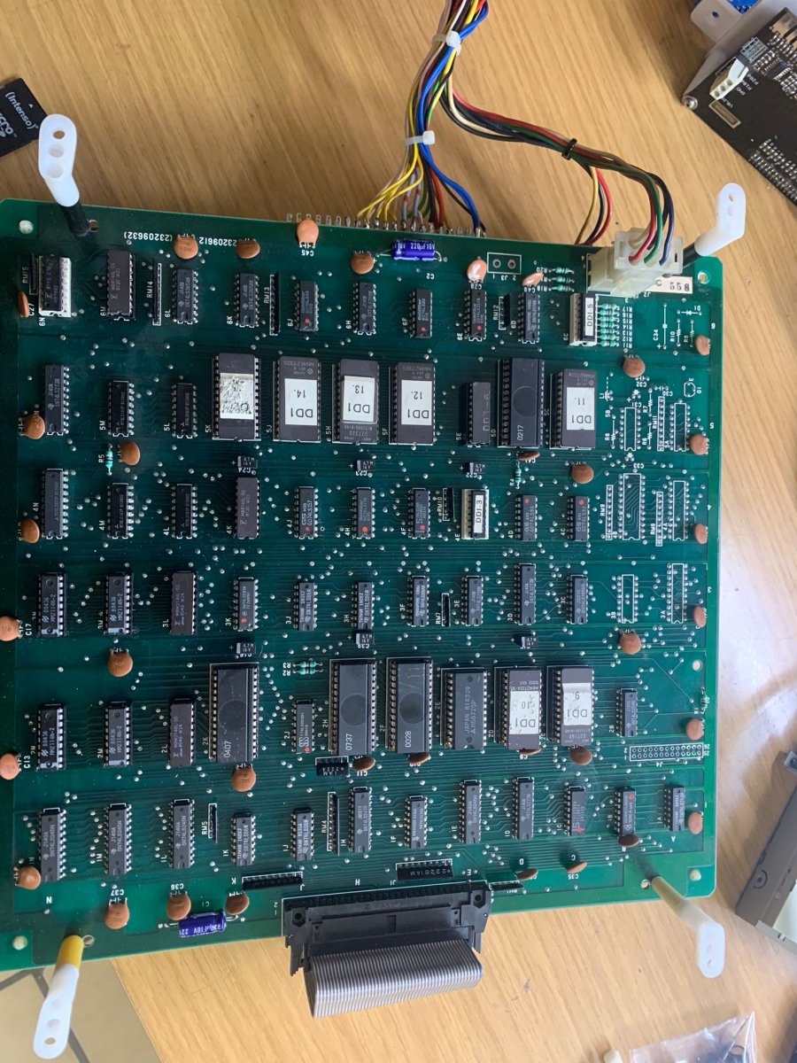

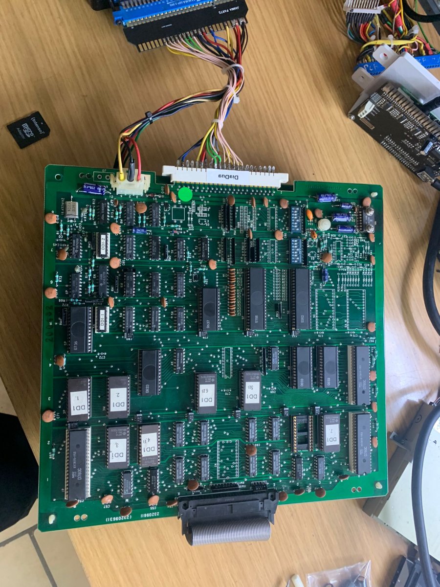

check the chips at 5A-5D, i think they are 4k roms
hello there are no roms?

damn,
thats a Namco board - i thought you had the Atari one.
i'll have to try and find the other schematics
that was what i wanted you to test, but i didnt know the part number - the schematics are shit and only have the atari/namco number!
256x4? is it tri-state or open-collector?
