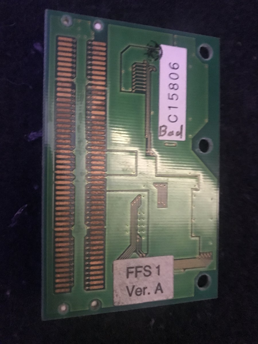

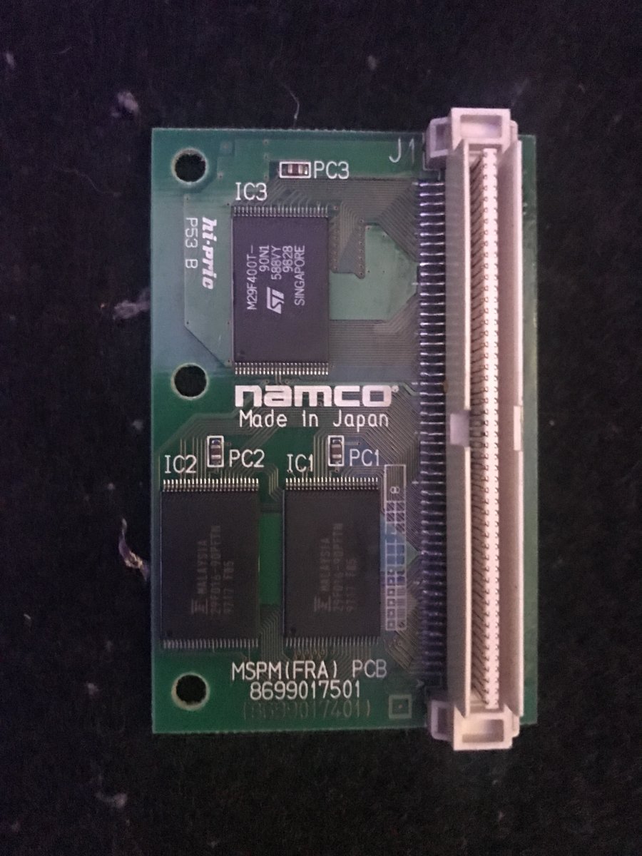

Working on a Final Furlong 2 which has two horses and monitors. One game board stopped booting and it has been determined that a faulty MSPM daughtercard that plugs in one of the main boards is causing the issue. If the good MSPM daughtercard is swapped then the other board becomes fully working.
So, looking specifically for one MSPM daughtercard for Final Furlong 2 or whole PCB if you have one available or know where one may be purchased.
It is Namco Super System 23 hardware, thanks.
It's just flash memory. I would try reflowing the chips, and if that doesn't help, then try dumping them to see if there's a faulty one.
Thanks for the response, I’ll see if I might examine the traces closer and reflow solder. I’d like to get a hot air or rework station for these smaller surface mounted chips, or have someone reflow it.
