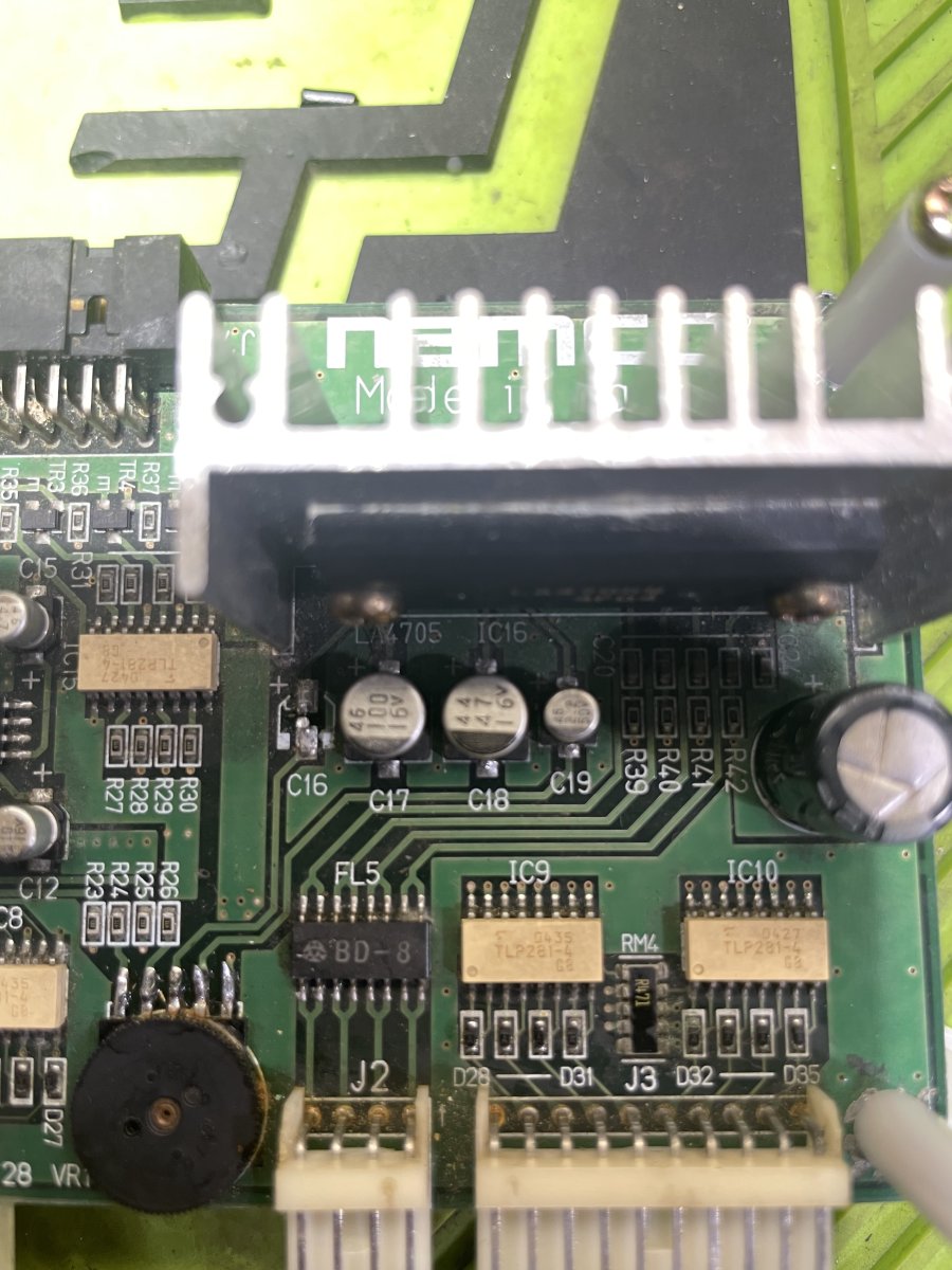

D d7onr8 Student Joined Sep 25, 2016 Messages 46 Reaction score 16 Mar 17, 2024 #1 Lost one sound channel on my System 2X6. Replaced the 4 SMD capacitors near the LA sound amp chip (heatsinked). Values are as follows: C16 & C19 - 2.2uF, C17 - 100uF, C18 - 47uF. Attachments IMG_3291.jpeg 177.6 KB · Views: 64
