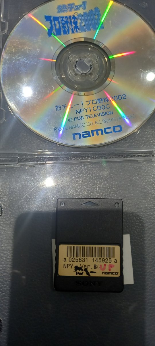

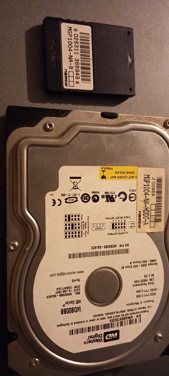

@Mickysmoke I am looking at your dumps to see which ones should be added to MAME.
The MotoGp dump is already in MAME.
How was the NPYVERC.iso created ? It looks like it contains the RB_ARC files ?
@rtw Hello mate iv been meaning to redo the NPYVERC Disc
I was talking to The Guru a few weeks ago and he told me the proper method how to do it for MAME, Just been working crazy long hours at the mo
Im off work tomorrow so will sort this out first thing
