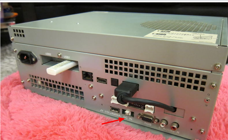

I recently bought a Namco System 357B with Tekken and I need some advice.
I connect the HDMI output to a monitor, and the power supply.
The systems seems to boot, show the playstation dashboard and load tekken dongle. But I got a black screen and after a few seconds the systems restarts.
Must the +5DC in front panel connector be connected? Can I connect a simple USB charger with the correct connector to the front panel DC in ?
Does someone know's this connector name? So I can find it on any electronic suplier.

Yeah, connect the 5v to that plug as the game looks for the I/O, if you don’t, it will just constantly boot loop
Can you tell me which is the positive and which one the negative pole?
I'm still seeking for a connector cable
