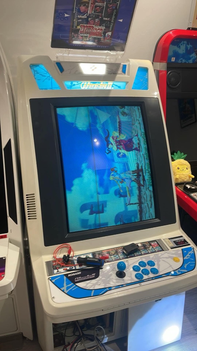

Let's see some pics of that cab back up and running in full glory!!
Not a great pic !! Calibration is way off ! (focus , Colors , etc) my friend @Mrhide will help me for final calibration
