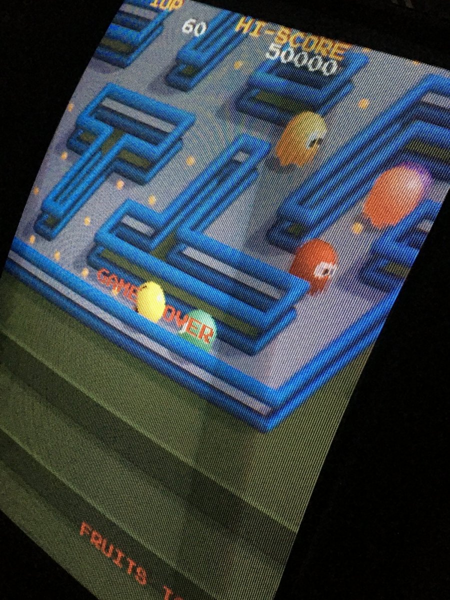

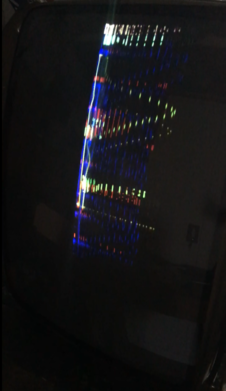

Hi guys, I'm having some weird issues with the Nanao MS8-26 monitor from one of my two Sega Aero City cabinets, they were brought kind of "as-is" so I don't know its previous background or have any warranty, just to put things a bit in context, what I can tell is:
-When I got the cabinet home just some days ago it was working just fine as it should.
-3 Days after (where I used it 1 hour max in total), the monitor didn't want to turn on!, when turning on the machine sound from the game came out but no image or anything in the screen, not even the usual hi-pitched sound CRTs produce when on.
-But the day after that it did power on! just doing a weird thing the first 30seconds after turning it on (would like to know if there is a proper name for it), and then works kind of okay. That is how it currently works
Video about weird thing it does: https://imgur.com/a/MxNGJnF
Just when I stopped recording, the image from the monitor stopped rolling.
Screenshot of that video (Ignore the ceiling reflection):
Does anybody know what is the name of the rolling image with lines issue? And why it does self correct 30 secs after power on?
Also what should I do if the monitor tomorrow decides not to turn on just like yesterday?
Appreciate any input about this, thank you!

You have a vertically rolling picture with foldover.

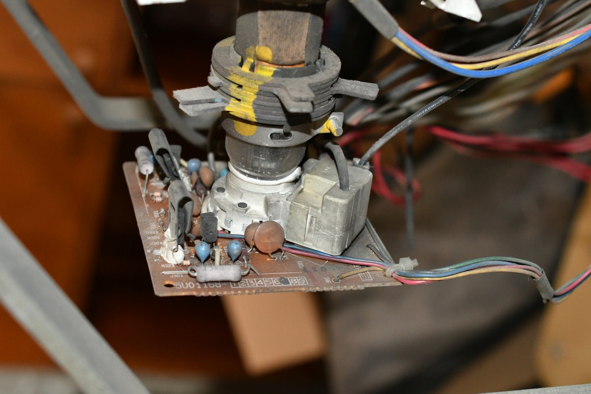

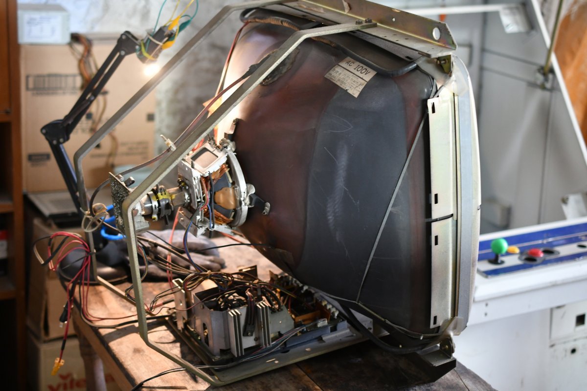

Thank you for the advice nem!, it is a MS8-26SG, I will replace its capacitors then, but before I order just that, I want to inspect its PCBs well to see if I can spot another component to be replaced and add it to the order that takes some time to come,..
But, I chose not to start the "monitor inspection round" with that one, it was more convenient to first take off the monitor of the other cabinet I have that is an aero city with a Nanao MS8-26SG too, it's working pretty well, but I understand that I should do a good cleaning and recap anyways, so I took it out and snapped some pictures attached to share and to ask some questions too..

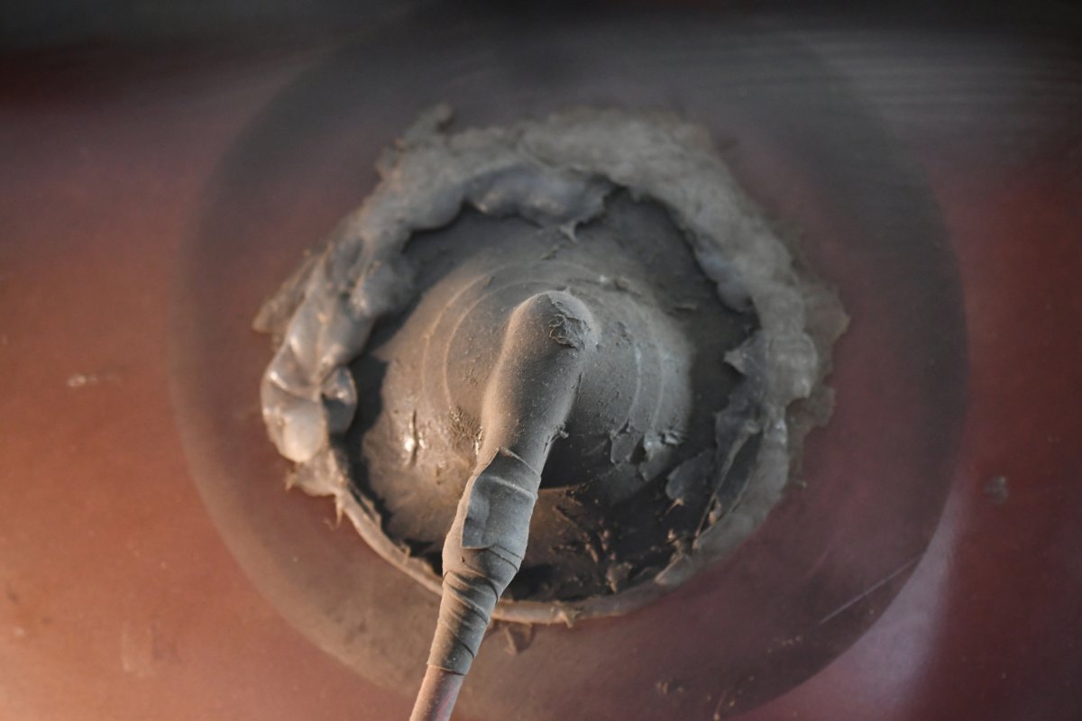

Q1. I see the suction cup has silicone around it, when I get to discharge the tube and stick the cup off, I suppose I should remove the silicone because is something not normal is it? and what should I use to stick it back when I put the cup back on the tube?
Q2. Comparing this monitor with the other same-model one, I see this one has much less black coating than the other one (side pic), is the lack of black paint bad for the monitor? Is this the aquadag? Should I buy some and paint it?

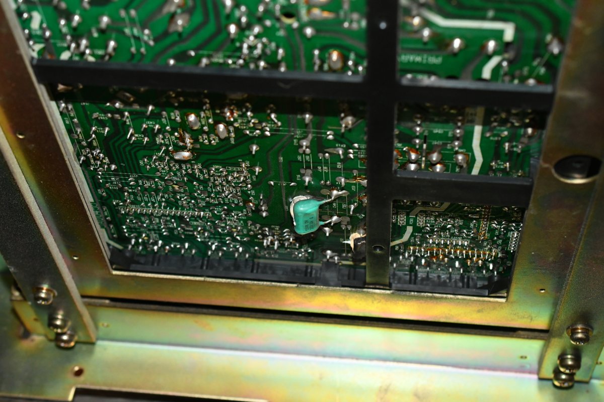

Your chassis looks good to me! Replace the electrolytic caps and go over the solder joints. For instance you have cracked joints on the neck connector on the neck board. Look for similar ones on the chassis.
The silicone is there to make a better seal around the anode cap and the glass around the anode. It's there to stop the anode from arcing. However, unless you have your cab in a really humid environment, I don't feel it is needed. I just clean the old silicone off. Make sure the anode hole doesn't have any debris in it. You can blow it out with compressed air.
Different tubes have different areas covered with aquadag coating. The one that has less coating is perfectly fine. It came like that from the factory. As long as the dag wire (the braided ground wire) is making contact with it, it's going to be fine.

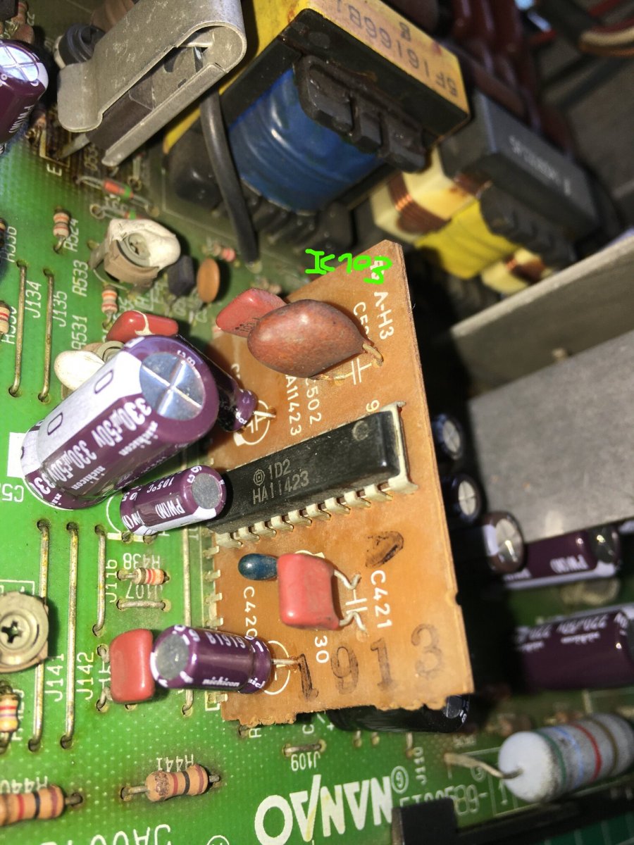

Hi nem! Thanks for sharing your knowledge, I finally gave the monitor some service:
-Disconnected and cleaned it all with with compressed air and a brush (no washing)
-Recapped the board and neck board with the kit from arcadepartsandrepair, all capacitors matched fine and some new were with greater voltage so, good.
-Took out the solder (with solder sucker) from those cracked joints from the neck board connector and soldered them nicely with new solder
-Found some other cold joints around from transistors or wires soldered to the board, did the process with those too
Seemed like there was nothing left to do so I connected all to the tube back again, and put the monitor over a table next to the cabinet for testing before inserting the monitor inside it.
Turned it on, and found it was sharper than before!, colors were all weird but looked like a magnetization issue, nothing that a demag can't fix, but before that, I started adjusting the screen size and position, and just after it was looking kind of good, boom, a vertical collapse happened (horizontal line on screen), but not an absolute one, the line is there but it kind of vibrates sometimes.
-So I proceeded to spray some contact cleaner on the front adjustment pots (nothing happened).
-Reflow some more joints around in the pcb, including the front adjustment pots (nothing happened).
-Start poking around with a wooden sushi stick (nothing happened), but when I poked to the IC "HA11423" at the named "IC103" small board, something seemed to happen, not sure, but it looked like the image vibrated a lot more, and for one moment one single frame could be seen.
Also, followed the troubleshooting guide of the service manual (MS8-26SU but same for this MS8-26SG) that recommends checking the voltage that the "IC103" small board receives at its pin #4, it says it has to be 10V but got 10.75V, I am not sure if that is wrong?
Also, if voltage is 10V it says to measure pin #7 from the IC103, you should get kind of a square wave from 0 to 2.3v, measured that with my small scope and found nothing, no wave at all, just a constant 0.7v when on.

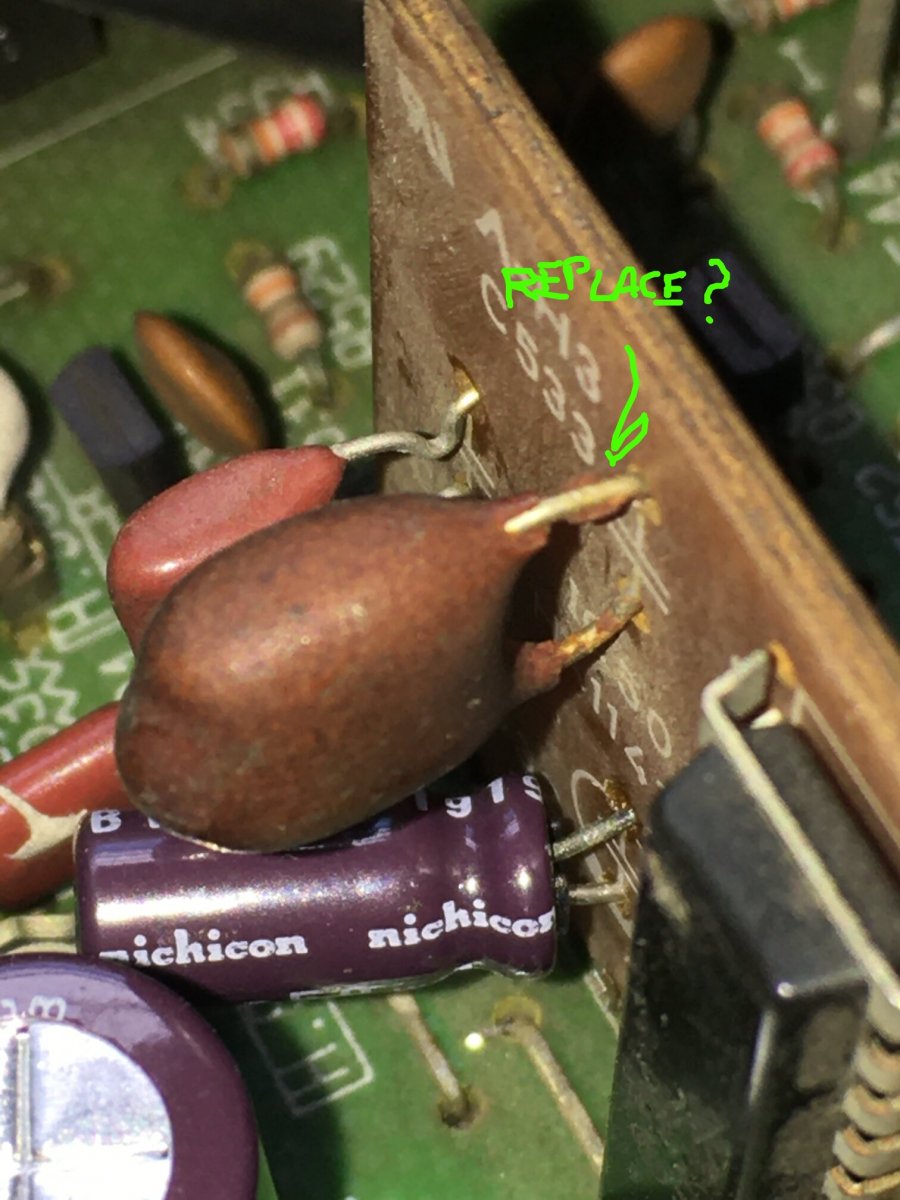

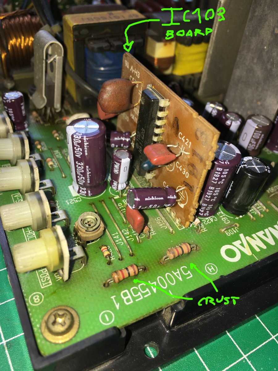

So, I'm kind of lost because I am not sure what is the priority, it could be:
-Reflowing everything I see on the pcb just because.
-Finding a replacement "HA11423" and replacing it on its "IC103" board, why should it be broke though?

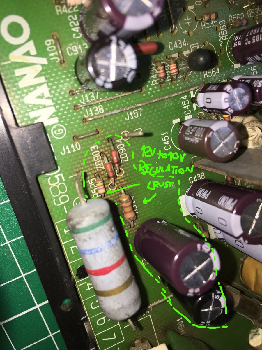

-Replacing every crusty resistor or solid capacitor I see on the board just because? check attached pic.
But the thing that most messes with my head is why had this to happen when I only replaced the capacitors? and why was it working fine for 2minutes??
Thanks to anybody who reads this, and appreciate any input

You got a full sized frame when poking the small PCB? Sounds to me like you have a poor solder joint still somewhere there. Check the joints on the bottom of the small PCB too. You can have a lifted pad too that can be hard to spot.
The resistors and poly caps look fine to me.
Maybe the frame wasn't that full sized.., couldn't find any other cold joints, so I took the small PCB out, took out its caps and measured them, and they were fine, soldered the small board back in and got the same issue.
Also I reflowed all pots.
Now I'm thinking about replacing the HA11423 how often do they fail?, if you want to see the issue in acton, here is a video: https://imgur.com/a/Tt8w8xf (Monitor is vertical, running pacmania)
Thanks!

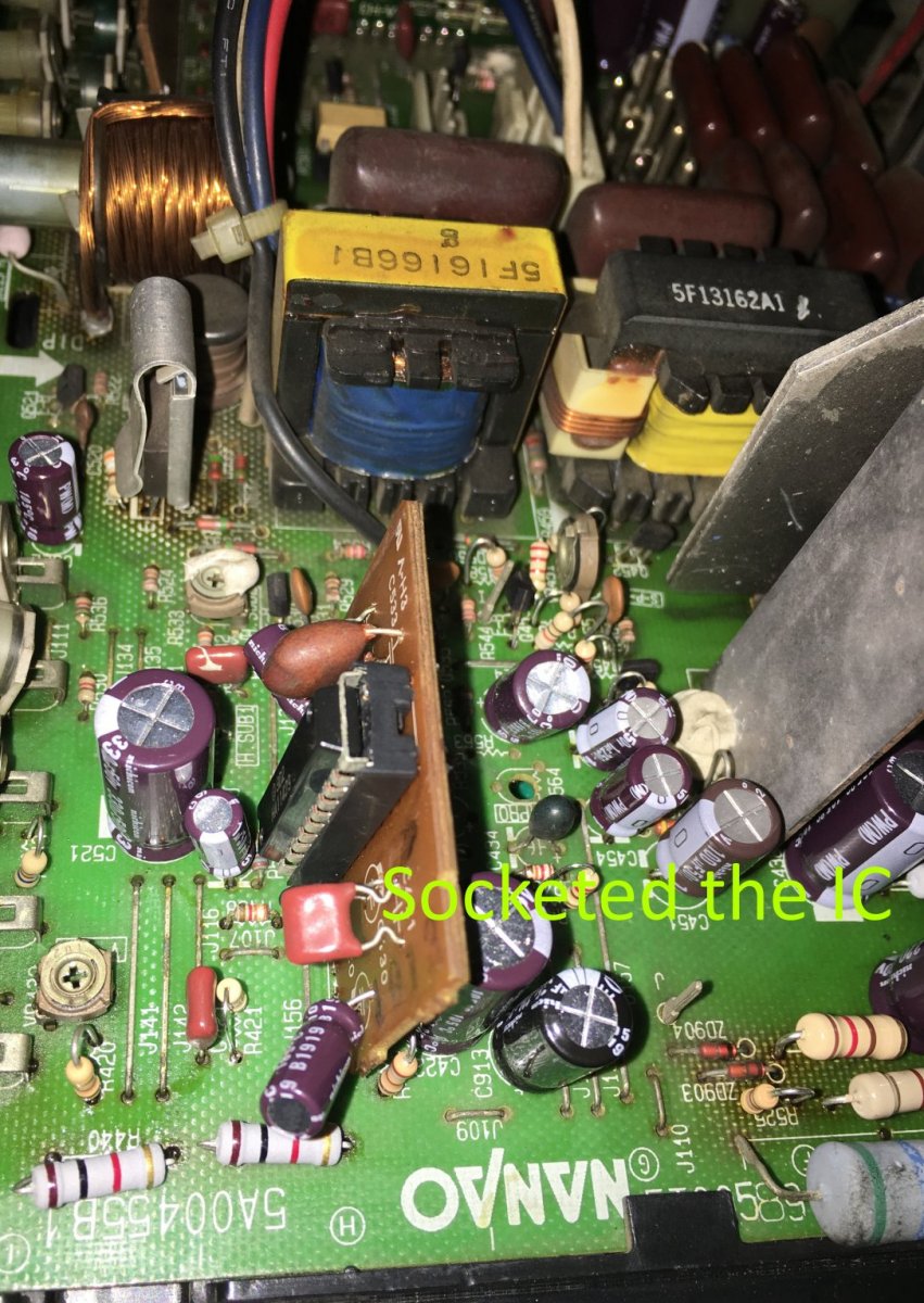

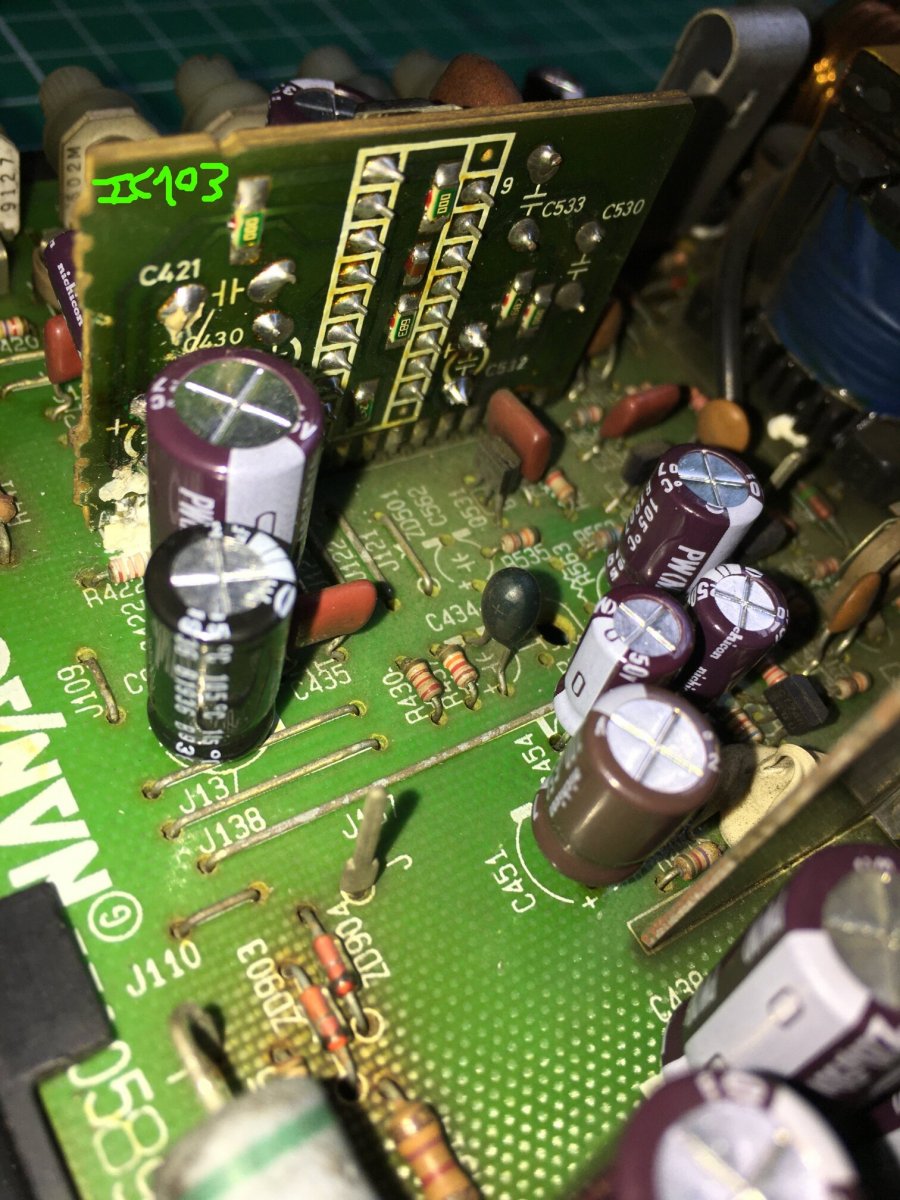

Quick update

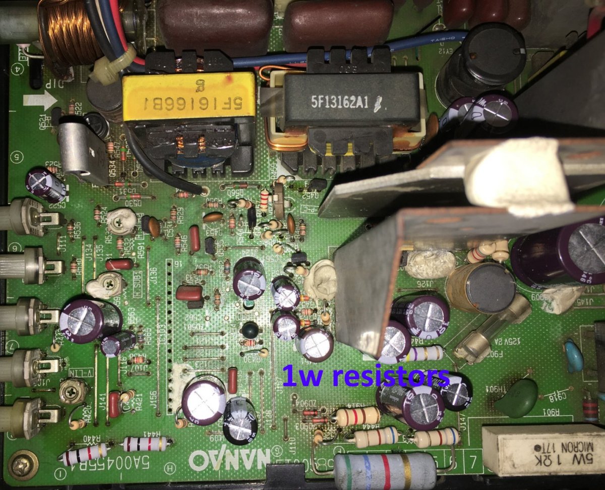

-I've been taking out lots of resistors from the vertical oscillation circuit, also some power resistors that seemed to work hot, and replacing them with bigger wattage versions (1/2w replace with 1w).
-Also managed to source a HA11423 IC locally, took out the original IC, soldered a dip socket just in case and put the new one in there.

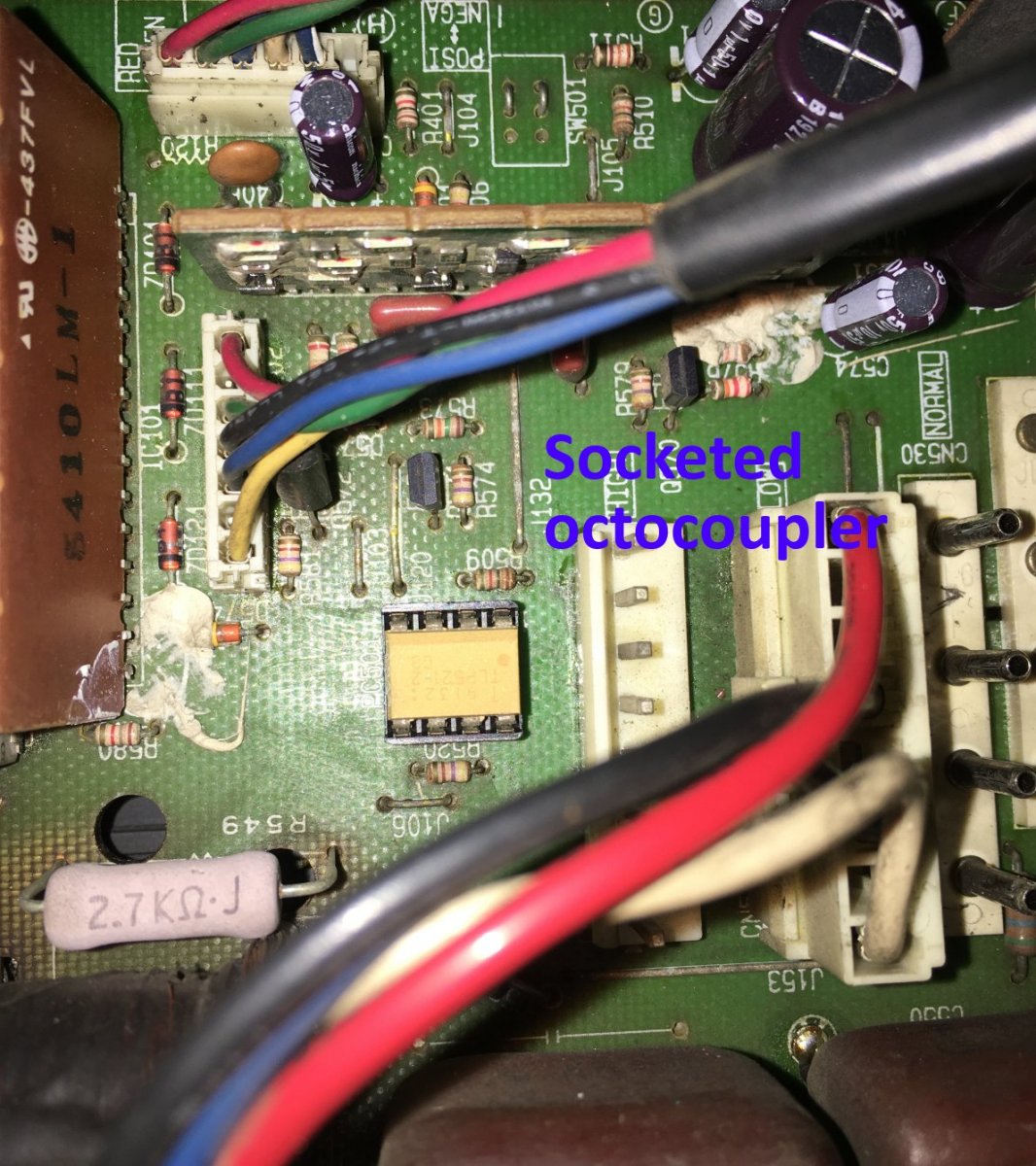

-Desoldered and measured the TLP521-2 (octocoupler), seems to work fine, anyways put a socket too and put it back in
-Desoldered and measured Q451 Q452 Q453 and Q534, all nice
-Cleaned some trimpots from inside like the V-LIN and S.P.C (side pincushion correction), the S.P.C. was giving like 1.3kohm resistance between some pins but after contact-cleaning and wiggling it now it gives 178ohm, like it should.
After all this work, connected everything back in and, it still works exactly the same, could've been worse because after unsoldering and soldering some pads lifted and had to jump them, but, that, it's still the same.
Now I'm starting to think about measuring the input oscillation signal from where it originates and find where it dissapears(? I've got this cheap oscilloscope that can be useful, but I'm a little worried about connecting it to a high voltage point and frying it

Sorry for delay, you should replace the two D1138 even if they test aparently good, also when work on ms8 26 pay attention when you are on vertical deflection area because it will be all the way cooked and all traces so fragile
Thanks, in the end the problem was at the vertical deflection area indeed, but wasn't those transistors, the part which was causing all this issue was ZD431 (24v 0.5w zener), the one next to r430 at pin#7 of the IC103. It didn't seem physically faulty, but after taking it out (random components measuring), measuring with a multimeter gave around 300ohm resistance between its legs on both ways! that's very bad. Replaced it, and got a perfect vertical deflection going on, it now works as it should, with no weird vibrations or anything. :thumbsup:
