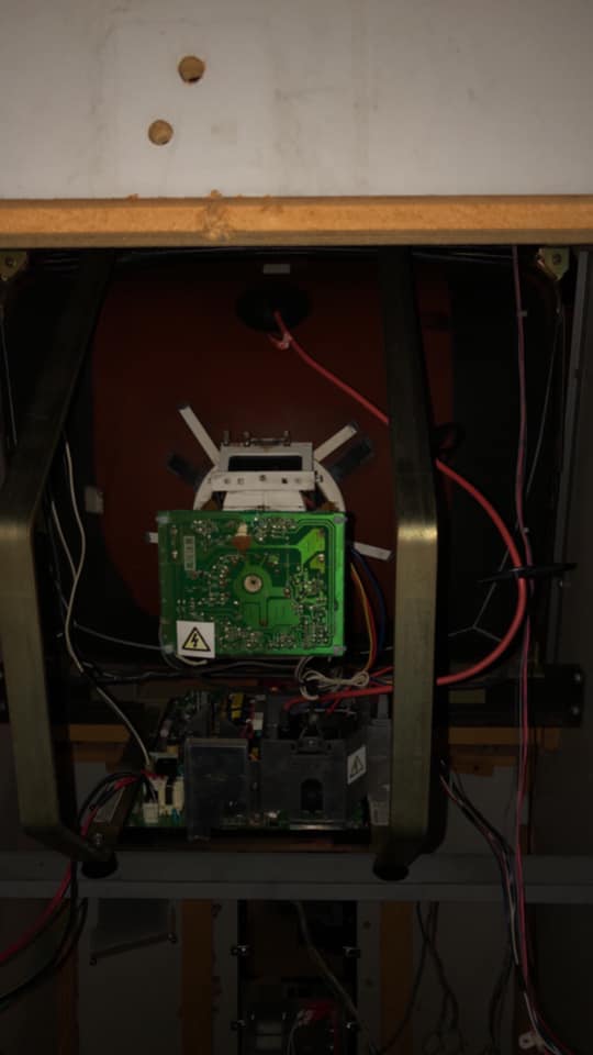

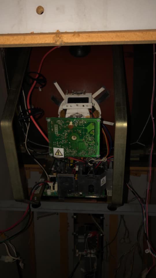

I'm experiencing a slight issue with my monitor, which is from a Virtua Fighter 1 cab.

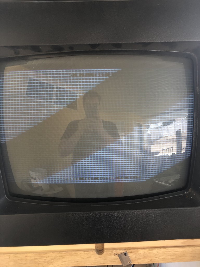

There is significant folding at the top of the monitor.
Vertical adjusted to the point where there is no longer any folding, it seems that I lose a good portion of displayed game space, with black bars on the top and bottom (no horizontal adjustment has been made).
I plan to recap this anyway, but would recapping fix this?
Also, I am unsure how to pull the PCB out. It appears to have two screw holding it in and then slides out of a holder, but some of the parts appear to be directly soldered to the CRT tube, so the PCB can not be removed without removing the entire CRT bracket housing and tube with it.
Any advice?
Recapping will fix the vertical foldover.
Everything should unplug, nothing is soldered. From the cab you have to disconnect the power and video input connectors and the connector for the demag button. From the monitor you have to remove the anode (remember to discharge properly, as not all MS8-26 are auto-discharging), the yoke connector, the ground connector from the neck board and the demag coil.
However, personally I would just pull out the whole monitor. It's honestly quicker that way. Remove the four M10 nuts, disconnect power, video and demag connectors and pull it out.

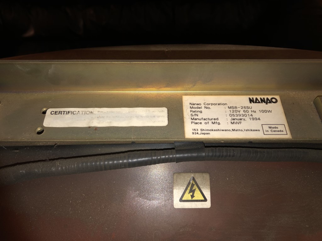

I finally got the monitor out to identify it properly and it must have self-discharged (RIP $30 in gloves and alligator clips). Cleaning off the sticker revealed that the certification sticker’s ink wipes right off... I am bad at this refurbishing thing... Anyway, I bought a new cap kit and flyback converter here

The sticker says:
CERTIFICATION: Product complies with applicable DHHS standards under the radiation control for health and safety act of 1968. 05D064441

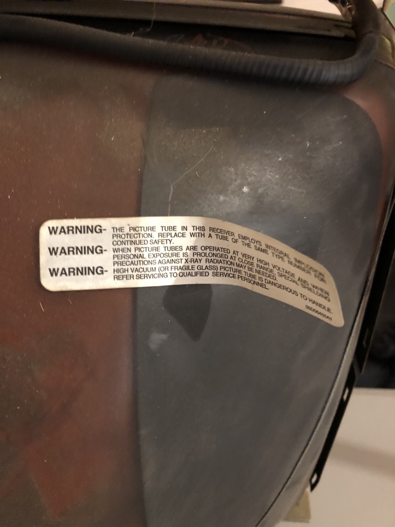

Alright, so, the entire board is recapped. I cleaned the hell out of this monitor. Like, there was a tube that I thought was solid black on it, but turned out to be part of the glass that I could see through. While I didn't degrime it 100% because it might damage it more than it would help it, the monitor is back together and I will be testing it this morning.

Parts of the tube that you think are dirty might be a layer of aquadag. You don't want to remove that unless you want a light show every time you turn your monitor on.
Oh my. In my ignorance I may have apparently, royally, fucked myself... see below...

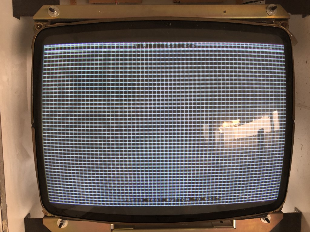

Well, this is what I get now. Am I screwed? FIXED BY MOVING THE FLYBACK TRANSFORMER WIRE AWAY FROM OTHER WIRES/COMPONENTS

I really can't say that this part of the CRT had aquadag on it. It all smelt and felt like dust. Though it did turn anything I wiped on it completely black... I don't know...
The neck of the tube that connects to the board, however, did have a thick coating on it that when wiped away became clear...
Unsure if that's related to my current issue, however, as it appears that it's just noise getting into my board somehow. Most likely... ugh... a cap...
EDIT: The "Detail Adjustment" section of the manual mentions this:
Those CP magnets around the neck did alter slightly in the cleaning. Is it these that need adjustment? I'm doubting it though.

EDIT3: HAHA! DISREGARD THE NOISE!
So apparently if your flyback transformer's cable is too close to other cables, it causes the noise!
Before:
After: 74214400_10157066525641715_288517460355710976_n.jpg
