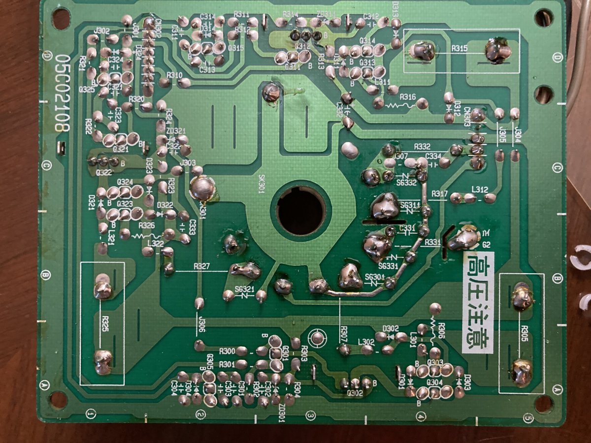

I would be extremely surprised if it's the flyback.
I had similar issues and it was down to cracked solder joints on the neck connector on the neck board. That would explain the lack of neck glow too.
It would baffle me if all it happens to be is cracked solder joints, being the fact I got it back from being serviced and the same problem returns after working for a couple days.

Easy enough to check. Take a pic of the neck board (solder side).

@nem, As soon as I get around to yanking out the MS8 and installing the MS9 I will take pics of the MS8 neck board.

@nem finally got the MS9 chassis installed today and so far it is working well. Here is a pic of the neck board from the MS8 solder side.
