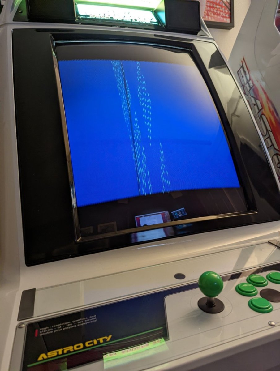

I just got a NAC. The monitor (MS8 ) worked at the seller yesterday and when it got picked it up today, every PCB I have end up with an image like this. The seller had an IGS PGM to test with and so do I. My PGM works fine in my Blast. I'm not familiar with CRTs at all.

It happened to mine as well before. Here is what I did to fix it:
- Check the V and H hold from remote board under the CP.
- Make sure the Blue-Red and Brown-Yellow wires that coming from the yoke are tightly placed on the chassis jumpers.
- Lastly, which I doubt this is the case with your monitor is to check whether the flyback cap is attached firmly to the tube or not (must be discharged first).
Good luck.

I checked the connections and the pots change the picture when I twist them. While trying to get the distortions as stable as I could, a sound emitted from the monitor and a different distorted image filled the entire screen. Twisting the v/h holds further finally stabilized the picture. I let it be on for 30-40 minutes, powered it off and then back on, I'm back to square one with the same picture as above.
This ceremony seems somewhat repeatable as the picture will "snap" in sync at a certain cross-section of v/h-hold and then I have to do the final adjustments to get the picture in place.

I can pretty repeatedly turn pots down for v/h size and hold and twist v-hold until it syncs (?) and then I can twist all pots into position until I have a perfect picture. Any ideas why it can't fully sync by its own on power up? Another sighting is that a Pandora's Box have no issues all of a sudden and comes on perfectly every time.

I doubt this is the case since when you fiddled with the holds, you did get a picture, and not only did it boot the game, but you don't appear to have any scrambled graphics either, however: have you measured your voltages at the edge & on the board while under load? If not, you should. Not the hottest idea to be testing with games you might not want to lose if you don't even know what voltage you're sending to the board.
good enough guess that you /are/ in 15khz and not med-res since you did eventually get a picture with a plain-jane jamma game, so that's not an issue.
Could very well be a cold solder joint somewhere either on the chassis or on your remote board that may need a reflow. Could just be in need of a cap kit as well; though to be honest, with the general age of these machines, a cap kit should almost always be on the "must do first" list to be considered a quality well-maintained machine. There have been cases of missing colors that have been solved by a good once-over reflow; little work that does a lot of good. I doubt it's an issue of a loose or worn cable since you're saying you can repeat the issue via adjusting the pots- a loose or half-connected cable wouldn't give you a stable image via adjusting pots, so I'm inclined to believe it's either a bad joint or a bad component (which again, it's definitely time for new caps anyways if it's never been serviced).

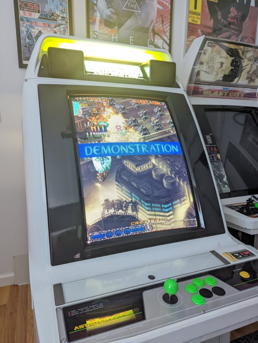

For the folks who likes closure, the seller of the cab managed to hustle a recapped MS8 chassis from his friend that I bought. The seller also offered to do the chassis swap as I'm not ready to get into this at this time. The old chassis I had an email exchange over with Sharp Image Repair and they said they can fix it. I'm going to send that in and have as backup.
