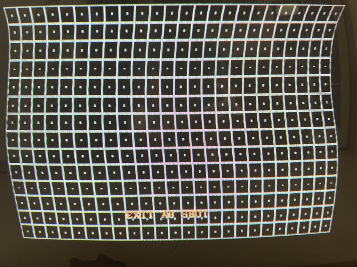

C chriszhxi Professional Joined Mar 8, 2022 Messages 214 Reaction score 87 Location HK Jul 23, 2024 #1 It was like this before recap, after recapping still the same, I checked the pots, they are good, but adjusting the pots would not help much. I then replaced Q508, still the same, any suggestions?

BuddyC Enlightened Joined Sep 17, 2018 Messages 888 Reaction score 3,003 Location Oslo, Norway Jul 23, 2024 #2 Have you measured that the B+ settings are correct?
C chriszhxi Professional Joined Mar 8, 2022 Messages 214 Reaction score 87 Location HK Jul 23, 2024 #3 BuddyC said: Have you measured that the B+ settings are correct? Click to expand... Wow, how did I miss this, measured B+ only read like 62V, adjusted it back to 75V, and it's good now! Thanks for the help!

BuddyC Enlightened Joined Sep 17, 2018 Messages 888 Reaction score 3,003 Location Oslo, Norway Jul 23, 2024 #4 Cool. The MS9 likes 76V best for the 15khz B+ setting.
