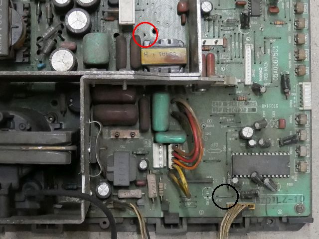

I wasn't positive where to probe to measure the B+. It looks like it has never been adjusted though as there is still glue on the adjustment pot.
You measure it from TP2. Easy enough to do with regular meter leads without killing yourself or creating short:
Red probe on red circle, black probe on black.
Voltage should be 76VDC for 15khz. If yours is over, adjust it to match and see if your issue gets better or worse.

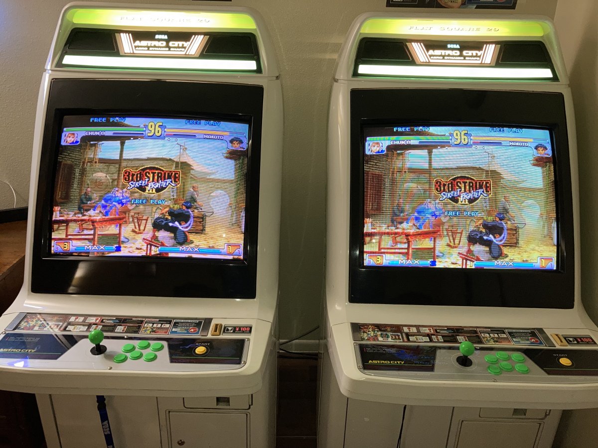

So I finally have an update from the issue we had long ago with the horizontal not filling using an MS8 yoke with the MS9 chassis. We of course got a hold of a couple MS9 yokes and did the swap on the 1p cab with the MS9 chassis. Problem solved and I couldn’t be happier. Not only that, but the display looks 10 times better than what it did before.
