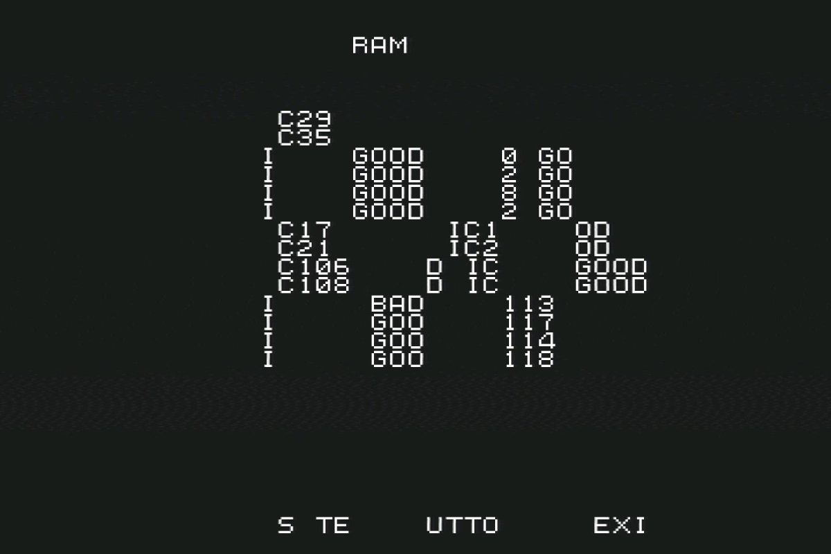

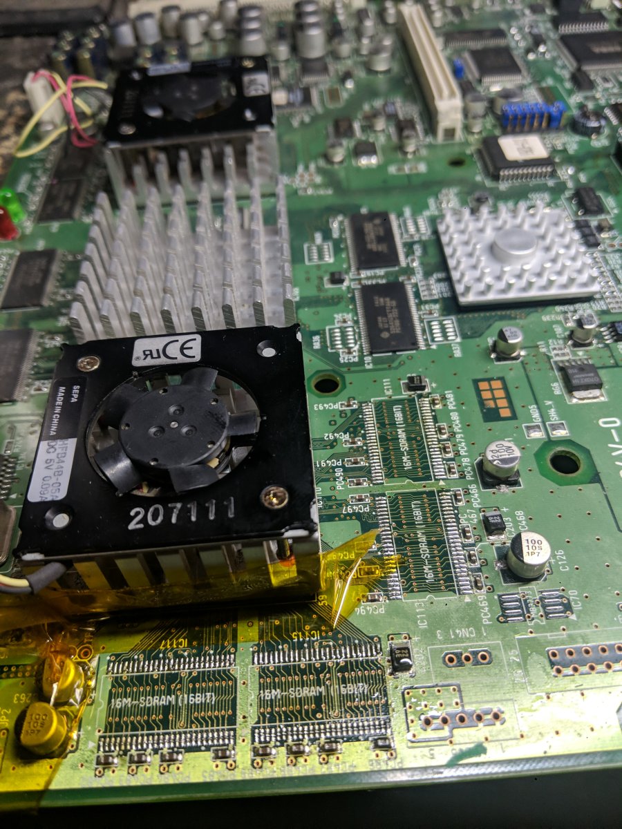

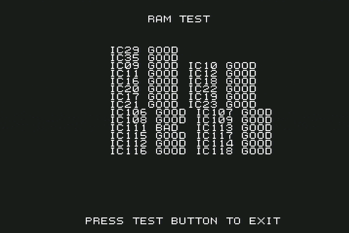

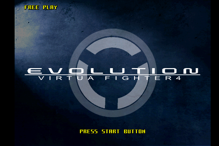

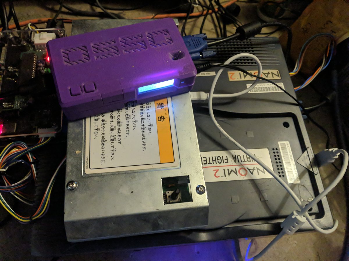

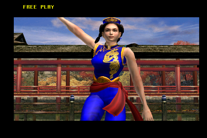

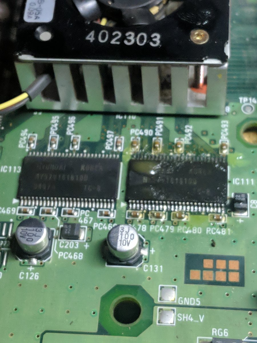

Had a friends board for hdmi install and he told me he had a checkerboard pattern, when I ran the ram test I got back a bad IC111. I had a parts board somewhere in the house I just did not remember where, last night I finally found the parts board. The parts board was a victim of bad packing during shipping like 10 years ago, one of the gpus was ripped when the heatsink came off from being thrown aroudn during shipping. Tonight I finally got a chance to harvest ram from it to use it to fix my buddies bad IC111 board.

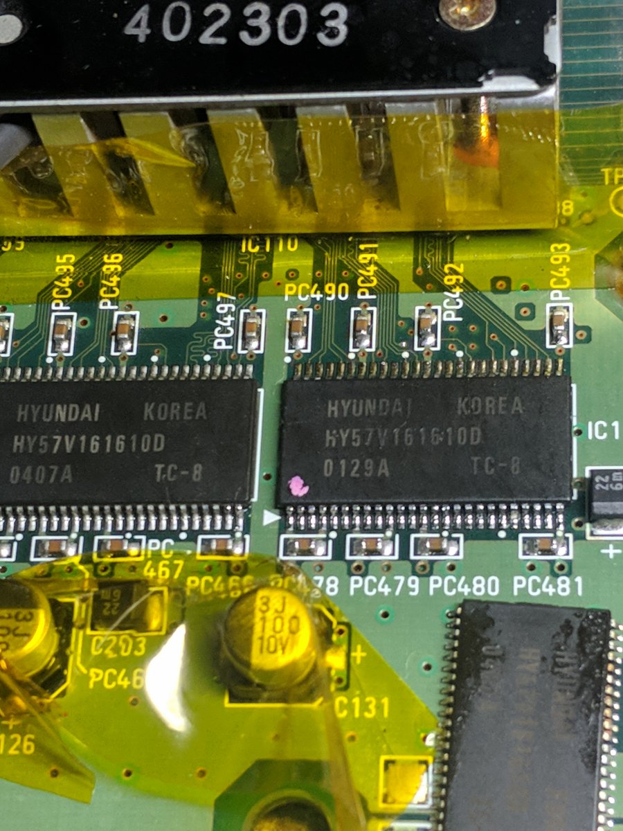

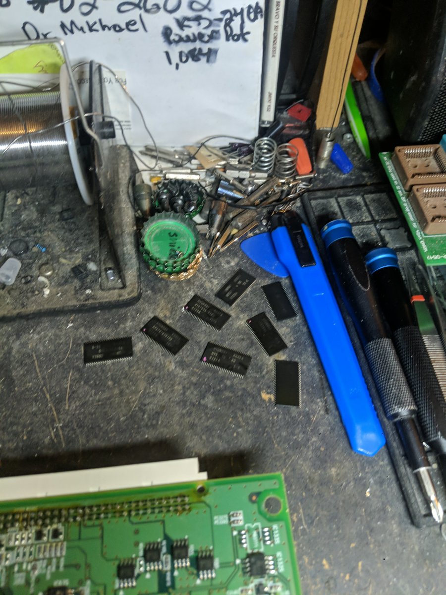

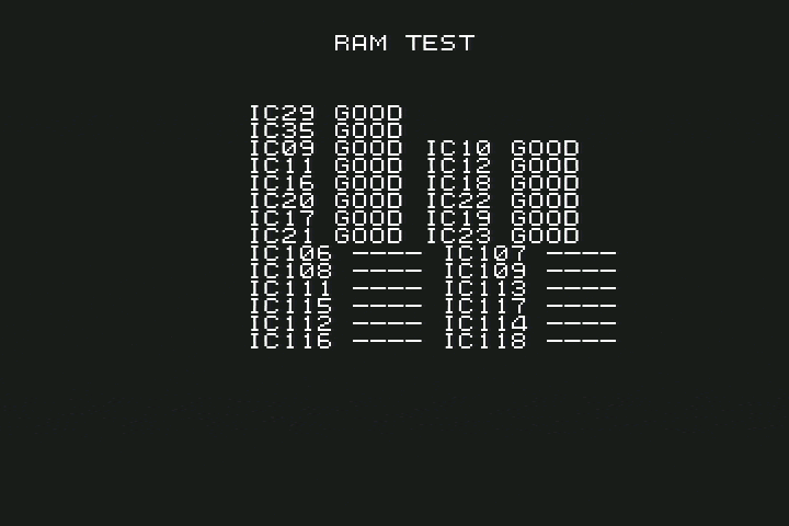

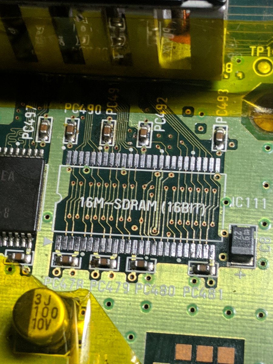

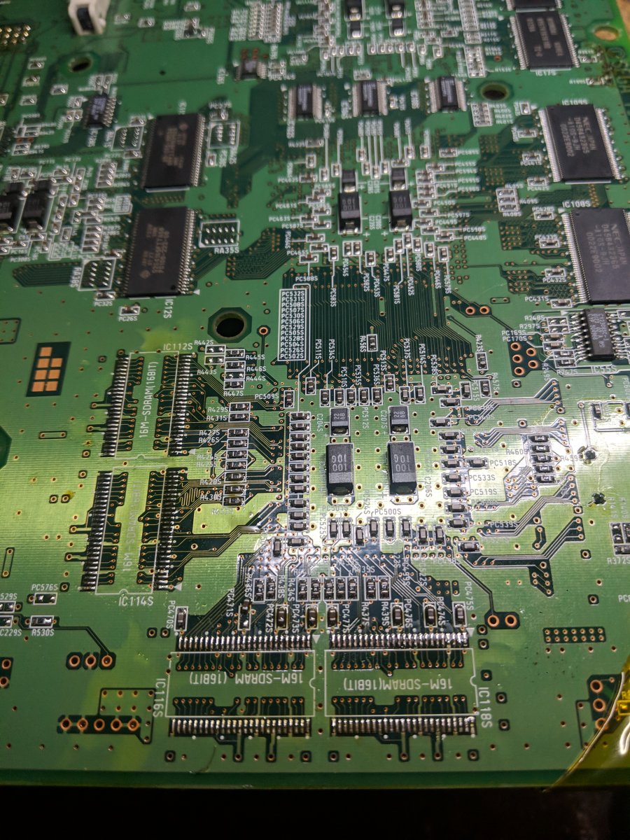

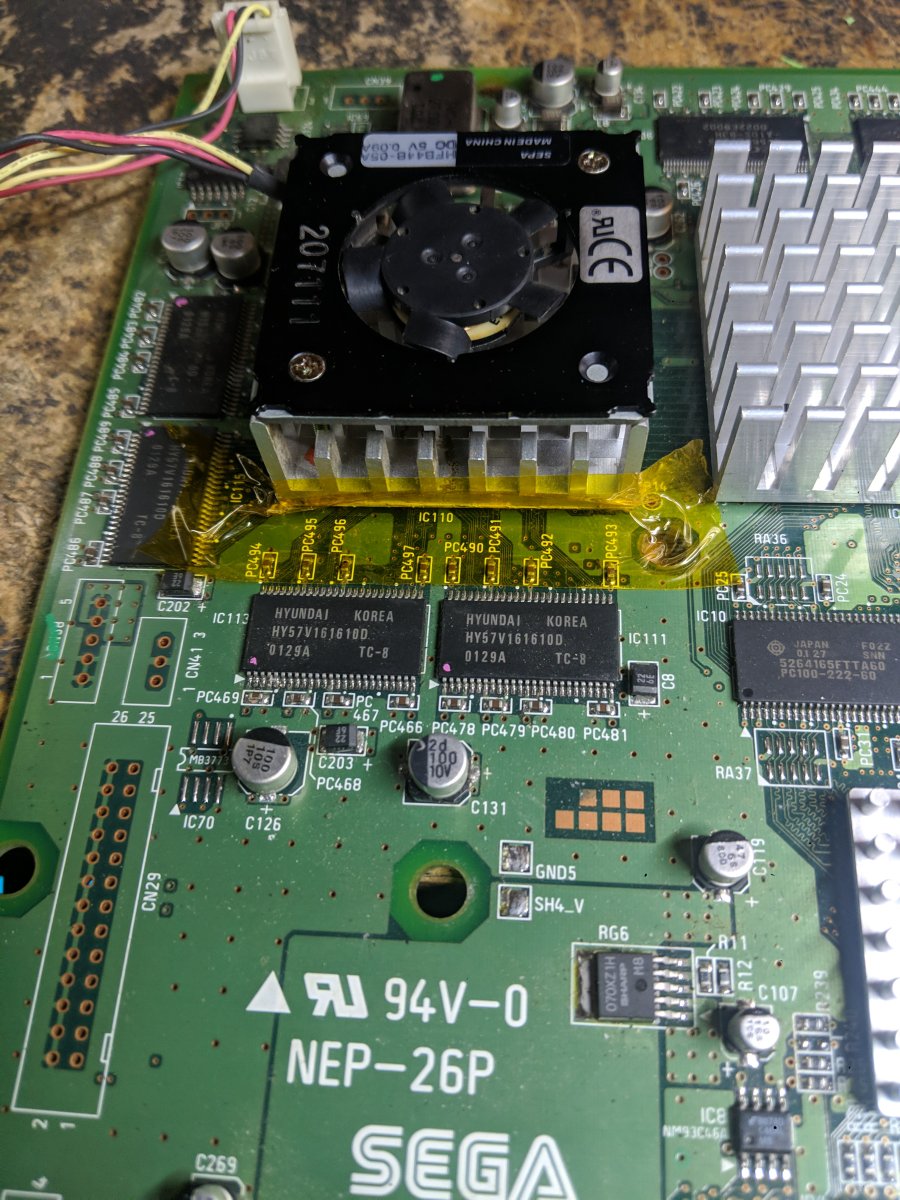

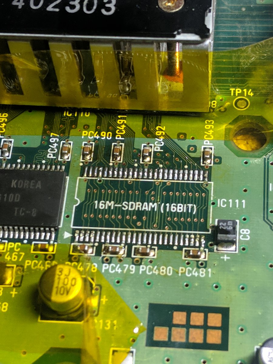

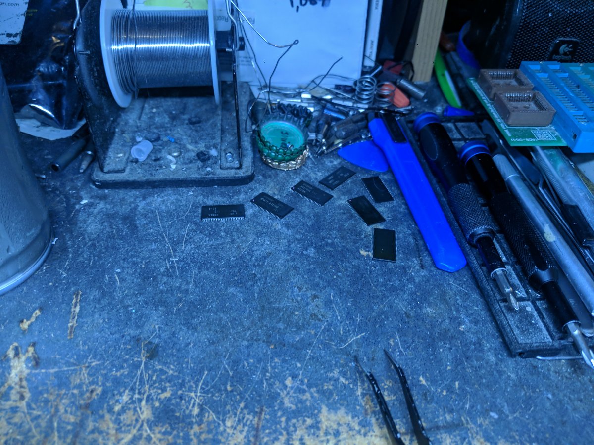

Harvesting the ram from the ripped GPU parts board. Took all 8 chips off four from the top four from bottom. Then used one to replace IC111 on my friends board.
