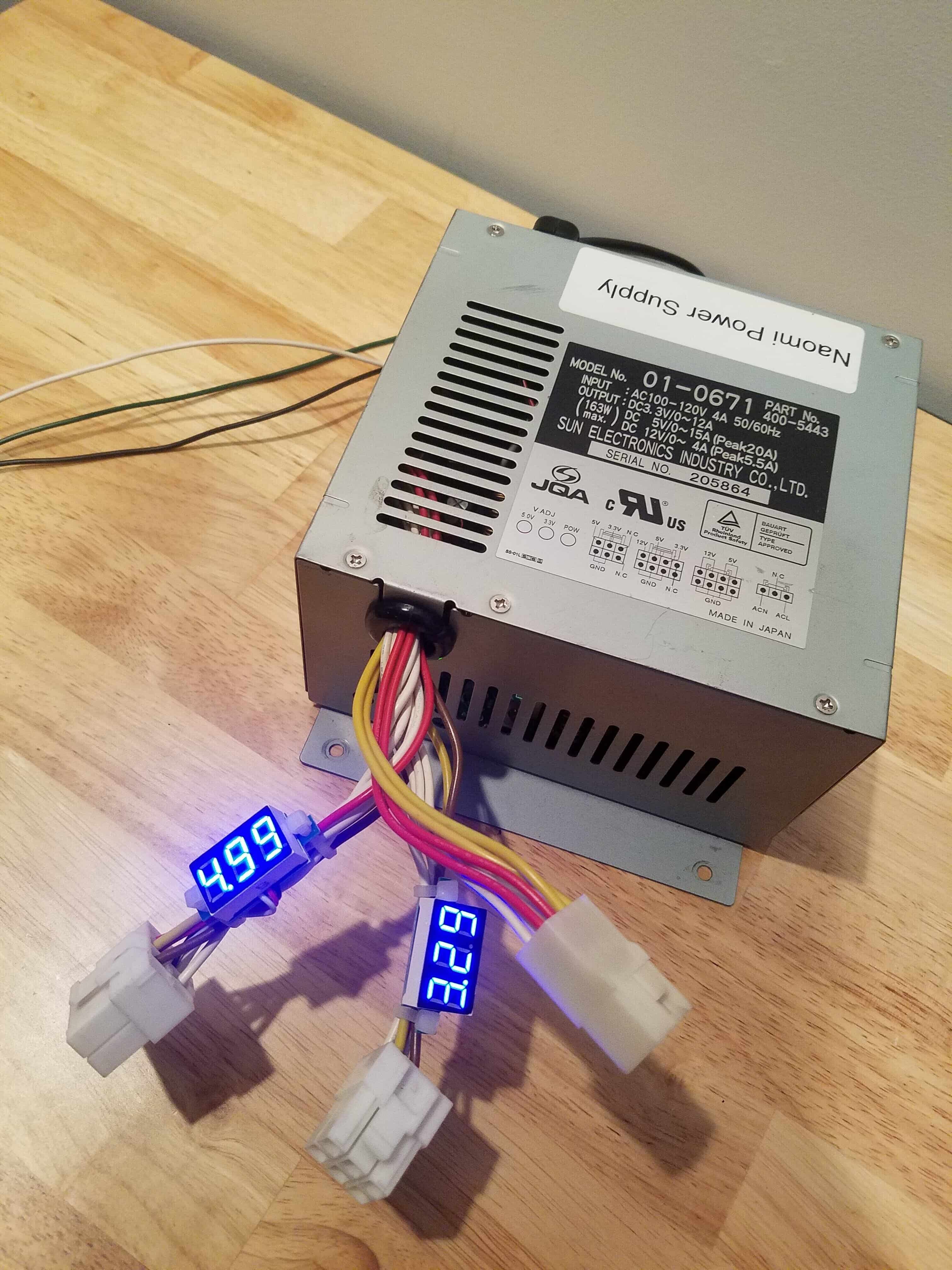

I installed small LED voltmeters onto the 5v and 3.3v pins on my sun psu and my jamma harness 5v pin and zip tied them to the wire bundle. It was awkward to check the sun psu pins while the power is on so it worked out really well.
Have not had a problem since, also, really nice to not have to use the multimeter all the time when switching games... power down, turn voltage down a little, install new board, set correct voltage.

If you take the time to install the mini voltmeters, i'm not saying it WILL fix the problem, but will eliminate future voltage frustration!
