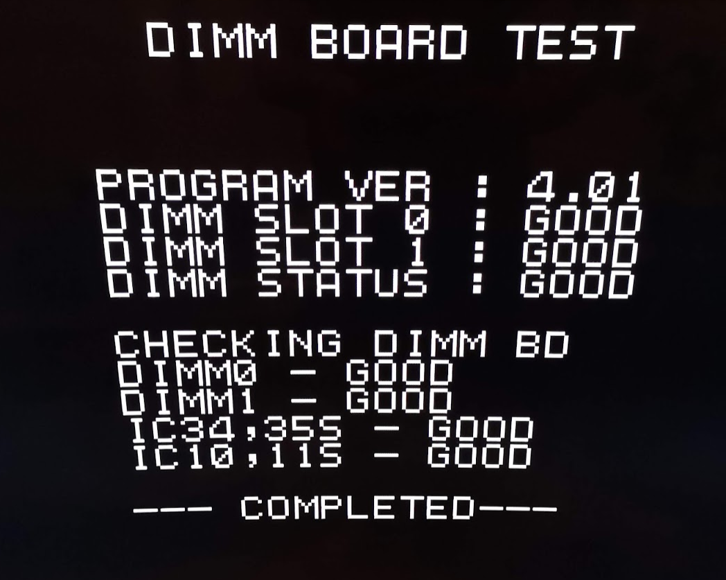

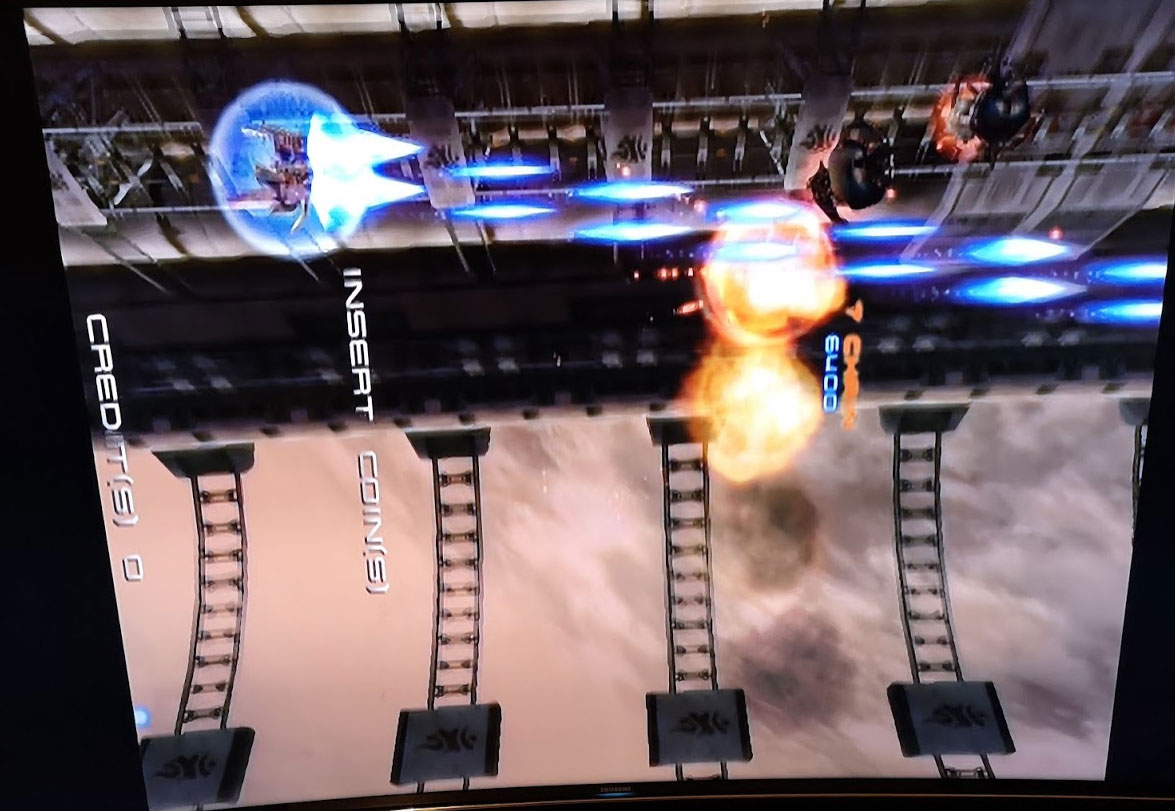

The issue I have is that this was all working just fine and I was able to netboot Ikaruga without issue using transfergame.exe, zero pic issues aside the Net Dimm module is just not booting at all after trying some of the python tools - this seems odd!!

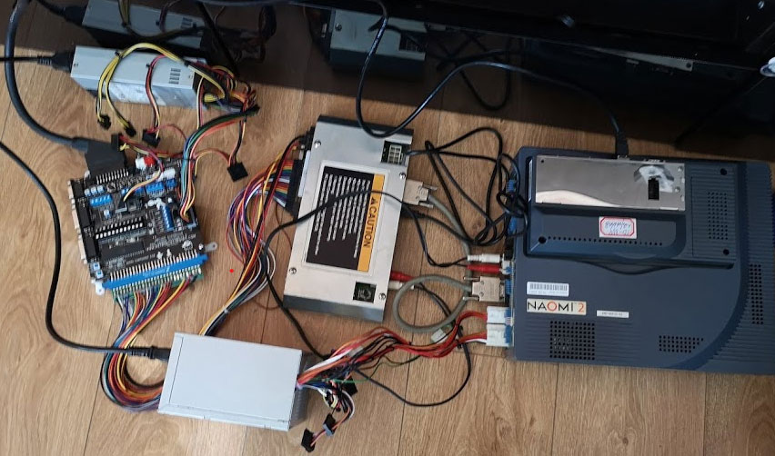

Just to add more detail on the setup - I am currently using 2 PSUs, one for a supergun which powers the Capcom IO over Jamma, and a separate PSU for the Naomi directly using both power connectors.
As I say I have upgraded the net dimm firmware, netbooted ikaruga and configured the net dimm using this setup up until I ran some of the python scripts which seem to have knocked out the netdimm. I can't even boot to run tests or configure networks etc...
Attached are some pics of the setup and ikaruga running prior to using triforcetools.py.
I will try another PSU (as many as it takes!) just to be sure, but wanted to understand if I could have damaged the Net Dimm in any way simply by using the python tools and doing something wrong - I dont think this would be the case, but I am no expert.

Can you take a reading with a Multimeter to see the voltages your Naomi is getting under load? It’s a bit tricky, but stick one probe into the ground pin and the other into the other lines in the connector. They should be as spot on as possible, especially the 3.3v.

Naomi 2 with Net dimm under load:
Net Dimm3v5v12v
6 pin connector3.29 - 3.34.98-
8 pin connector3.34.9711.99
Naomi 2 with cart under load:
Cartridge 3v5v12v
6 pin connector3.314.98-
8 pin connector3.314.97-4.9812
Annoyingly I don't have readings for when it was working! Nor I do I know what might have changed.
But this is starting to look like a power issue right?
4.98V is too low?
I suspect the 3.3 reading is the mostly at fault for me, although I have read some people need to pump 5.1-5.3 on the 5v line as well so 4.98v might be too low.
The odd thing is it was all running just fine, PSUs can degrade over time this was a (used) 80 plus gold PSU. Just an odd coincidence given what I was doing at the time.
