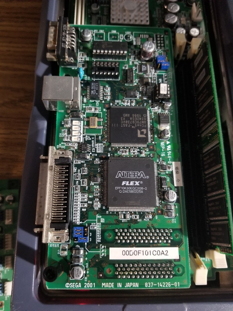

I got a Naomi 2 with a NetDimm ver 3.03 that I'm trying to upgrade but it doesn't allow me to change the network settings. I believe I have my jumpers correct and I've got USA bios. Where can I start troubleshooting?

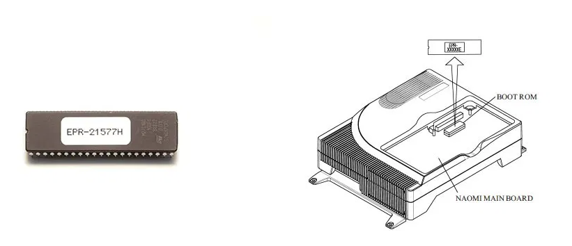

What ekorz said, need F or Newer Bios.

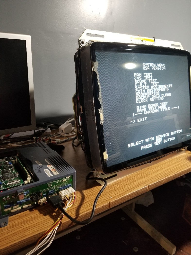

@DJLC go into DIMM Test, and take a screen shot.. Its possible your Media Board is bad.
