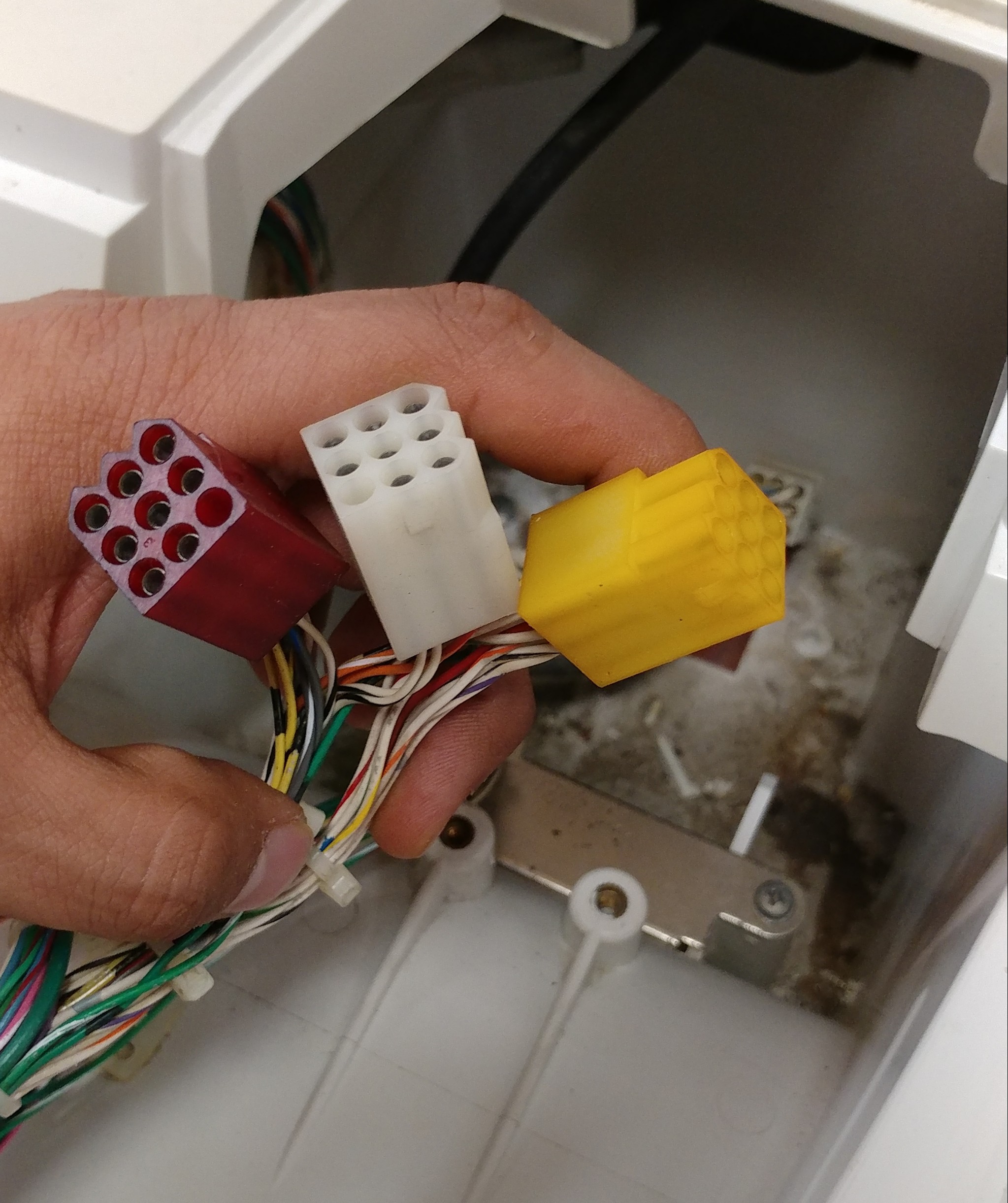

ok so the plugs on my naomi universal cab are not the same as the one on that net city link. Though I was able to get a third button out, still missing all the kicks and there are 3 plugs to the right and one 2 the left that are not connected. Would any of them happen to be the kick buttons?

Ahh US cab Molex.
In that case I find the correct buttons on the IO and trace to the other end of that loom.
Andy Geezer (AGS) has the JVS IO pinouts on his site.
I have found them now! Tested several pins until I got the right one. And for reference and anyone following, they come out of the yellow 9 pin molex! Now just to order a male connector and wire it properly. Thanks again for the help and attention!
