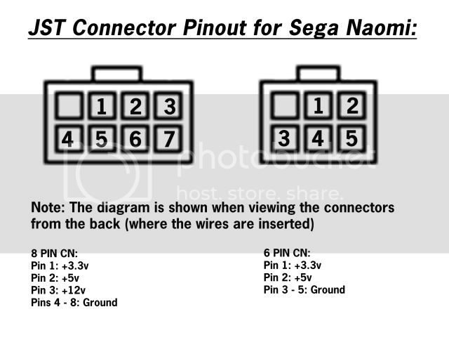

What is a PSU power supply? Power requirements are different for netdimm vs a normal game, so I’d start there. Measure the 5v and 3.3v under load right at the Naomi. Possibly you need to adjust the 3.3v line.
Maybe there's something wrong with my set up. I uploaded a picture just in case:
https://ibb.co/hVCbxzr

Well, you should be using the multimeter and adjusting your voltages - or you’ll soon have 2 dead netdimms.
