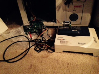

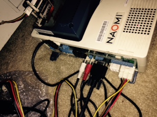

Hello,
I have a Naomi system.. I got the unit many moons ago.. the system gives video and audio but the joystick and buttons do not seem to work. I am not sure if I am missing a cable or dip switch setting.. If you have this setup please let me know what I am missing.. thanks

I don't recognise the JVS adapter from the picture, any chance of a closeup?
I've had issues with Sega V2's where the Naomi expects the coin meter to be connected before the controls will work. Think I fitted a 100 ohm resistor between +5V and meter-1 pin on jamma edge connector to fix it.
The USB A-B cable goes from the JVS-JAMMA to the USB port on the Naomi doesn't it?
He is using a JAMMA I/O rather than the JVS I/Os. Should still be workign for him though unless the I/O is faulty.
Thank you for the input guys. I will try to change the USB cable to see if that work then I guess move to getting a new I/O board.

Yes, the USB cable that runs from the top of the Naomi to your I/O board handles all the controls (Joystick/Buttons/Start/Service/Test/Coin).
That is odd that your coin/service/test work on the cab but not the joystick/buttons. It does sound like it could be a problem with the i/o board and not the USB cable, since you're getting some inputs.
If you can find someone that has a Capcom I/O for sale, that's a good replacement that has an audio amp built in.

The I/O board is just plug and play. Most games wont even boot unless a compatible board is detected.
Here is how the joystick and buttons should be wired to the 60-pin connector:
I would check to make sure the ground wire on your control panel is good, also make sure you have pin 1 and 3 jumpered together as that's what activates the I/O board.
EDIT: forget what I said above, the pictures didn't load for me innitially and I assumed you were using a normal Sega JVS I/O not a de-cased Capcom I/O.
The buttons and everything should still work just plugged in, but you'll definitely want to check your ground wire. Every button and joysticks switch on your control panel should share a single ground wire, if the wire is damaged it could prevent all of them from not working. Make sure your JAMMA connector is getting a good ground connectivity from the Capcom I/O and that you see that same connectivity in the control panel across the buttons and sticks.
I should also note that you really SHOULD NOT be drawing power from the Capcom I/O when using a DIMM board, if you're using something other than a cartridge you really should be using a proper JVS power supply connected directly to the NAOMI

from what I see in your pictures you're already using a Capcom I/O... just a decased one.
There is a switch on the Capcom I/O that changes controls to 4-player mode. Make sure it is not in the 4-player position.
Mitsu - thank you! I looked and no change with thee 4 player jumper off or on. I tried in both of my Egreets... Now here is the odd thing, I tested on my HAS supergun and I get joystick input using the HAS Supergun. I could not test with a game because I do not have a way to power the CF but during the test input I can see feedback on the joy when I press up down, push buttons. I do not know what is the PIN difference on the cabs and the supergun or if the I/O card has been modified to worked with suppergun.. What a mystery.. Once I get my hands on another I/O board hopefully that will solve the problem because I want to play on my Egreets:)...
