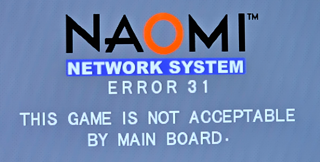

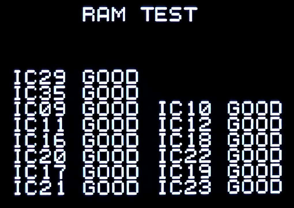

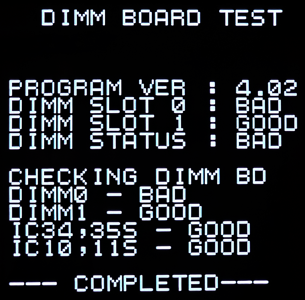

I recently got a netboot setup going with a NAOMI 1 and a NetDIMM running firmware 4.02. Everything was going well for a couple hours. I was playing Monkey Ball and Crazy Taxi with no issues. Then at one point during Crazy Taxi, the game froze and the audio was stuck in a 1 second loop. I rebooted the NAOMI, went through checking memory, loading, checking memory, then got an error 31 "This game is not acceptable by main board." I tried several more times with the same result. I ran the RAM test and it all came back good. I ran the DIMM test and got a BAD result for DIMM0. I ran this test when I put the setup together and got all good results.

Could it be that the buffer chip is fried? Would that cause these symptoms? It seems like error 31 could have a lot of causes based on my research.

Got my new 512mb stick. Dimm test still shows bad result. Same error 31 as expected. The dimm test fails around 40% when checking the slot. Same as the old stick. I also got some replacement buffer chips. Seems like they are a common point of failure so I might just go ahead and replace it.
Edit: I replaced the buffer chip and now my dimm test is passing. I figured I solved it but I still get error 31.. Tried both zero keys as well as the cf adapter and still the same issue. Seems like that buffer chip had something to do with it though. Are there any other components that commonly fail like that?
