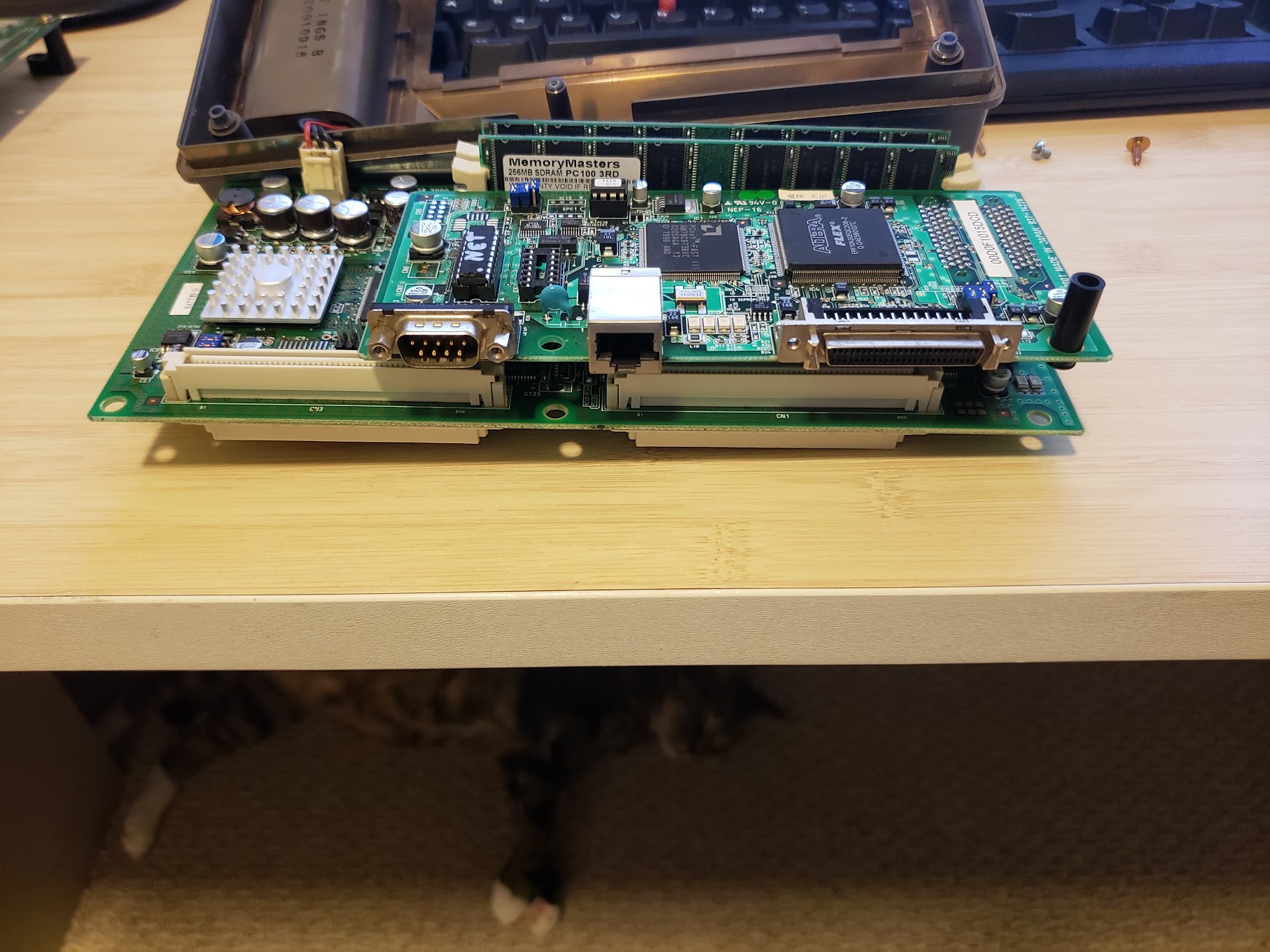

Double check you got the right PC100 memory. You can also use PC133 as well.
I used some MemoryMasters ram I got off of Ebay.
I think I spent like 30 bux.
If you can, open er up, and get some contact cleaner, and compressed air in there.
Clean out ALL the contacts, cartridge connectors.
I was able to scrub mine down with a super soft bristle tooth brush to break apart some of the oxidation on my dimm's contacts, and slots.
That helped me a lot because I was having a similar issue.
Also in another thread we've been talking about power.
Make sure you are powering your Naomi 1/2 adequately.
There's loads of shit faults with these when they don't have accurate 3.3V.
Attached is a picture of mine.

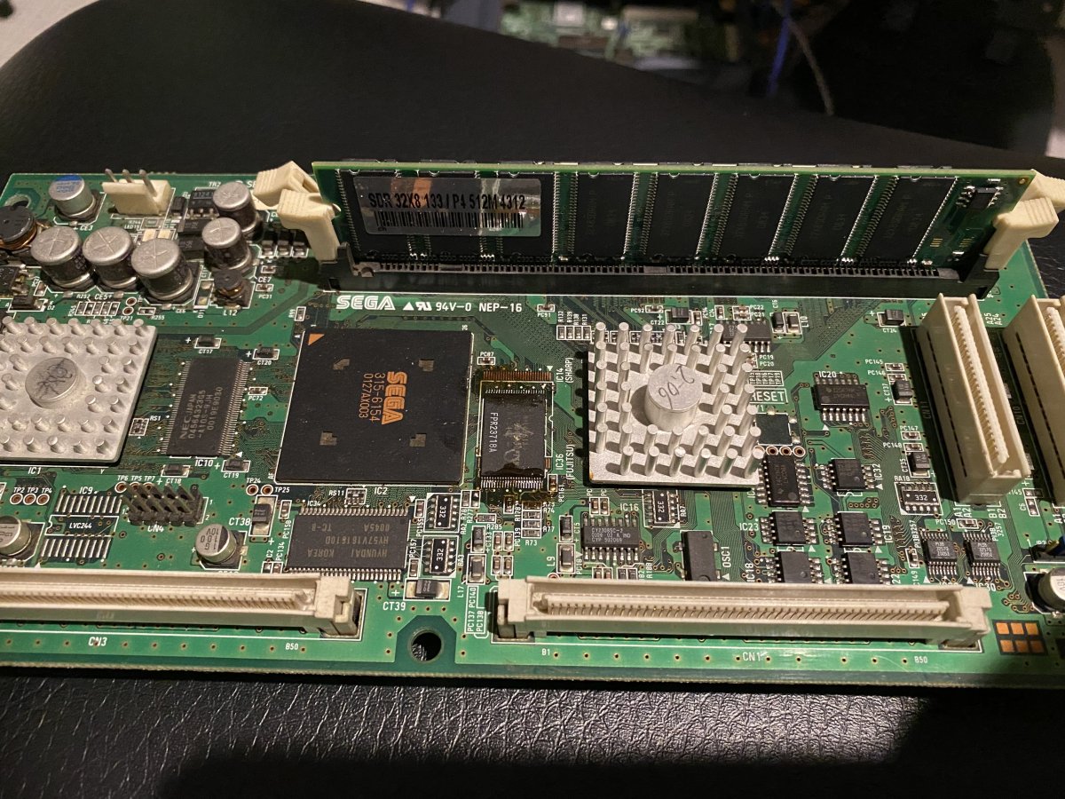

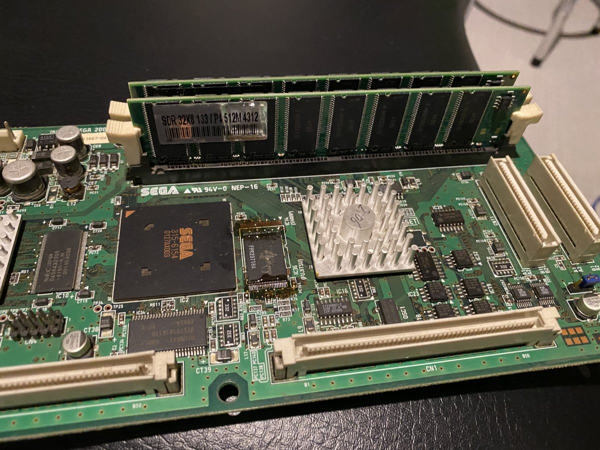

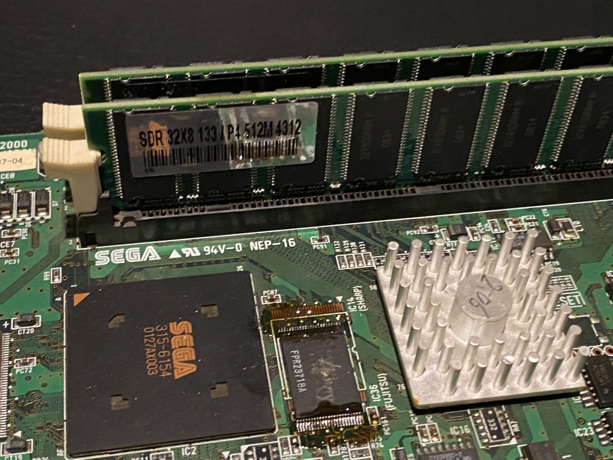

Resurrecting this post to let the thread know my findings. 1gb 512mb x2 of this ram, or any RAM plugged in the front spot, will timeout the board. However, a single 512mb Ram plugged in the back slot will work fine. At least that’s what happened to me. HTH
