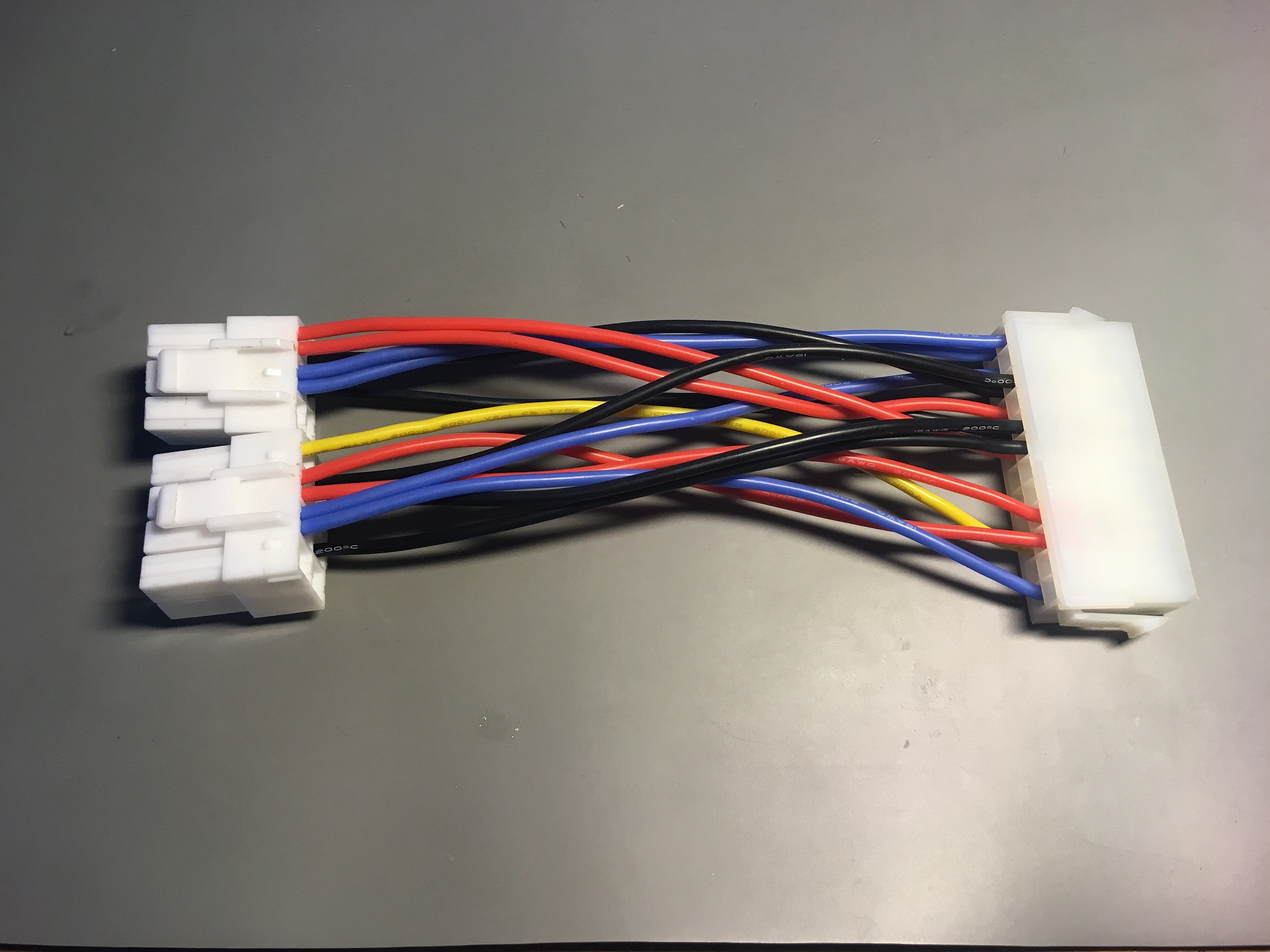

ATX supplies are fine - they have plenty of oomphf, it's the adapter and cables that's critical.
You definitely want to use as many wires from the ATX side as possible to avoid voltage drop. If you don't have any voltage drop to speak of, you don't need to fiddle with adjustments.
Attached a picture of the one I recently made.
Some details on voltage drop here:
https://irkenlabs.com/jammafier/power
In practice, for 3.3V and 5V you want to use 4 wires for each rail from ATX supply - resulting in 4xAWG18=1xAWG12 - which is plenty.
