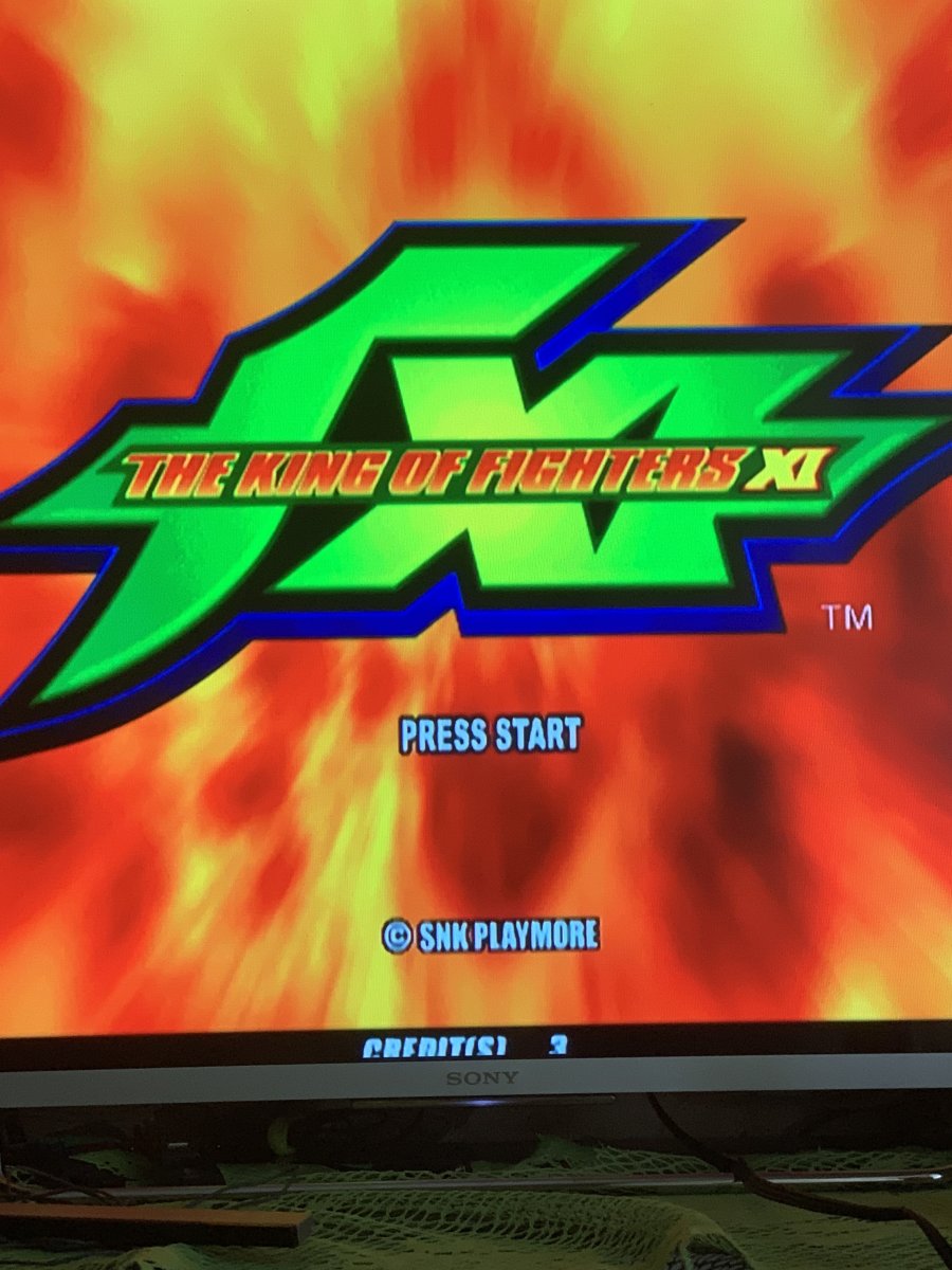

Hi. Recently bought Naomi and DIMM. Loading game with the CF card. I noticed that for example in a capcom vs snk 2 or a Street Fighter Alpha 3U is missing game intro. After loading Immediately appears to title screen. What could be the problem ? Atomiswave no problems, all games with game intro.

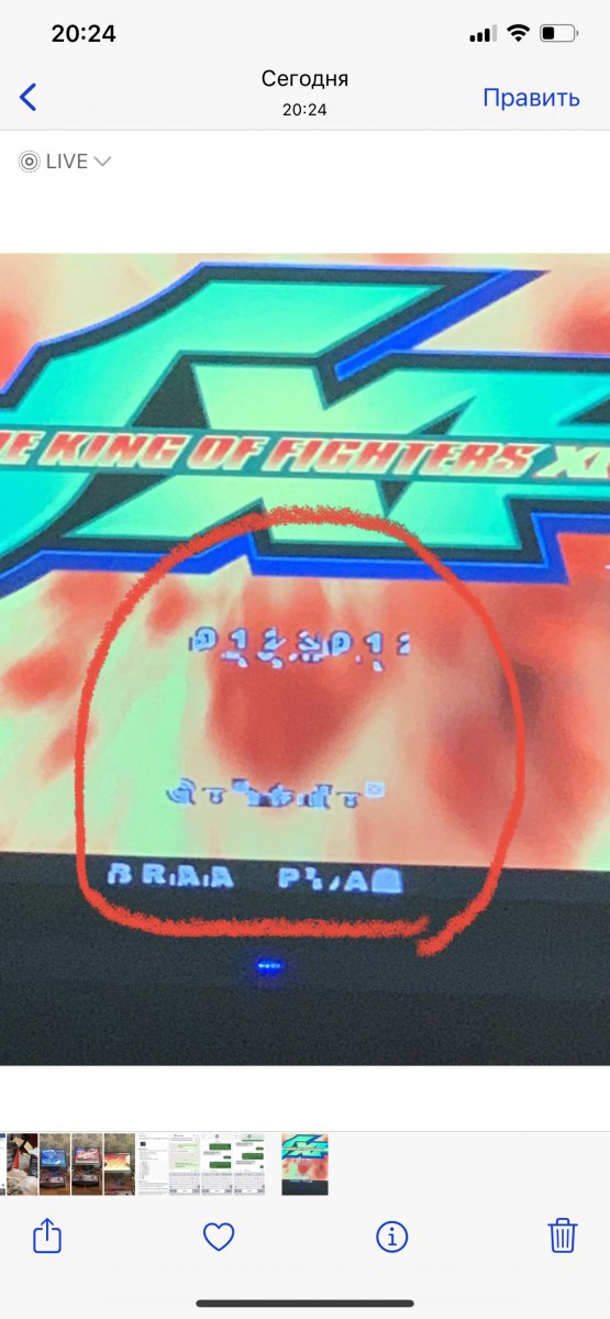

And another question. All games will be enjoyed well, except one game. Kof11 has letter problems. What could it be ?
Thx
Games generally stay on the title screen and don't go back to attract mode if credits have been added. Credits probably stay in memory after shutdown too. There could also be an option to turn off attract mode in the system settings too.
Yes, NAOMI generally saves credits after poweroff. It's pretty normal for the game to sit on the title screen if there are any credits in.
I also think a fix for that games text was released, but that's from memory.
Thanks too. Now I found normal rom.
