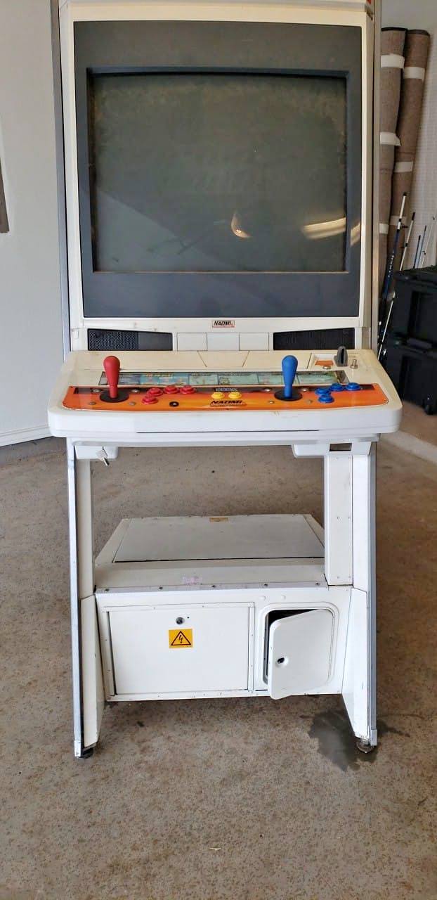

Absolutely, it looked very stock to me, too. The quotes weren't meant to suggest this was a hack from Sega, but more tongue-in-cheek of making the cabinet compatible in the US by rewiring it.
It is also very much a NUC, with a 31Khz only monitor. No Toshiba, though, but I can't complain.
It's a great cab. I'm thankful it came in great shape to begin with, so very little to do to it- CP, minor wiring, TLC. Everything else I've just lived with, mostly to spend time playing it :thumbsup:
