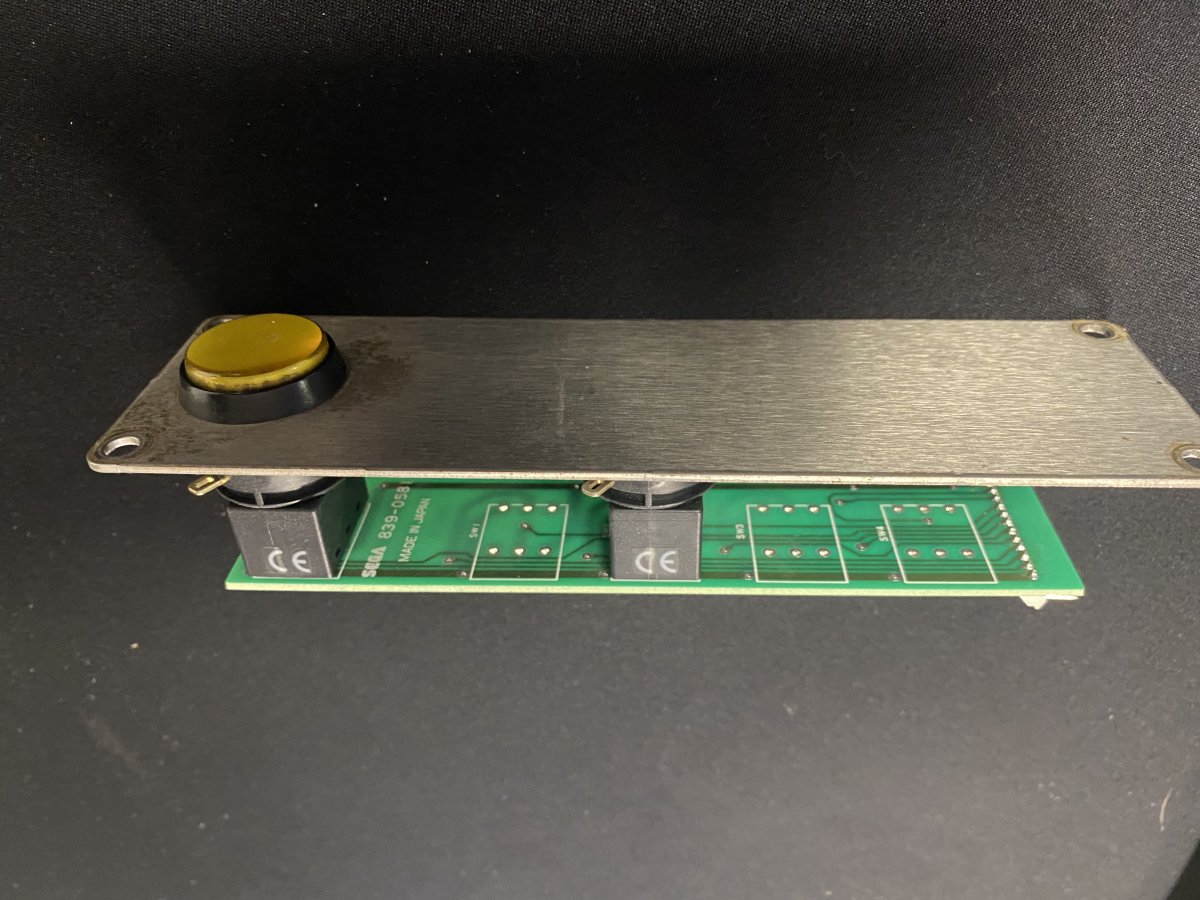

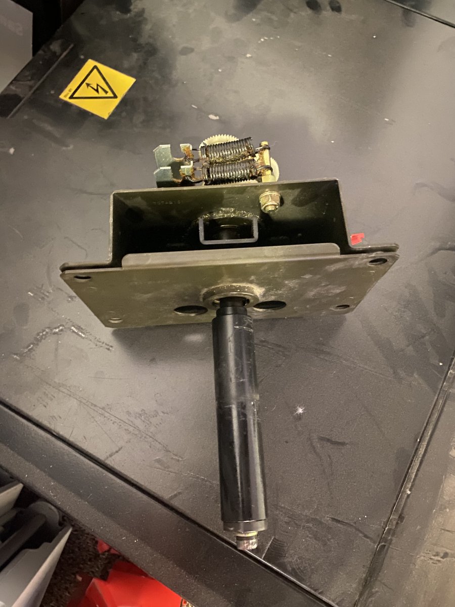

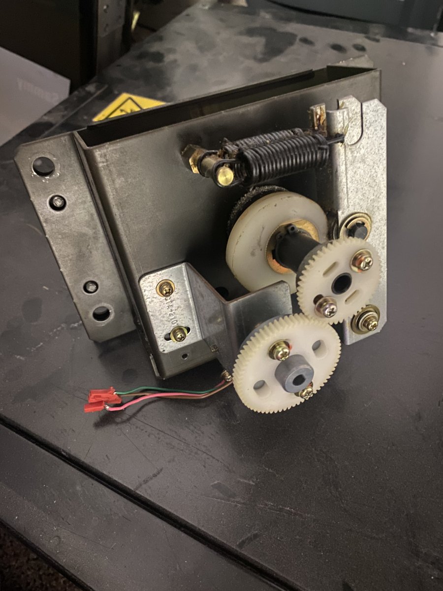

Can you show me a pic of what exactly do you have?
These are the crazy taxi parts, the 18 wheeler was a complete cab so I still have all those as well

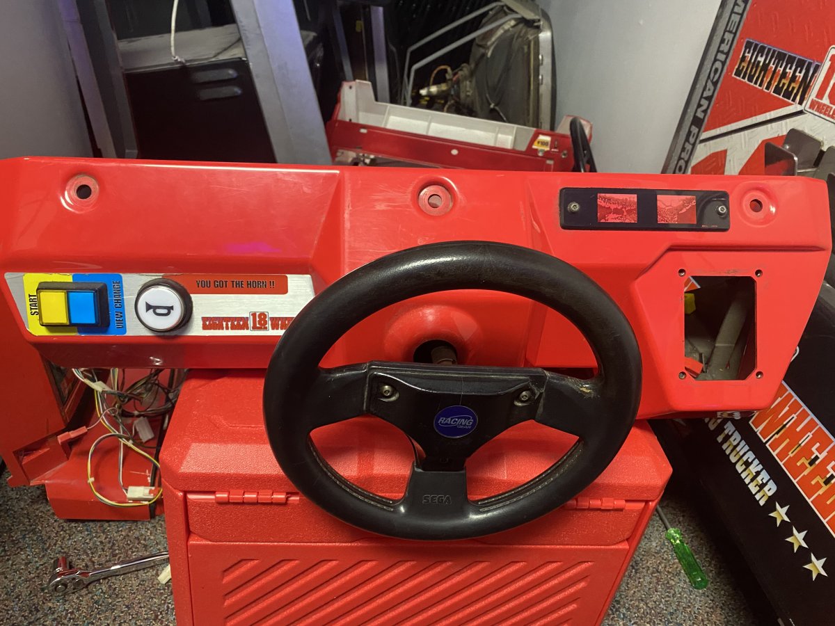

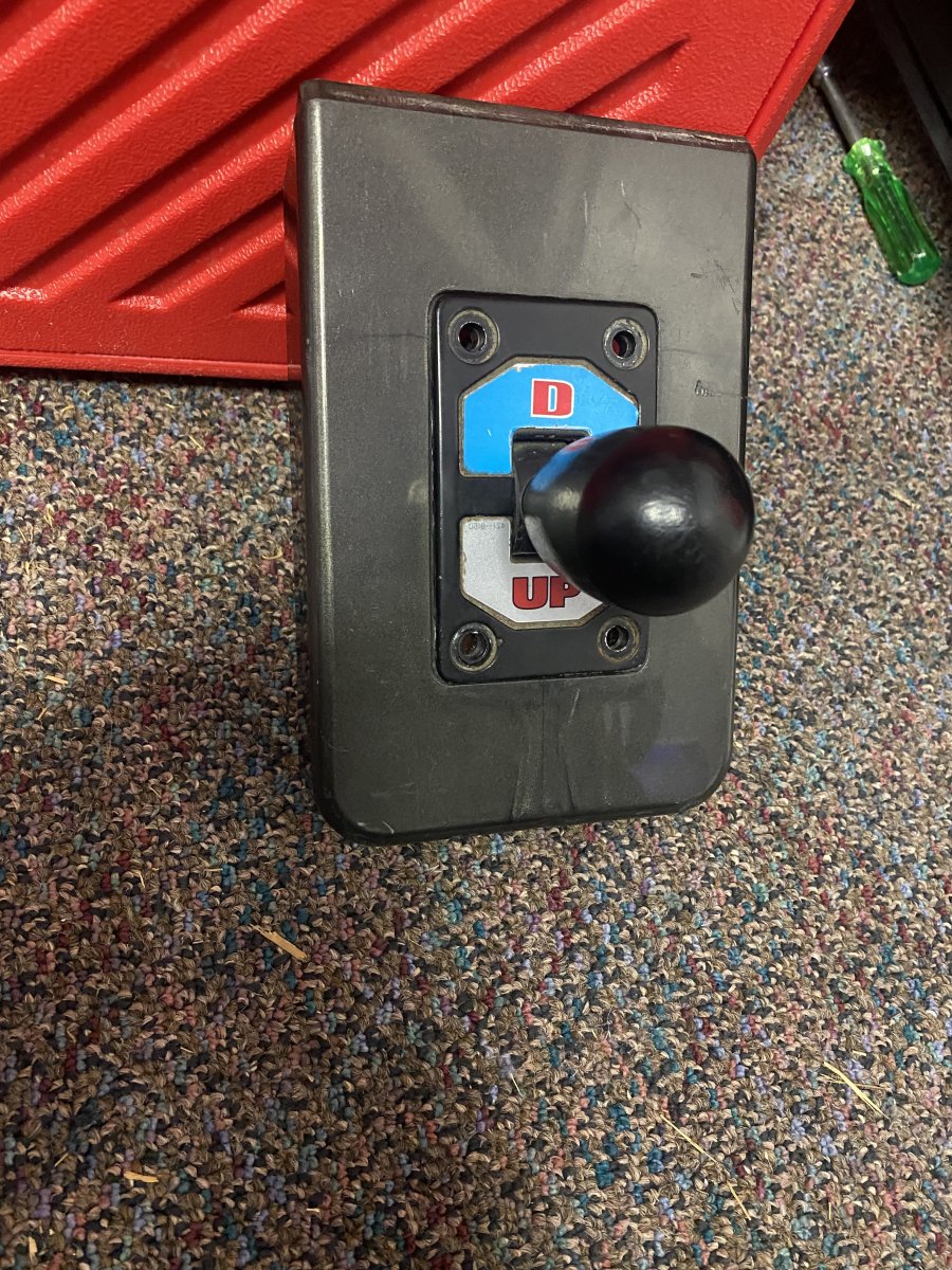

I took pictures of my cabs.
18 Wheeler:
Jambo Safari (same as CT):

I’ve done the 18 wheeler to crazy taxi conversion. I followed an old sega-naomi.eu post that said to take pin 23 out and place it in where pin 24 would be. Alternatively, you can dual wire pin 23 to 25 and 24 to 26 to make the shifter work correctly. Even though the 18 wheeler steering has different end stops than the crazy taxi wheel (320 vs 270 degrees if I recall correctly), Crazy Taxi and Jambo Safari was totally playable. Eventually I hacked up a cheap original Xbox wheel, transferred over a Crazy Taxi steering assembly and made an interface box so I can run Outrun 2 in a modded 128mb ram Xbox on the upright Naomi. All reversible if I wanted to go back to Naomi hardware.
