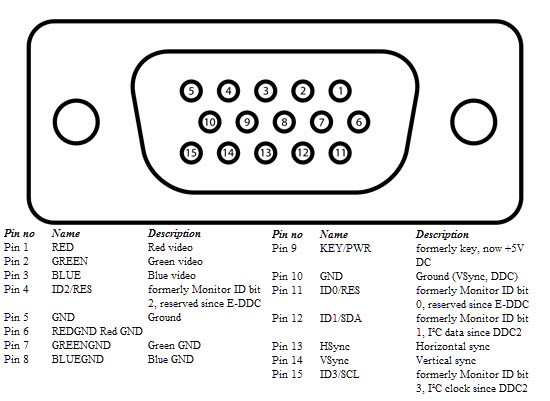

here's a complete VGA pinout
looking at this pins 4, 9, 11, 12, and 15 could safely be removed.
chances are pin 9 is the one giving you grief. it looks like some older cables had this pin removed, and newer cables run +5V on this pin.

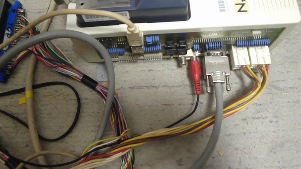

That's not the official cable. the official cable has metallic housings on the plug ends. and the cable itself is light gray. They look like this:
I just snapped a quick pick of mine... it's missing pin 9
sorry for the potato quality, my battery was so low it wouldn't let me use the flash :-/
[pic]
Naomi cabs from Europe have a black VGA cable similar to the one in darkstrider2's pic. I've only ever seen light gray cables on cabs imported from Japan.
(I don't have any US cabs.)
Interesting. I didn't realize Europe got different versioned cabs.
My Net city is from Japan, and at least one of the cable sets I have came from a USA Capcom Powerstone kit, which included the same VGA and JVS cables as my Net City.
