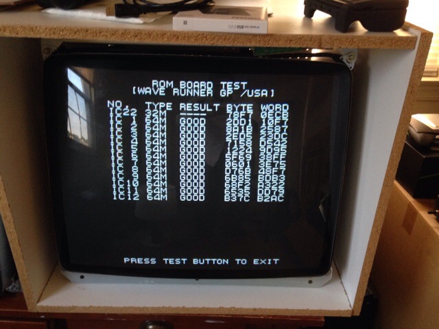

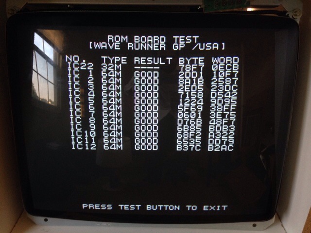

Not sure if this is what you are looking for..
I was asking for BIOS System Menu - ROM BOARD TEST (there is all rom board check sums will be printed)
but thanks anyway :)
