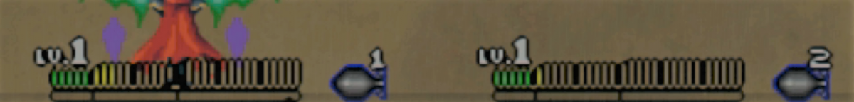

At the bottom of the screen (that would be the left side in horizontal mode) there's a dim band, just a few rows. If any bright pixel enters the band it creates a dark streak across the entire screen (vertically). Below is what it looks like on Gunbird 2 through VGA capture. No artifacts manifests it self over the VGA capture but it shows the band pretty clear (sorry about the dim picture, I was using a passive VGA splitter).
