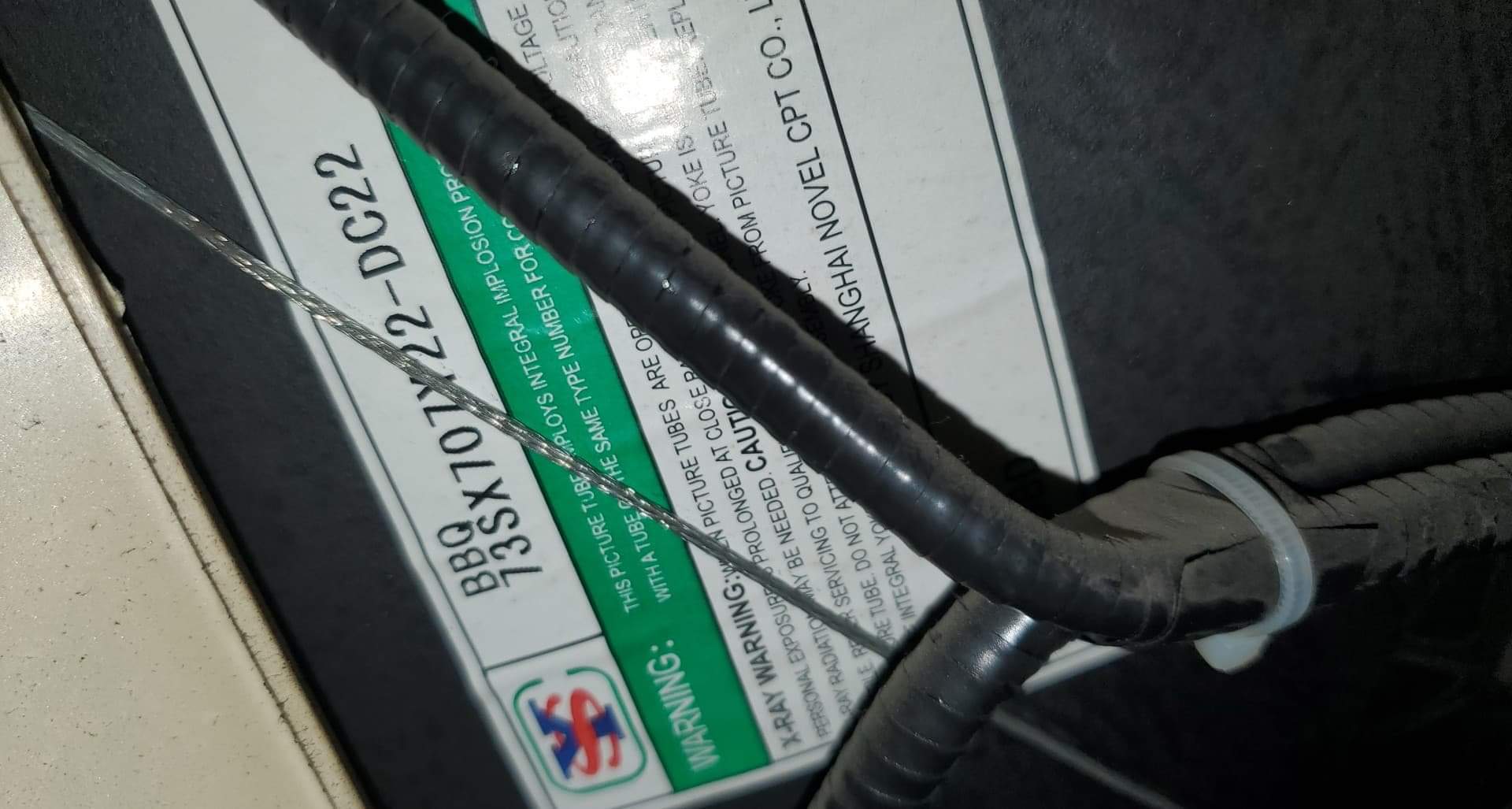

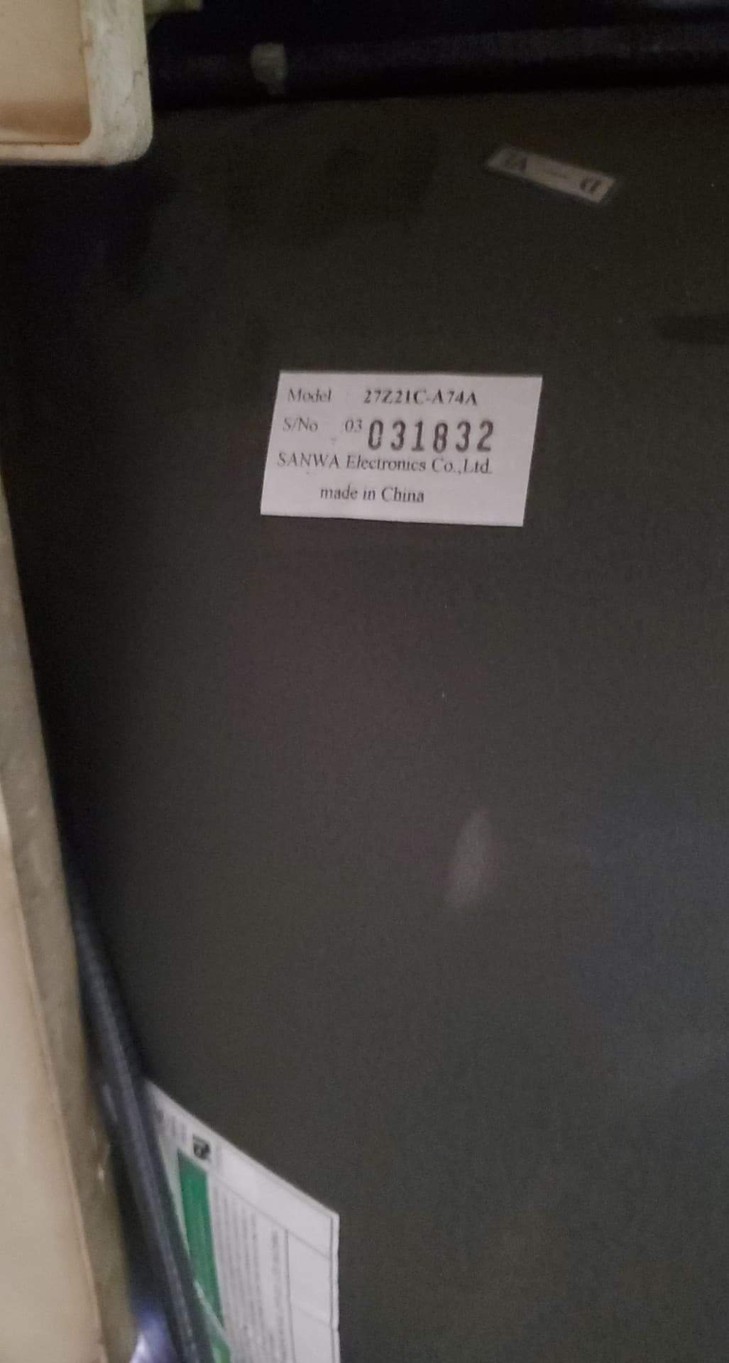

ok I got my chassis from @rewrite but it's not a 29e31s as I thought it's a sanwa pm1745 15hz/24hz only
This is going in my konami windy2.
Iv bern told by @radiantsvgun that the 2930 is a direct drop.
So could anyone make me an adapter to power and get vga to and from my windy2 and monitor. I'll pay.

What's the connector on the Sanwa? 15-pin AMP UP?
The nanao ms2930 tube and chassis is a direct swap. You need to swap tube and chassis.

Just be careful - if it's a PM1745 and you connect VGA to it, you will blow up the chassis. VGA is 31k
The Cyber Lead is 15/24 and uses a DB15HD (VGA style) connector, but it has pins removed
yes I know that's why I need something made for windy2. I have a konami jvs to jamma. Still connect the rgb vga to it.

But if it helps someone this monitor I'm using has no 31hz
A 2930 nanao dsub/vga/DB15HD is a drop in replacement. (Just wouldn't add the 31hz stuff)
