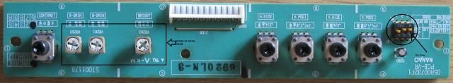

M Maytica9 Beginner Joined Nov 24, 2022 Messages 4 Reaction score 1 Location France Mar 10, 2023 #1 Hi , I need help to change the potentiometers of MS2930 remoter controller (blast city) which are very bad! Does anyone know the value (XX Ohm) of these potentiometers please? it's about 8 potentiometers ! Thanks a lot Attachments ms2930_remote.jpg 18.9 KB · Views: 81
A advans14 Professional Joined Sep 1, 2022 Messages 646 Reaction score 484 Location Portland, Oregon Mar 11, 2023 #2 Yup. 10k x 4,, 5k x1 small pots are 3.3k.
