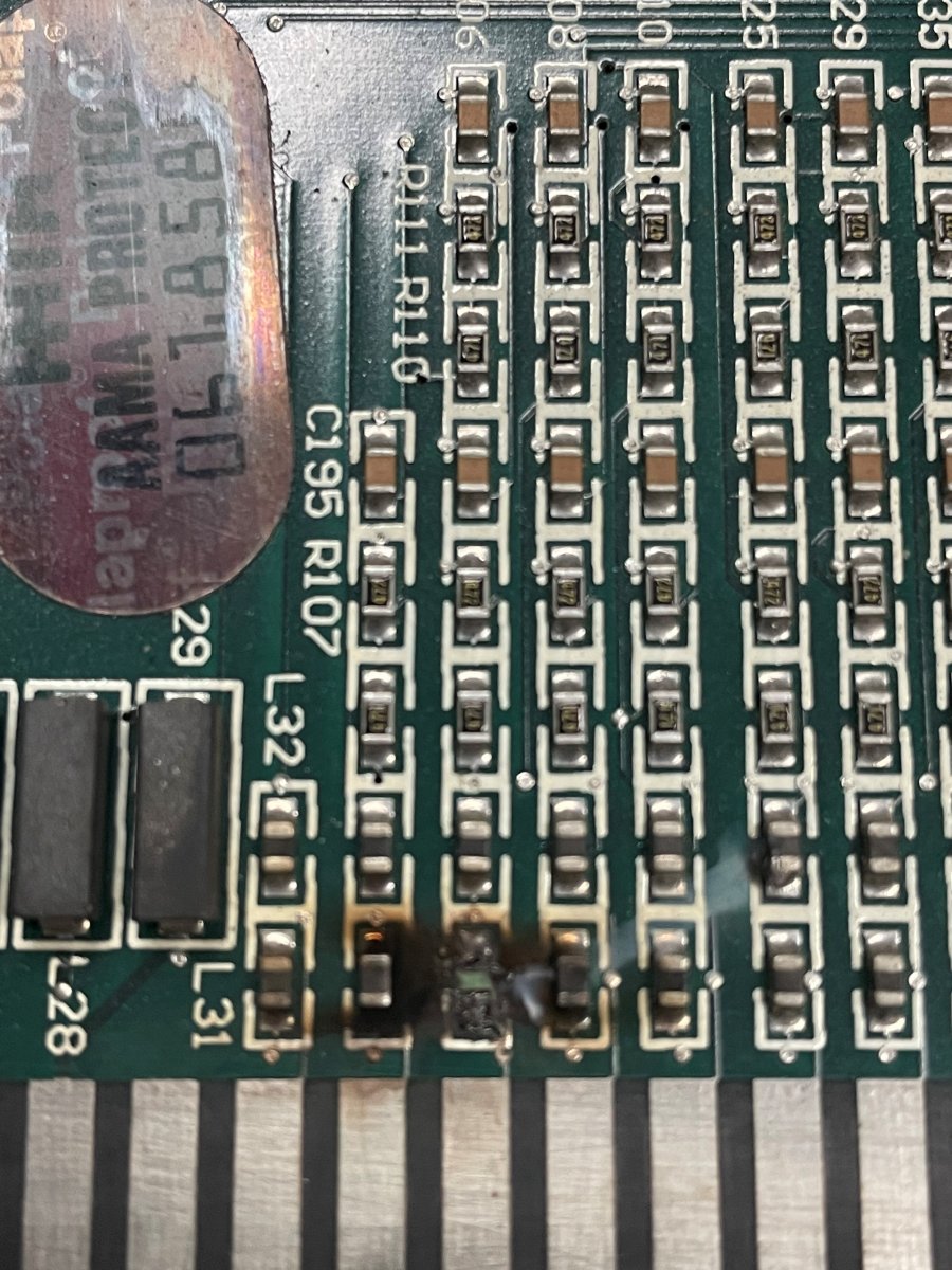

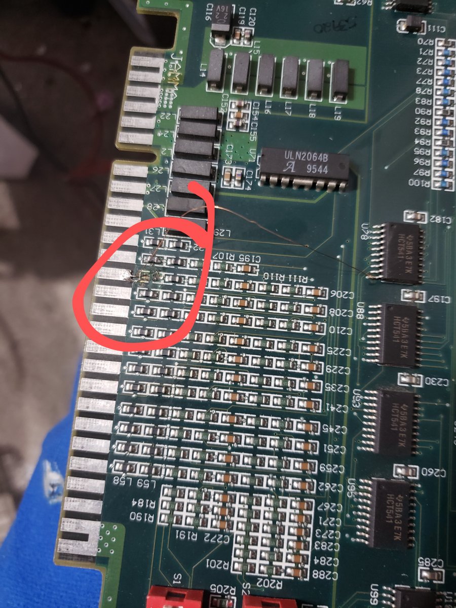

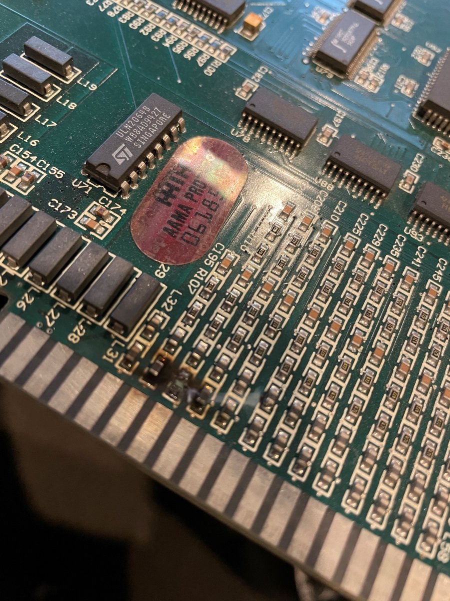

I have a KI that has a blown video ground most likely from pluging into a monitor with isolation. Can anyone take a clear picture of the video ground section by the jamma edge
@ekorz Thank you that helps a lot. When the inductor blew it took the via with it. I had to use the one on the back. Time to get a dom to finish the upgrade and repair. This is been sitting in my queue for a few years
