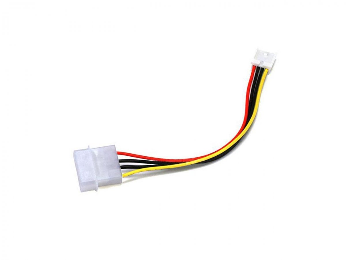

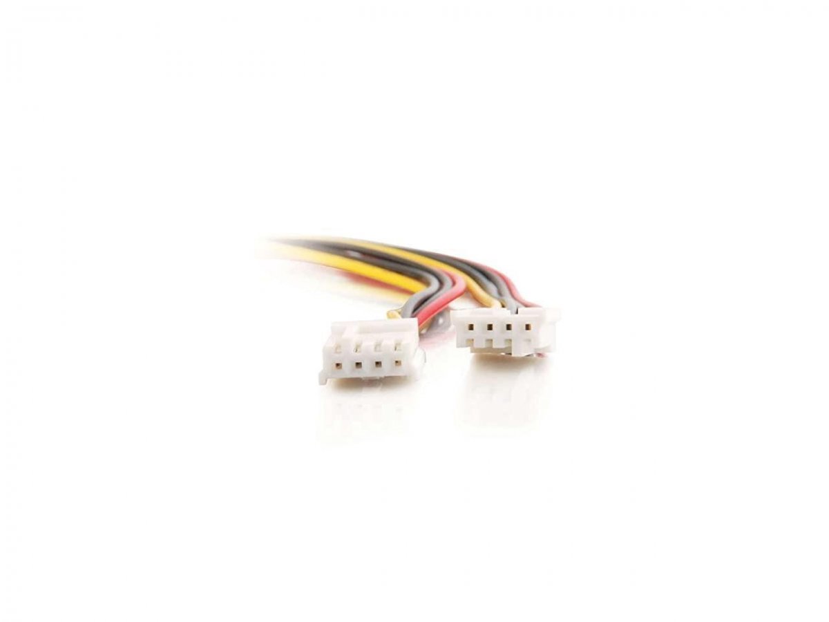

OMG please tell me you still exist and come around now and then...! I am trying to fix my (Korean ver) Fighting Mania cabinet and get this... Whoever I bought it from STOLE the frickin' CD drive out of it WITH the power cable! I picked up a new CD/DVD drive, hopefully it works, but I took it for granted that I would have a Molex power cable that fit it, and none of mine do. Searching for "4 pin Molex power drive to board" etc. isn't specific enough, I need the exact form factor for what this 573 takes. Do you happen to know, and where I could get one? The two stock pics here are the sorts of wire I was trying and it did NOT fit, the head is barely too small/tight to reach over all 4 pins.
Also I have an RTC error too, but... if this can be played without fixing that, I'm ready to ignore it for now, lol. Having a CD drive is a little more important right now, I couldn't even reinstall if it came to that at this point!

I had no idea what any of that writing meant, so thank you nem! I'll see if I can find one of those.... What's involved in crimping? I definitely don't have a specialized tool for that... I do have a soldering iron?
Well for closure's sake, way back in like August of 2021 lol, after looking around the internet for a few weeks, I could NOT find such a connector. So, to whoever sees this in the future, you should know.
Staring at the Molex power connector I had as shown in the pics in my previous post, I was thinking to myself, "this thing isn't even useful in my modern computer, what with SATA drives and all, and I have like 5 of these. This is literally my only purpose for it, these are going the way of the dodo." So I stared at the keyed notch in the head to figure out how it would have connected, would it have fit, and figured, that's got to be the order these wires are supposed to go in.
And I cut the small head off the other end of the wire. I stripped the yellow, black, black, and red wires, and straight up soldered the wires directly to the pins. That sucker ain't coming off.
Fired it up, powers up fine. Put in the CD, re-imaged the RAM, I am back in business!! It has worked the past two years!
