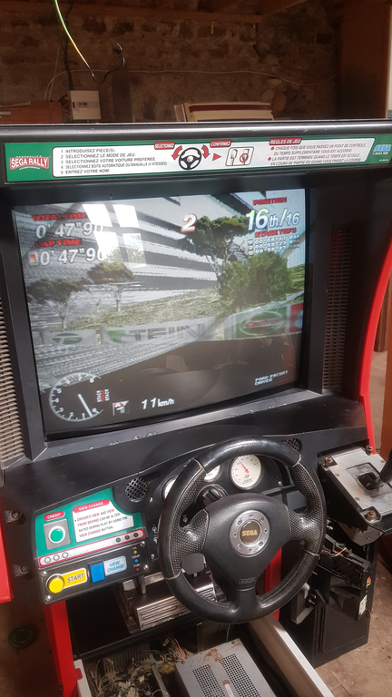

A few weeks ago i baught a sega rally 2 twin cabinet.

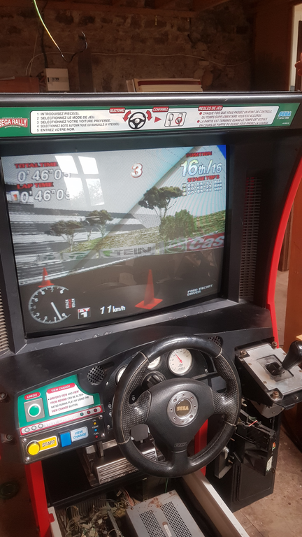

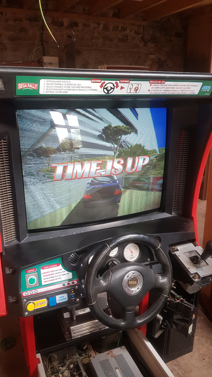

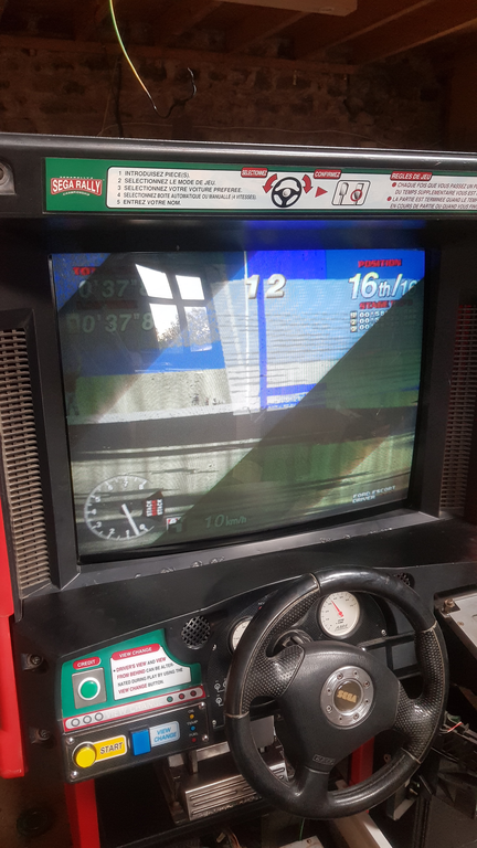

I had restore everything and all was ok but sudenly when i was playing my game did that and i don't know what to do...
I swap the PCB beetween the cabinet and same thing on the over cabinet so i swap just the video pcb and so when i put in the secong one same thing happen .
It is possible it is a capacitor or a ram... can i fix it or must buy a new video pcb?

Check that all the pcbs are tight together. Check with a multimeter that you’re getting the board enough power. That graphics issue doesn’t look like a power problem to me but it’s easy to check anyway. Get a multimeter and set it to direct current. Put a probe on CN13 one of the GND ground points, then check a 5v pin to make sure it’s actually seeing 5v. Also check 3.3v. Do the measurement while the board is connected and running.
Unfortunately most everything else will be harder to fix. the next thing I would do is check the pcb, and those are pretty large pcbs. There is a supercapacitor that leaks sometimes and causes ram to get corroded.
So if you see anything like that, you probably found your problem. Otherwise it’s not a very easy system to troubleshoot. You may be better off finding another Model 3 step 2 board to use and swap the rom board onto it.

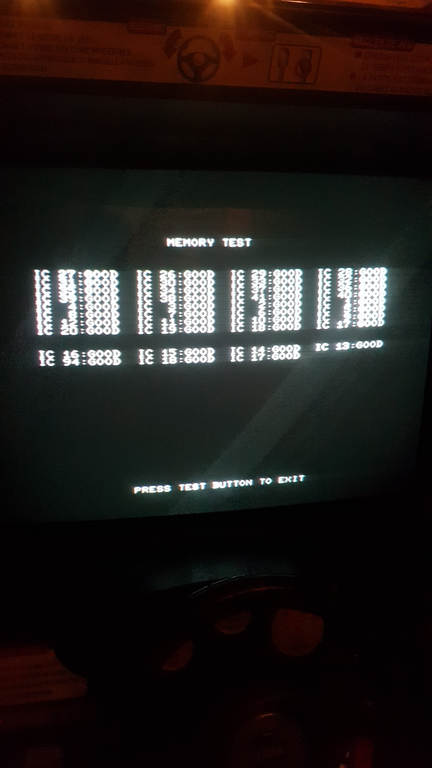

So i did the memory test and everything seems ok.
Looks to be a limited ram test much like with Lost World Jurassic Park so all ram showing good on this game doesn't really mean much. Daytona USA 2 and Harley Davidson have better board test diagnostics.
This is video ram error as most of the time 99%
So I suspect a BGA reflow or a ram failure due to creeping voltage over the years in the psu
CHECK YOUR VOLTAGE !
you need to check it at the filter board when the game is running 5 volt and 3,3 and you can adjust at the power supply aka psu
don’t swap out boards as if the voltage is to high you can have the same burnout problem
Btw cpu s on these baby s are verry good so I don’t think that’s the case or it must be a super cab leak which I don’t think.
if you need a repair/new cpu or video I have plenty in stock
