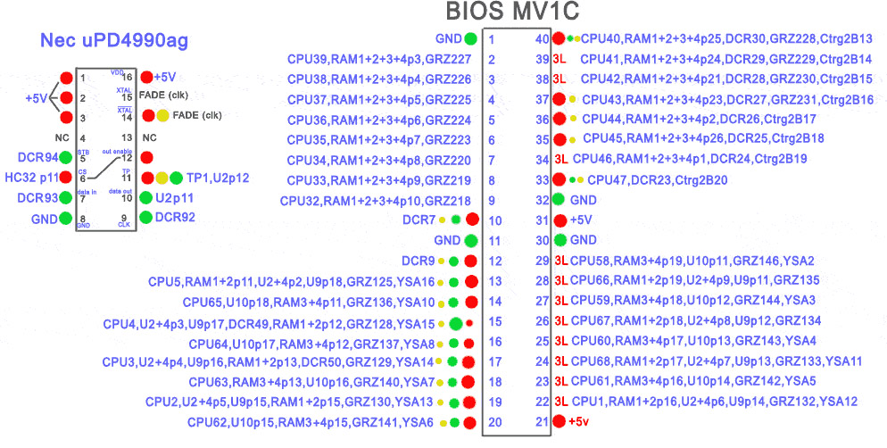

Here's the pinout, quoted from MKL:
RAM___CPU
1______43
2______41
3______36
4______35
5______34
6______33
7______32
8______31
9______30
10_____29
21_____39
23_____40
24_____38
25_____37
26_____42
etc.
There are 3 pins for each backup ram chip that are not connected to the CPU:
lower ram:
20_____74HC32 (13) located at D10
22_____PRO-C0 (16)
27_____74HC32 (8) located at D10
higher ram:
22_____PRO-C0 (8)
27_____74HC32 (6) located at D10

Shit, forgot this was for a 4 slot, that pinout is for an MV1C, different bios pinout.
