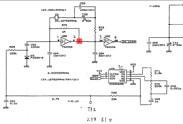

When doing voltage tests, I found a place that seems to make the glitch go away when touched with a meter probe or screwdriver.
It is the red zone in the schematics below. That C54 has been replaced already, and there is no bad trace from there. Resistors around are reporting good values.
I do not need to push down, just touch the cap pin, and it makes the video "stabilize", and I can see the unibios white screen with no cartridge.
I do not understand why, but it may be a clue for more experienced troubleshooters.

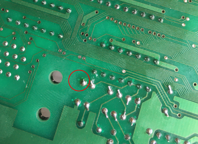

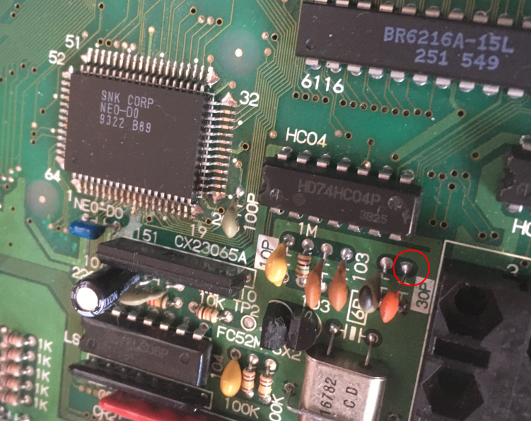

daifuku74
May 2, 2021
11
5
France
At this point, no suggestion is dumb.
I can't find cold solder joints or anything in this area nor anywhere.
Also the continuity is good from this mysterious pin.
I can't understand why bridging this cap leg with air improves the situation.
I circled the cap leg in red on both sides on images below. This cap is new. With the old one it was the same.
On the picture it seems there is dirt below NEO-D0 but this is only a reflectionof light in the picture, the board is clean.
On the reverse side, some little flux remains near the circle, but it's okay.
There are also little lighter green dots, these appear on the PCB when using hot air.

On the line of this 30pf is another 6pf, then it goes to 74HC04 and then on the other side it's the oscillator.
Other sources have suggested replacing the crystal. Thing is I cannot find an exact match. There are 24.000 Mhz available but this one is 24.16782
so I'm not sure if I can go ahead and swap it for a 24.0
DigiKey sells programmable clock crystals - tell them the speed you want it clocked to, and they'll set it before they ship it to you.
