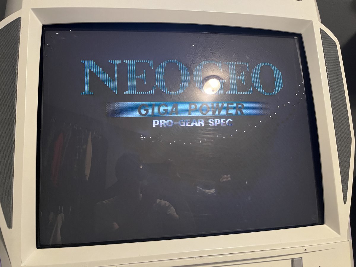

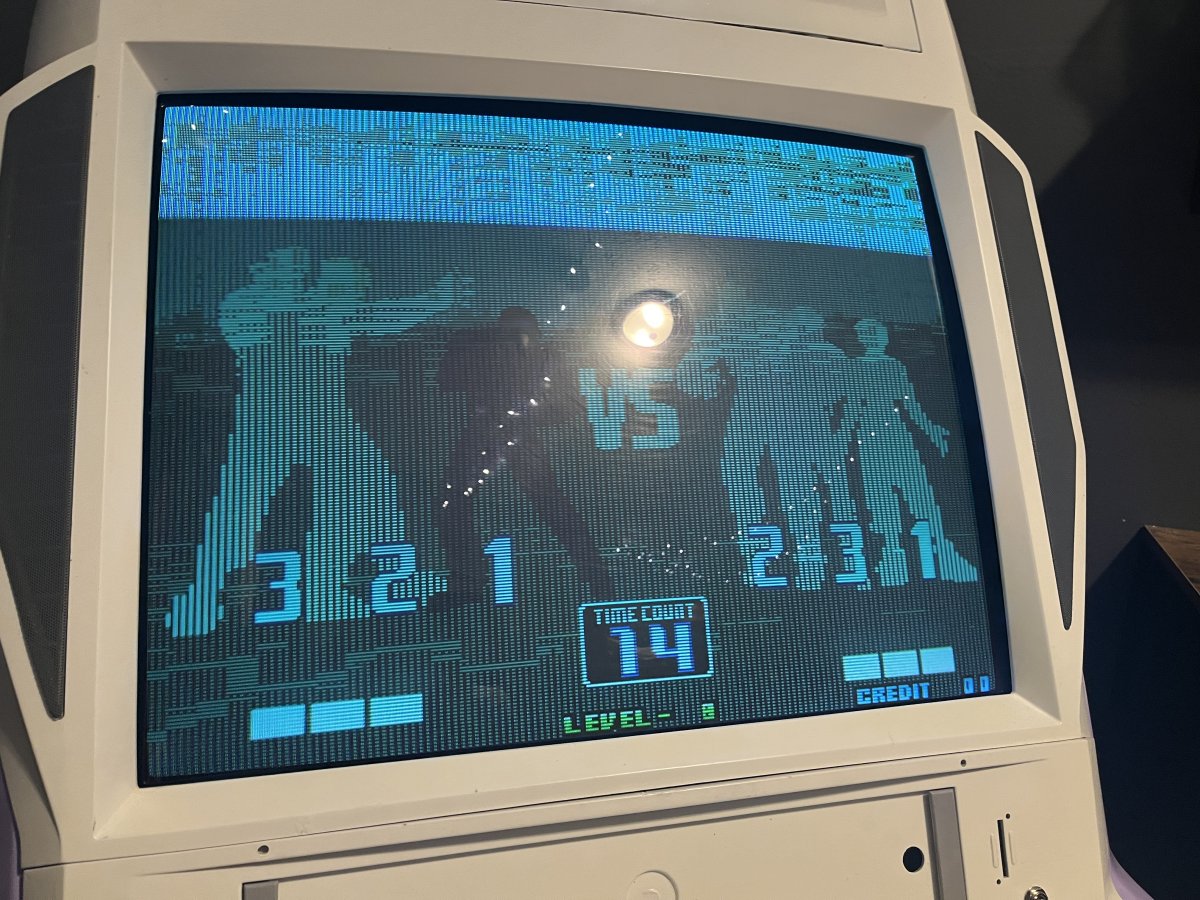

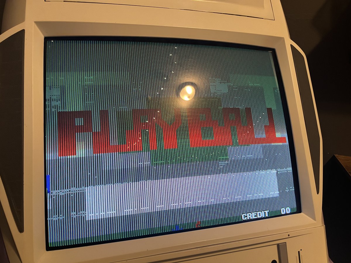

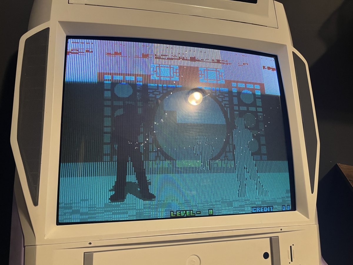

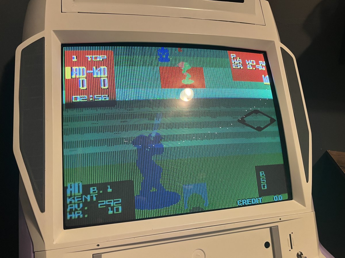

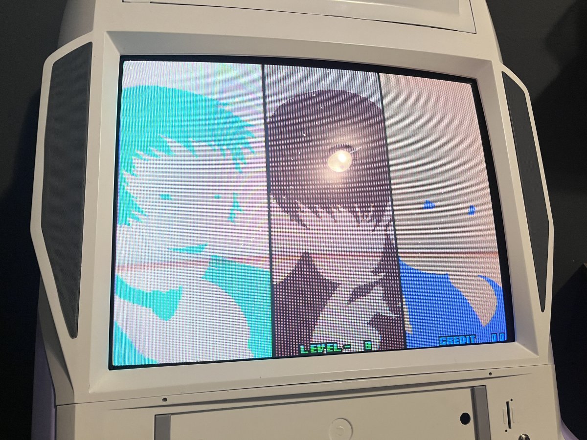

I recently got a new candy cabinet so bought a cheap mvs board on Ali express with a 161 -1 to put in it. Today I was letting it run however it randomly started having graphical glitches. Reseated the cartridge but issues remain and are in photos attached. I don’t have another cart to test. However looking at the problem I think it may be something bad on my board. Anyone encountered this issue before?

It could be a bad L0-Rom or a broken trace between the video chips.
If the cart itself is not the problem.
