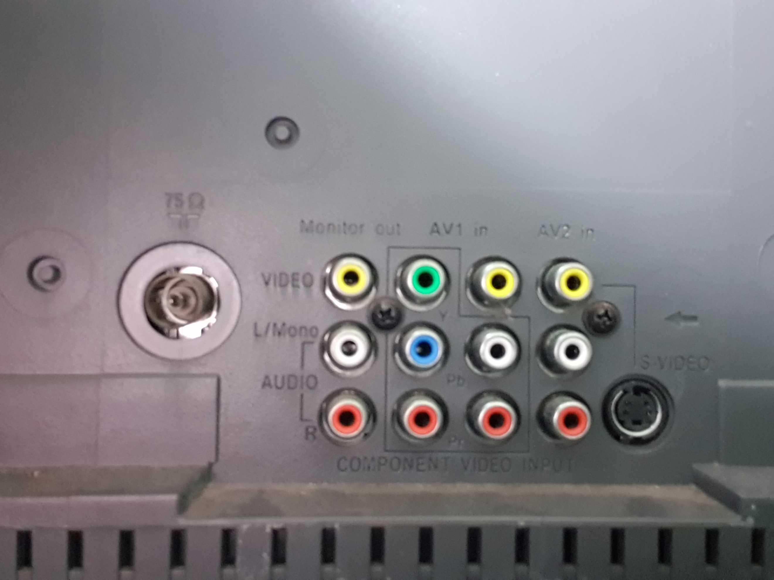

well it has component inputs (the green/blue/red connection), so your easiest bet would be to get the RGB scart cable I linked to above and then get a RGB to YPbPr adapter, something like this;
https://www.ebay.com/itm/SCART-RGB-...-Adapter-for-vintage-video-game-/273178172012
Total it is gonna cost ya, but the AES is worth it to display its full glory :D

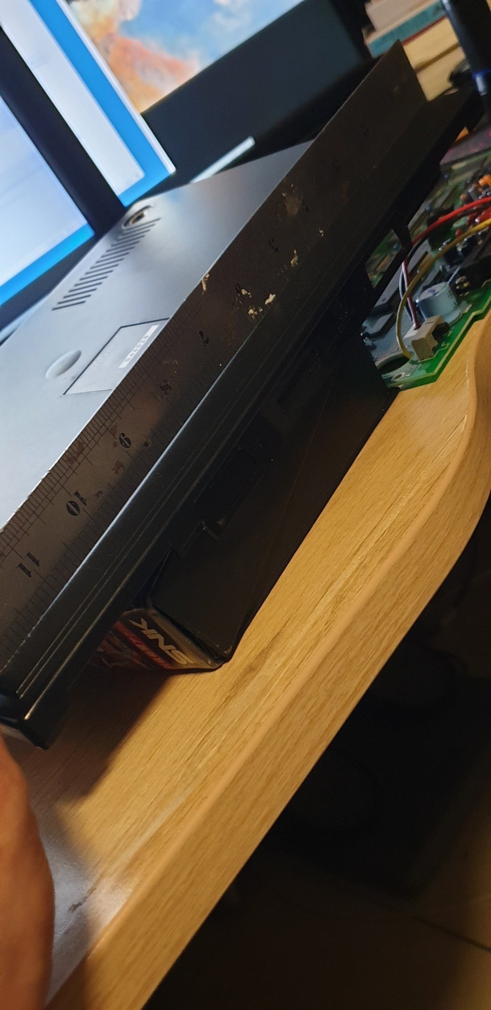

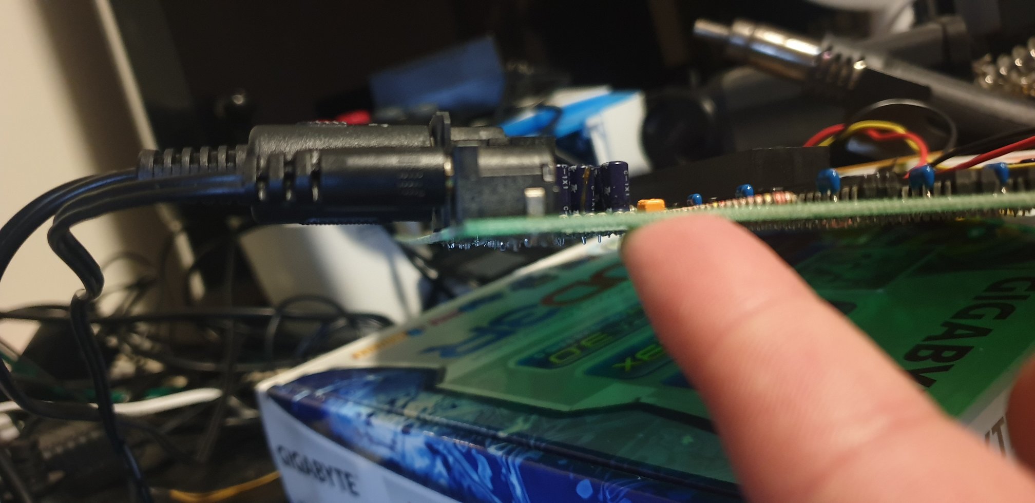

I now have this working in ntsc with correct colour, the mobo needs a look over, i never got it working correctly upon arrival and assume it was ntsc/pal problem, could be a cracked trace/joint or caps need replacement , a little bit of oxide on one of the joypad socket bolts , the bottom case shell is curved and the mobo is slightly curved to , i could only get this running in ntsc mode with the mobo flat on a table and it's a hit and miss.

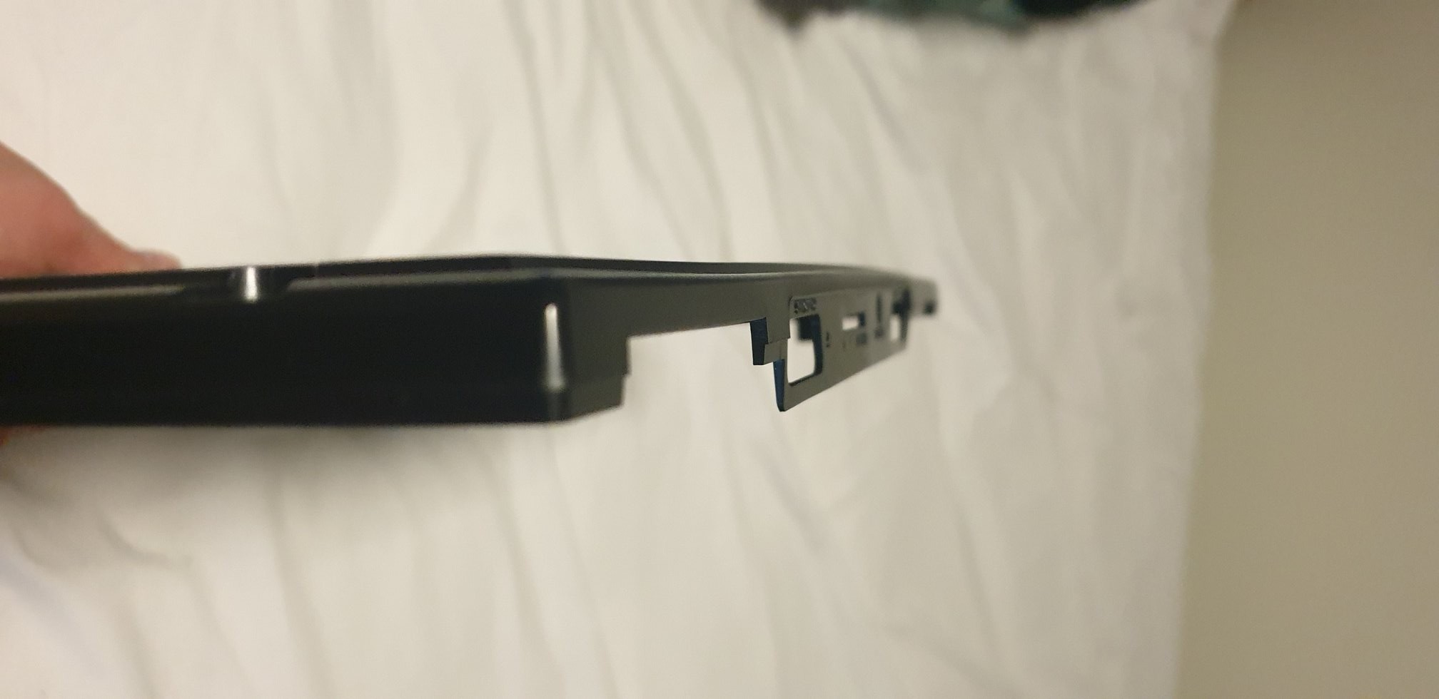

I fix the bottom side of the case, got the hair dryer out and worked it slowly, should have a reasonably flat mobo now when mounted, it was curved a bit someone must of left it in a hot car or something. I checked all the caps and they are in spec.

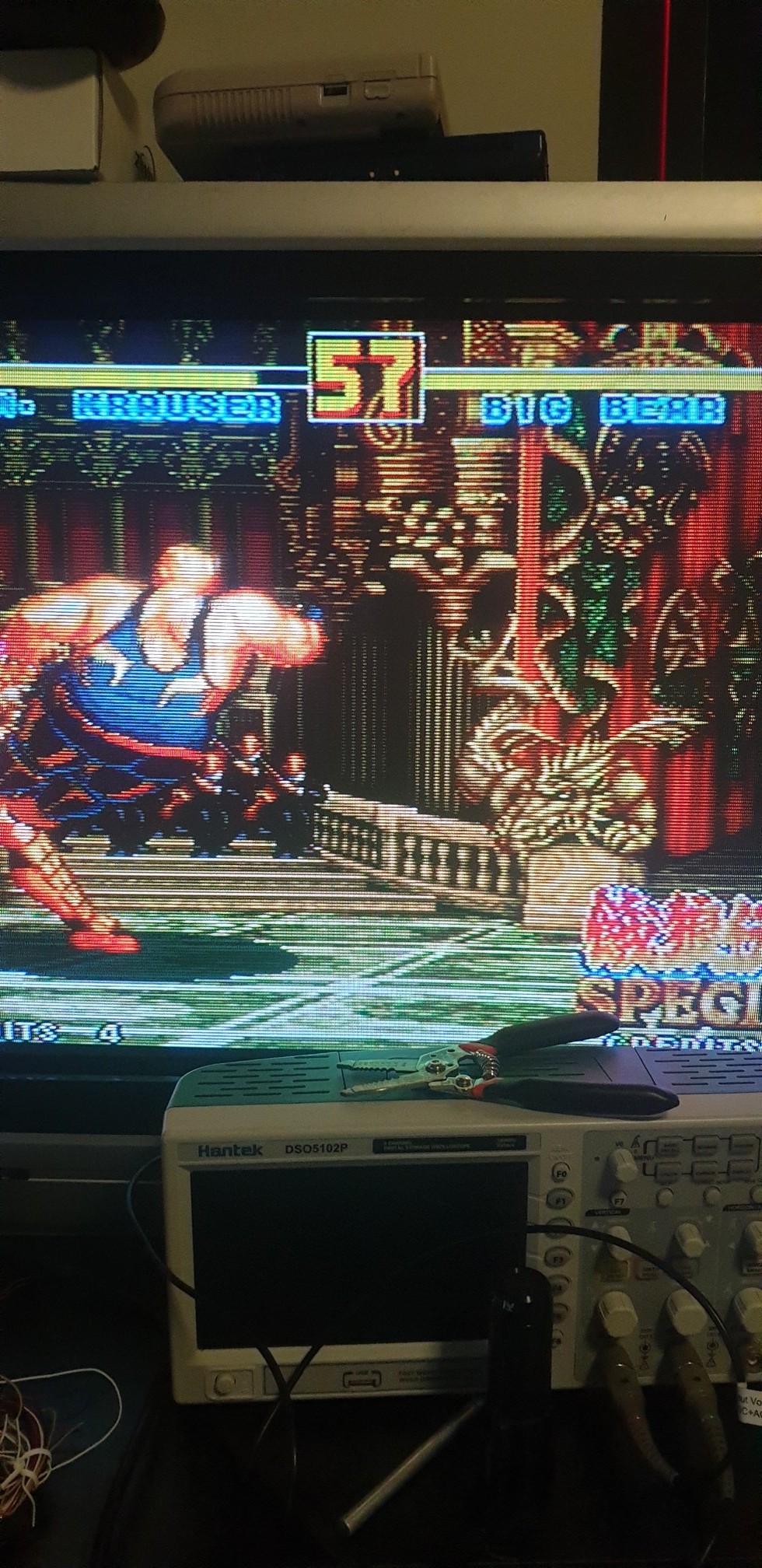

I guess I'm basicly done, thanks for the help, I'll still look into that scart to component. I'm interest in building a mvs and cps2 cab so I'll see ya guys around for some help on those.
