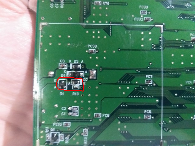

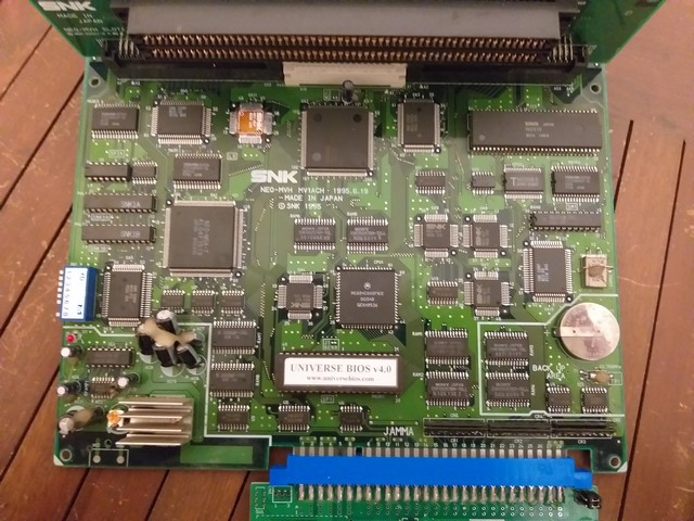

Hello. I've recently received a MV-1ACH (which oddly has a AX board for the cart but I think it's just like that from the start) and planning to replace the battery with the usual battery holder+CR2032 combo. However, unlike the 4-slot, there's no ohm resistor present so I'm unsure as to what needs to be removed.
That all said, what needs to be removed? For a regular MV-1A board, the D1, D2, and R10 are the parts that needs to be removed (as encircled) but I want to verify if that's still the case with the ACH. Thanks for your time.

Just grab a rechargeable ML2032 and use it with that holder. Way better than disabling the recharging circuit.
