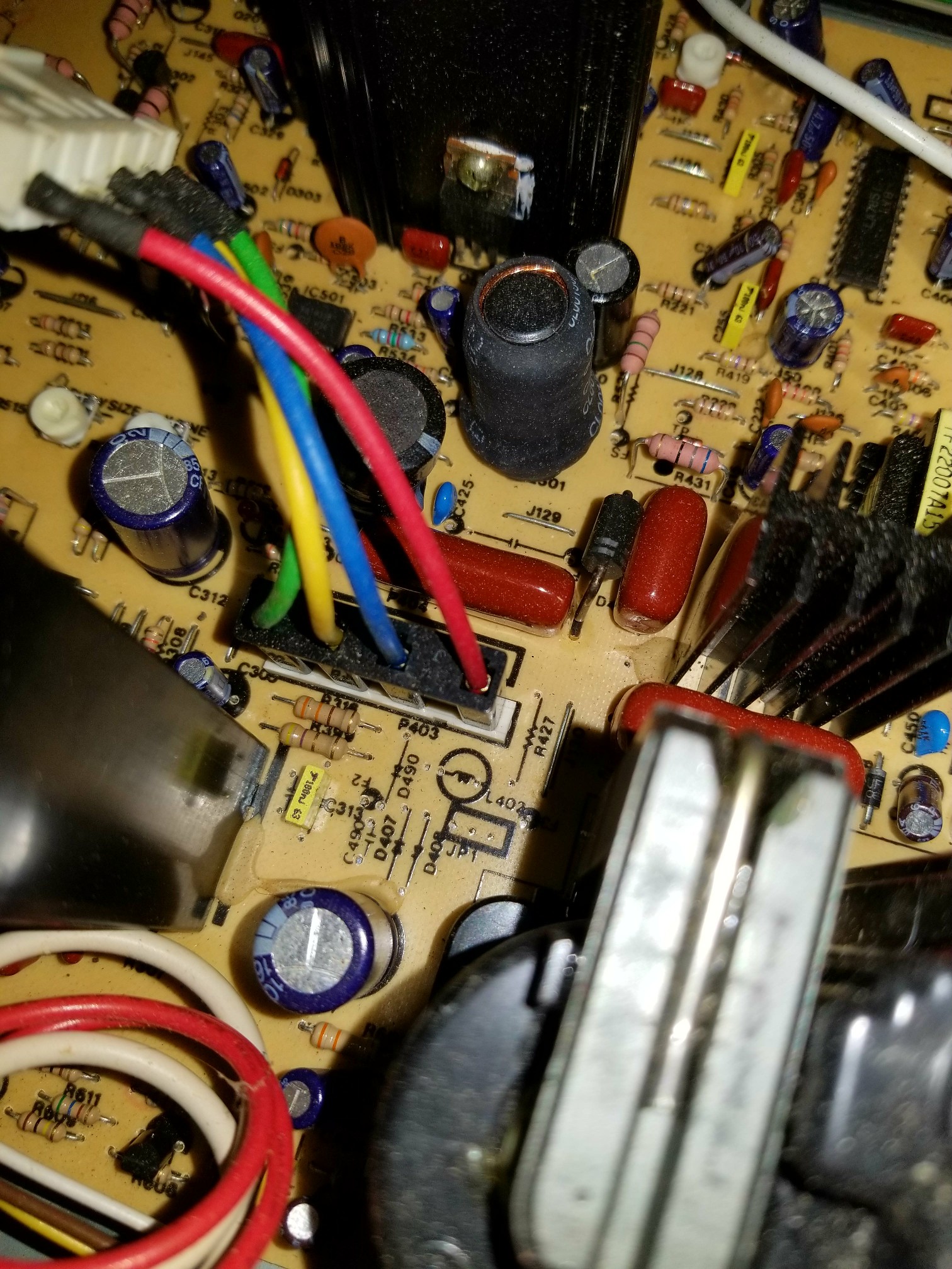

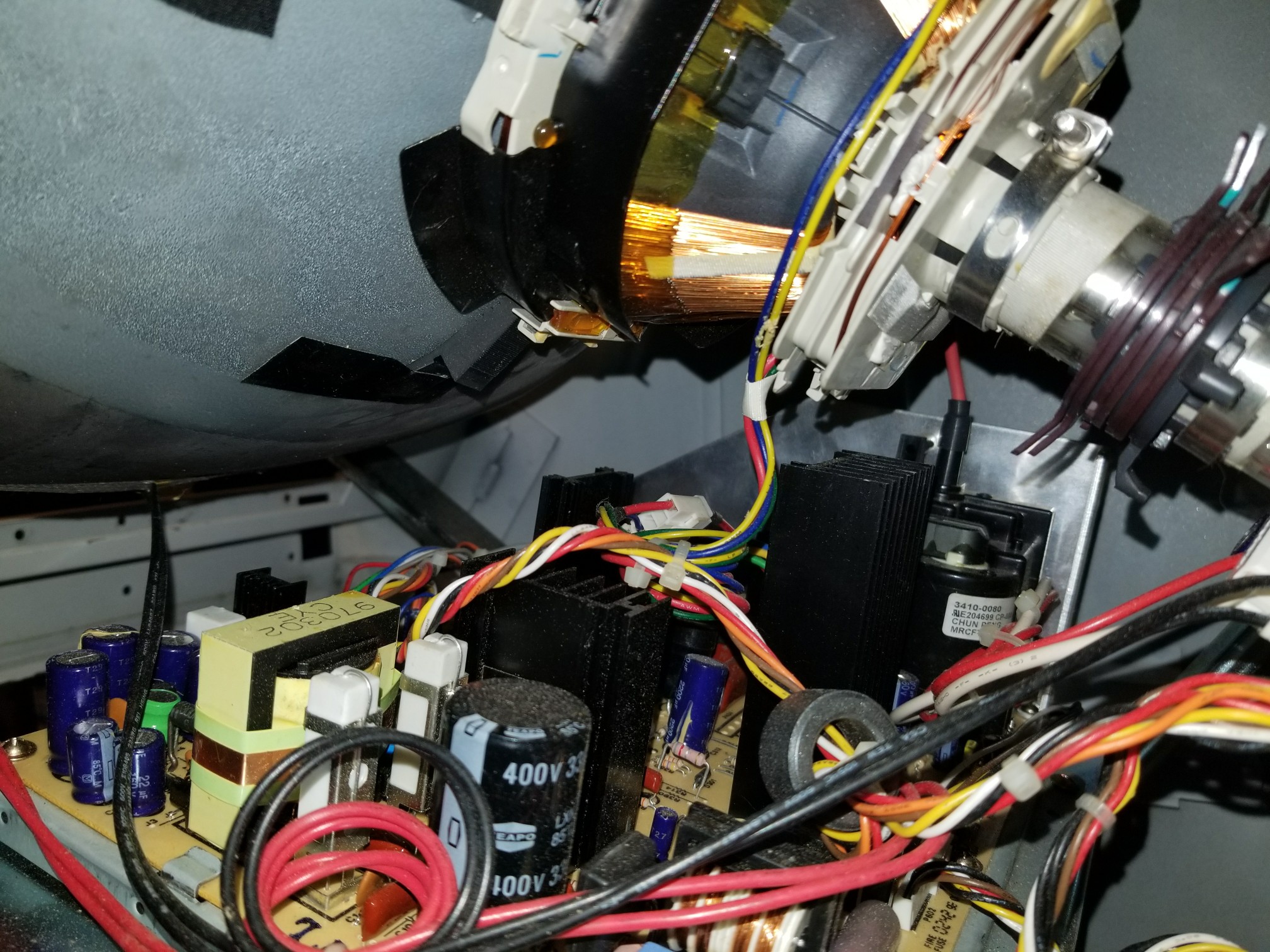

I recently picked up this monitor but
It didn't come with a harness to plug power into.
So I have to make one, there's a white,green,black harness.
How do I wire that up. Also I'm trying to figure out how to
Wire up the video cables,but the only
Colors I see are going to the controls for adjusting(pots)

What do you mean? The white, green and black wires are labeled as AC input. That's your harness. White and black for neutral and live, green for earth ground.
I don't see a video input, but most likely it is labeled as well. Look for anything that has the letters RGBSG (red, green, blue, sync, ground).

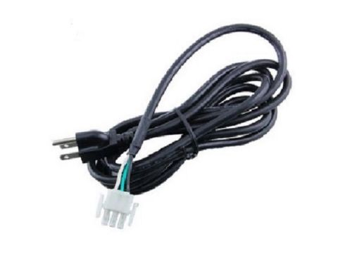

I meant there was no plug for the harness, i found this on ebay and bought it.

Need to find out if this monitor requires an ISO. If it does then you will destroy the monitor by plugging it into the wall. Gotta find that out first.
oh crap thanks for that. What exactly is an iso?

Isolation transformer. I don't think your monitor needs one.

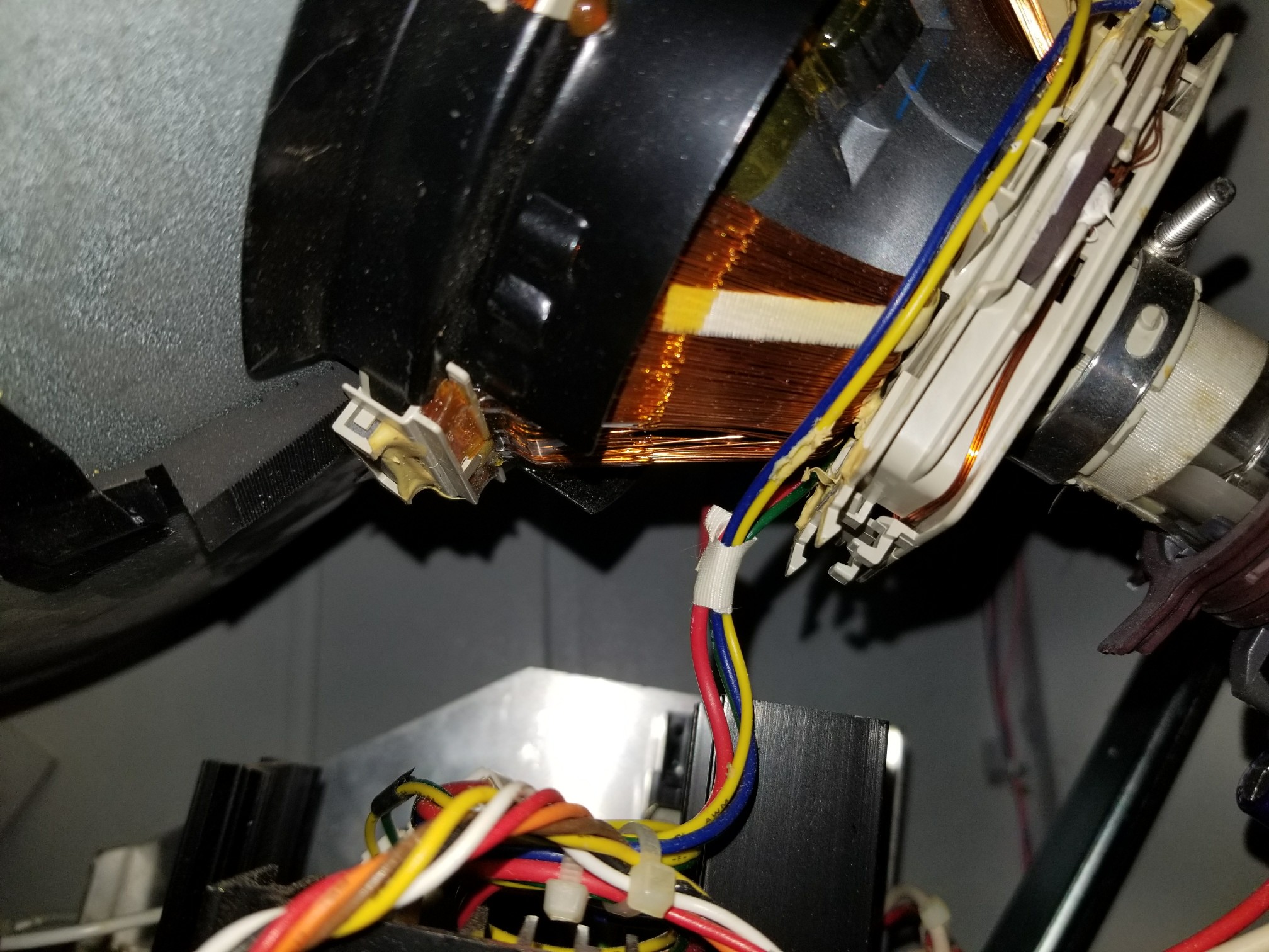

One more thing, my neck board has the pinout
Red Earth Green Earth Blue Earth Earth Hori Vert
The Jamma harness has Video Ground and Video Sync. How do I know if sync goes to hori or vice versa?
