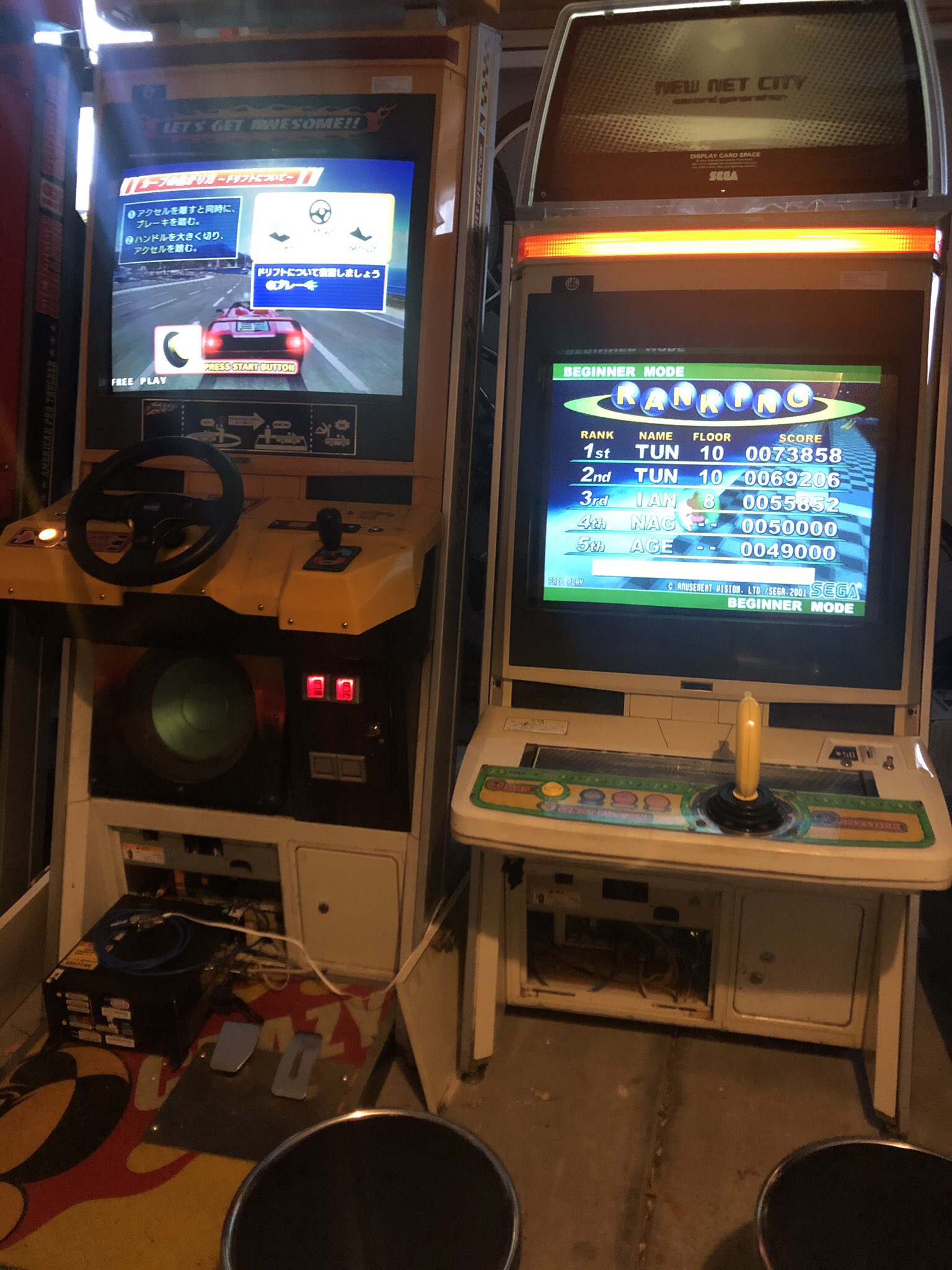

So I’ve been rolling with this setup for a few days, a few bugs need ironed out, but it seems stable. I’ve got both a Chihiro and a Naomi 1 in use now.

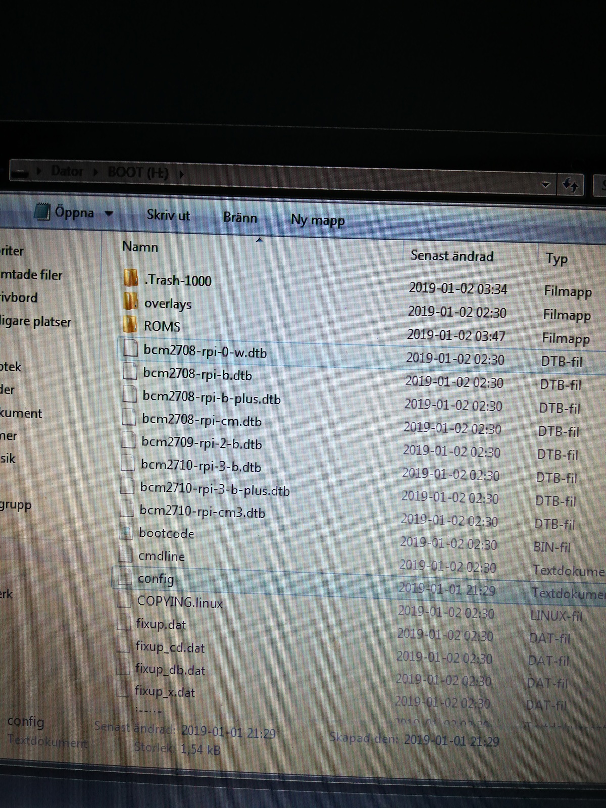

I cannot get it to work.
- formating to fat32
- image file via etcher
- added one rom in "roms"
-Usb stick after image, i can see all partions.
I see leds on rpi on the ethernet and usb stick
The version posted in the 2nd comment does not utilize a usb stick yet. Just follow these directions:
