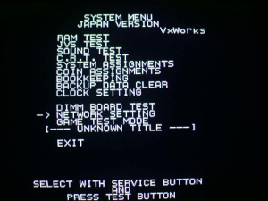

I have a netdimm 4.02 and a Naomi 1 Export with rev H bios (Not Multi). When I boot up I don't see the Network Settings in the test menu. Is this because I need a multibios?

Looks like this...

I was afraid that it did not see the netdimm. But it is infact a netdimm.

As a matter of fact, now that you mention it, when in the test menu I believe the cart reads "unknown cart" or something of that sort. You think maybe it's not making a good connection with the mb or maybe the mb is bad?
Yes that!
You should see the "VxWorks" logo in the top right IF the DIMM is communicating correctly.

I lied! I pulled it out and tested now. Error 34 can't find gateway. Also no vx works logo in the top. I may just have my friend bring his over to test my parts on his setup and vice versa.
Correct me if I'm wrong please.
I assume the Naomi sees the board cause it will let me perform a Dimm Board test. Tests pass and show vers. 4.02
Jumpers are set to NetDimm and not GD Rom.
Still no network settings. None the less. I'll keeps troubleshooting.
Seems like its not fully communicating with the motherboard.
Once the DIMM is installed that "VXWorks" logo appears in the top right of the test menu (only a NetDIMM will do this).
