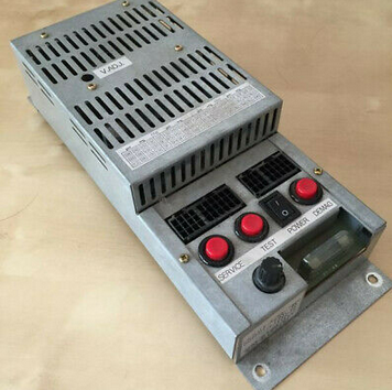

Can't seem to get the right voltages out of my psu, so I want to buy your extra working psu. Please let me know if you have one available.
That particular PSU is notorious for having various power issues. You can get it rebuilt to make it work better, but I recommend just sourcing a 400-5198-01 PSU from a New Astro City which is a straight drop in replacement. They turn up from Yaton on eBay from time to time.
The grey PSU will not run low powered boards like CV-1000 Cave stuff, Brezza Crystal Soft, etc.
