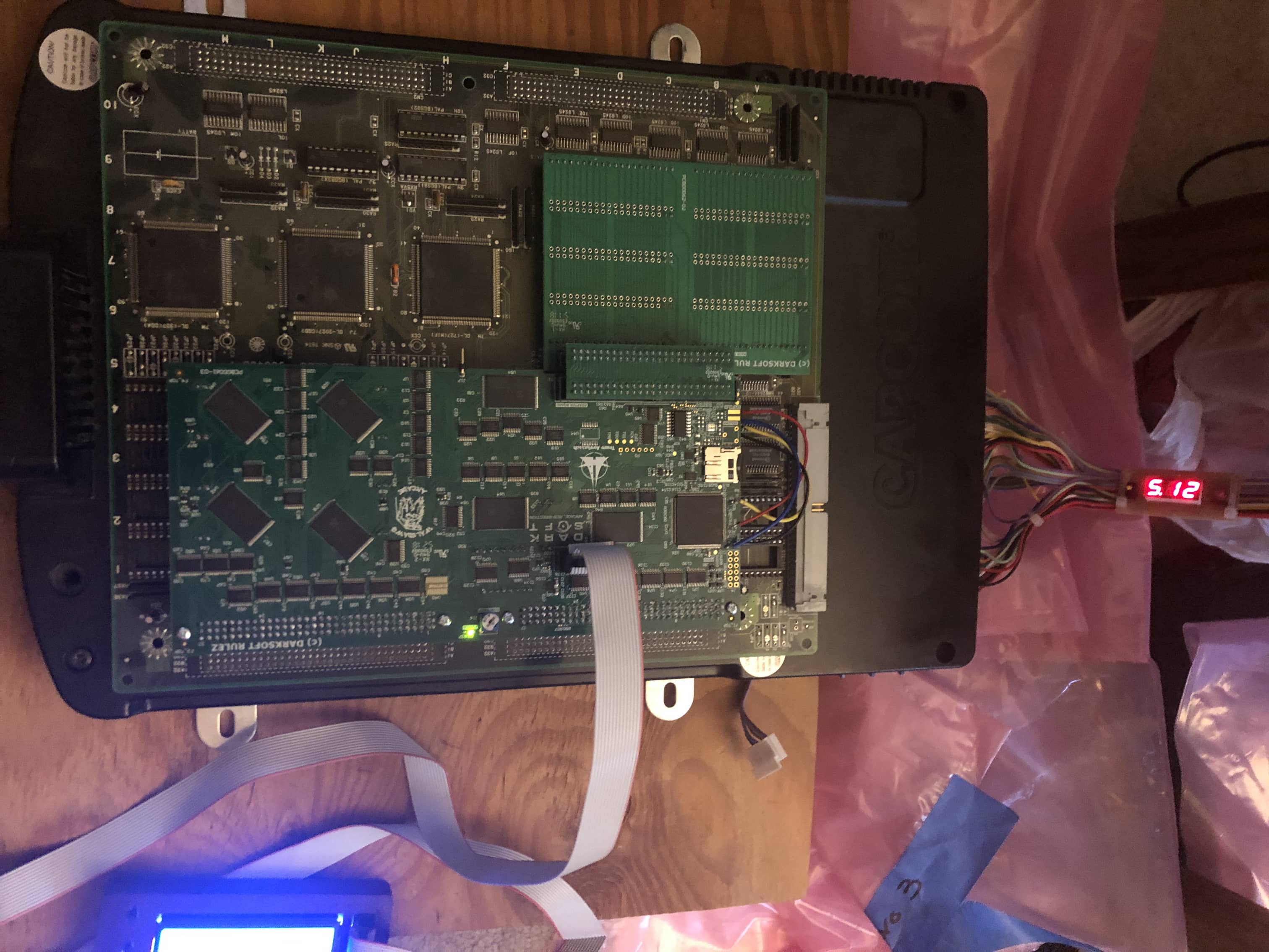

Hi guys, I recently purchased the cps2 multi from high score saves and cant get it to display anything other then a white screen. Ive tried installing the kit on two different boards (rev6 & 7) with the same results. Its currently installed on a rev 7 board With a g pal installed. I double checked the jumpers which match the installation vid. My voltage is at 5.17v. I have the key writing wires connected and tested continuity with a multi meter. Also checked continuity on the two pcbs for the kit. Im using an 8g sandisk that came with it. The lcd display shows the game name and says have fun. During the writing process the screen goes black then returns to white after its done loading a game. Any help would be greatly appreciated. Not really sure what to do from here.
Thanks ive checked out the section on the white screen issue but all the possible issues seem to be fine. No bent or broken pins. And the sd card seems to work fine. Ill pop up some pics.

I had the same issue. It ended up being that the little interconnect pcb was not seated all the way. You have to ensure its seated all the way down, it tends to want to sit an an angle.

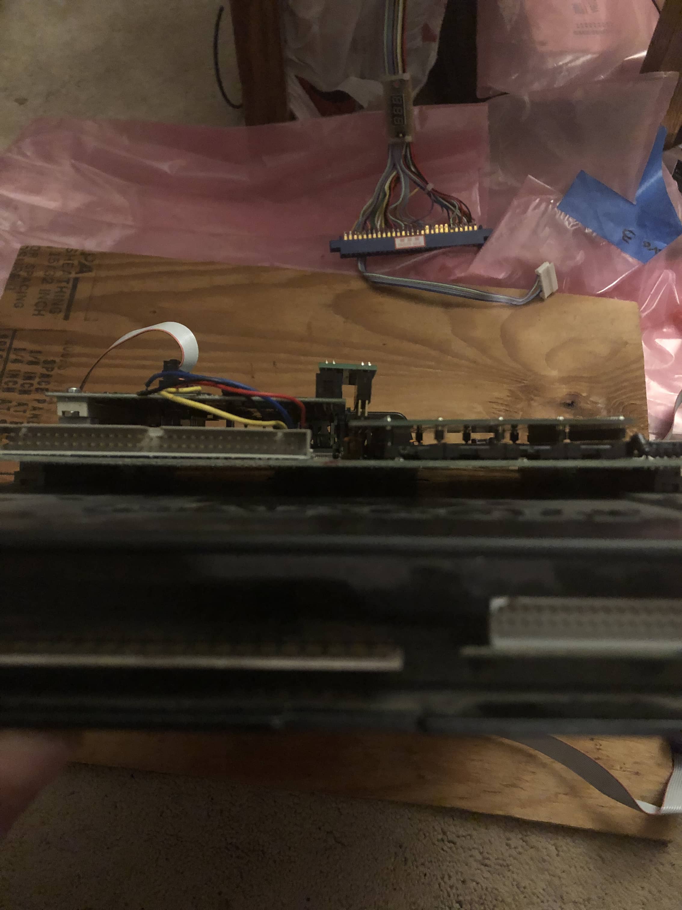

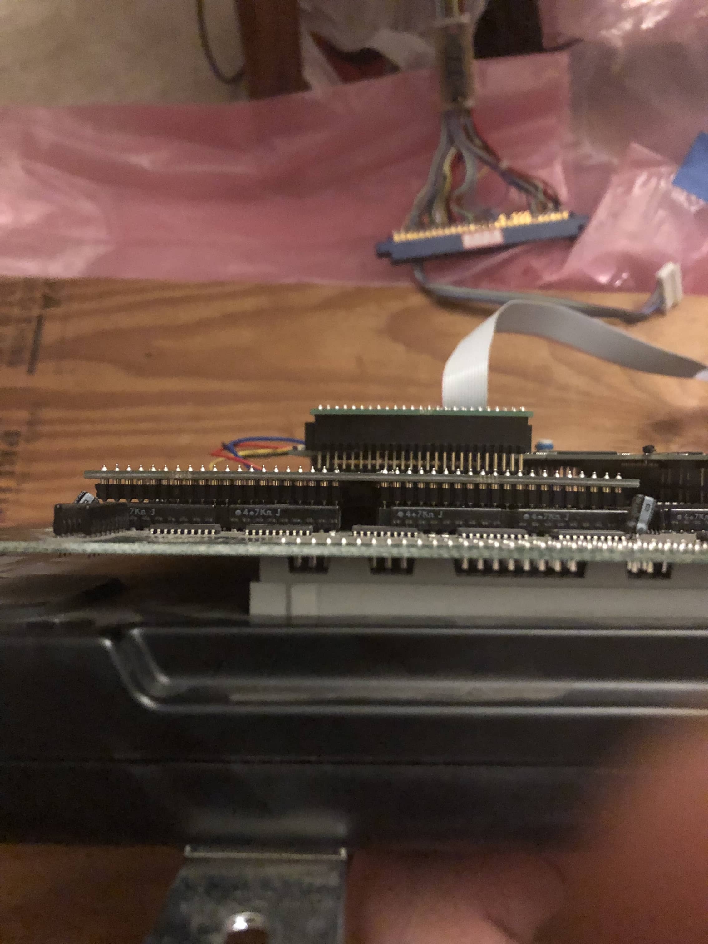

Take a picture of the PCB from the side so we can see how it's connecting the two PCBs together.
Heres a pic of the front and side. Think I have them pushed down as far as they will go.

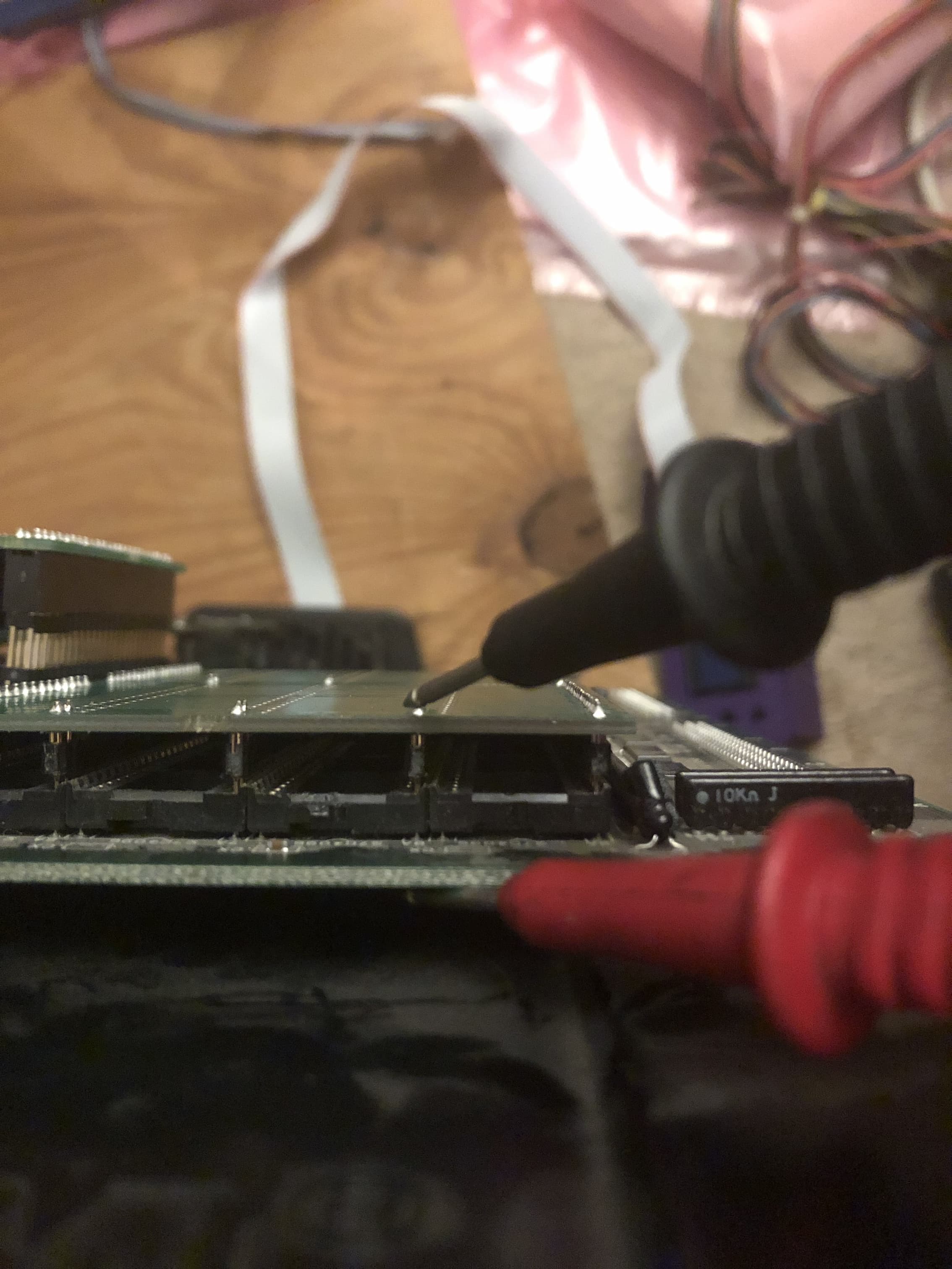

Ok i just removed the little pcb that joins the two bigger ones together. Then made sure the two pcbs are pushed down as much as i can. Then pushed down the joining pcb all the way.
Got the multi meter back out and tested continuity between the pins on top of the kit with the pins under the B board. Theyre all making contact. But im still getting the white screen.

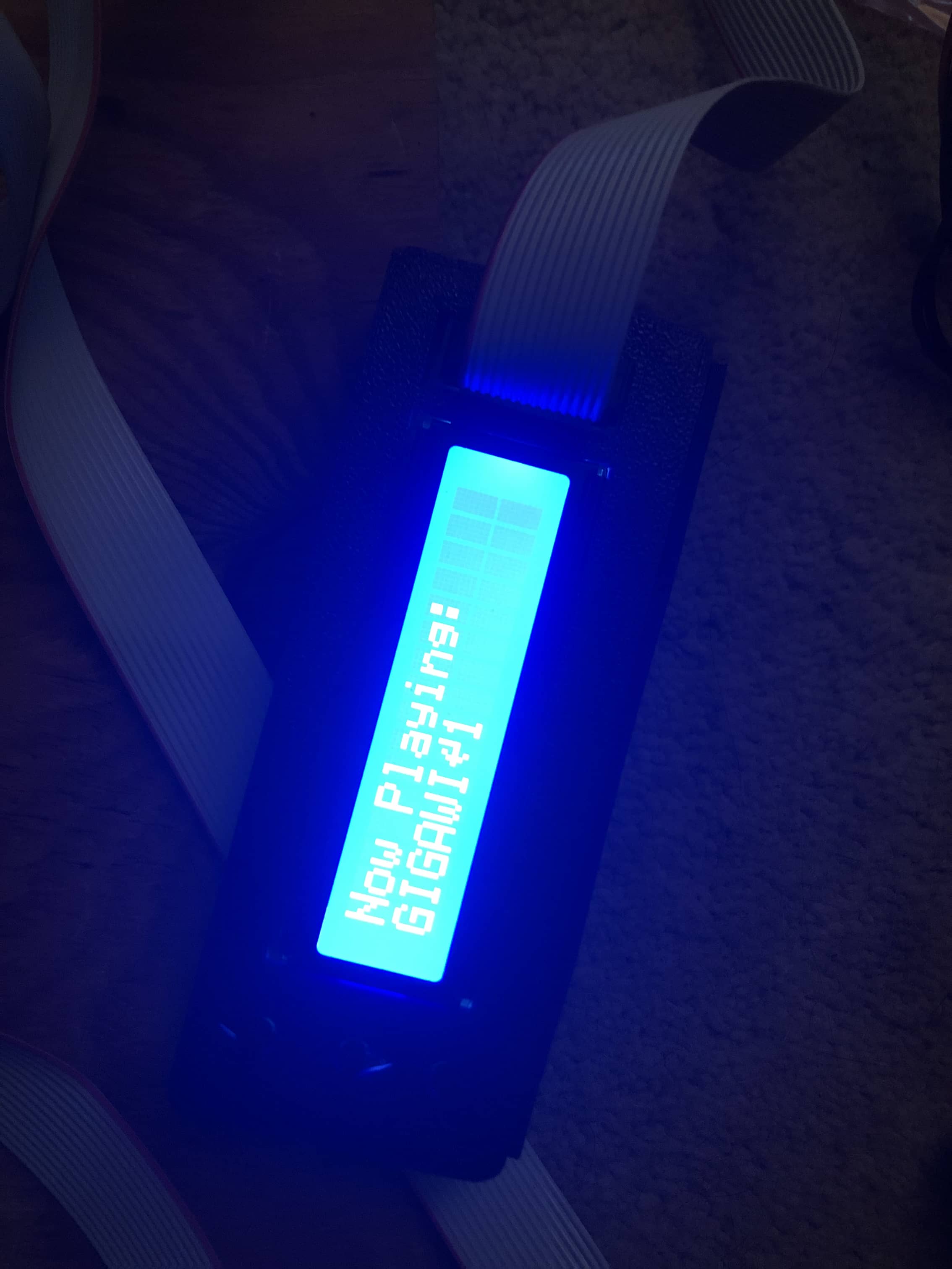

your LCD screen has a weird name for the gigawing game. Did you download the roll up packs and make a custom one? Which roms do you have?
I sure didnt use the roll up pack. I was having trouble downloading it. I found a site that had cps2 roms and added giga wing and eco fighters. I actually tried a few roms from a couple different sites. Is the roll up pack mandatory? Im gonna try downloading It again on a friends computer.
Files in the rollup are prepared correctly and include the mandatory key file. Try this link I think it’s the full mame set: https://mega.nz/#!kkx2jJqL!jKJAnCevg8woKYXrcQFN3QU4icryCm6Sp4ba0McHPds
And the smaller USA-region set along with some nice hacks: https://mega.nz/#!VhwwUShT!S7HWQsrKQjwYiRGcTspnCRuDBBf2aSyC796FxPYqCc8
yep, that's gonna be the problem. You need the files in the roll up pack. Try the links above and let us know
Problem solved! You guys were totally right. Thanks so much! Fired right up when i used the roll up pack.
