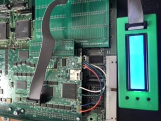

Argh...my CPS2 multi was working fine but now no LCD display. Still works fine and all games working great. Tried switching with another known good cable but still no display on the LCD. Tried adjusting the Contrast dual on the board but still no text on the LCD. Help!

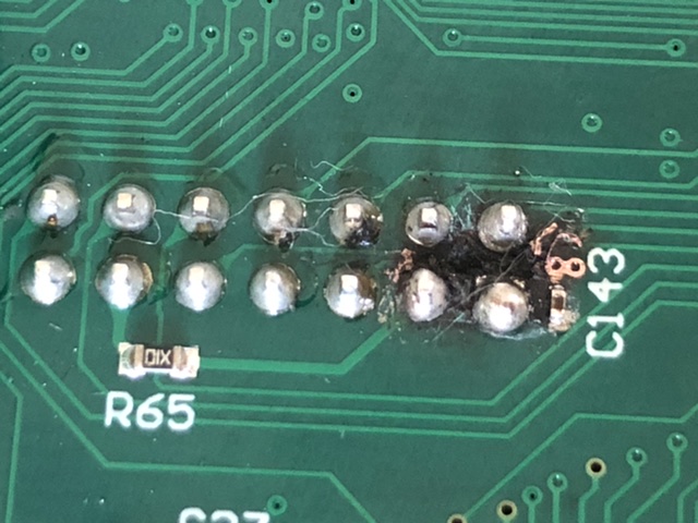

Looked at the other side of the LCD connector and...Uh oh. :-( Now I know what caused that burning smell. Must’ve happened when I tried to switch to a longer LCD cable. Damn...totally my fault. Can it be saved? Titles still burn & play fine, just no LCD display...

Clean it up and add some bodge wires to replace the damaged traces. Hopefully it will resurrect.
