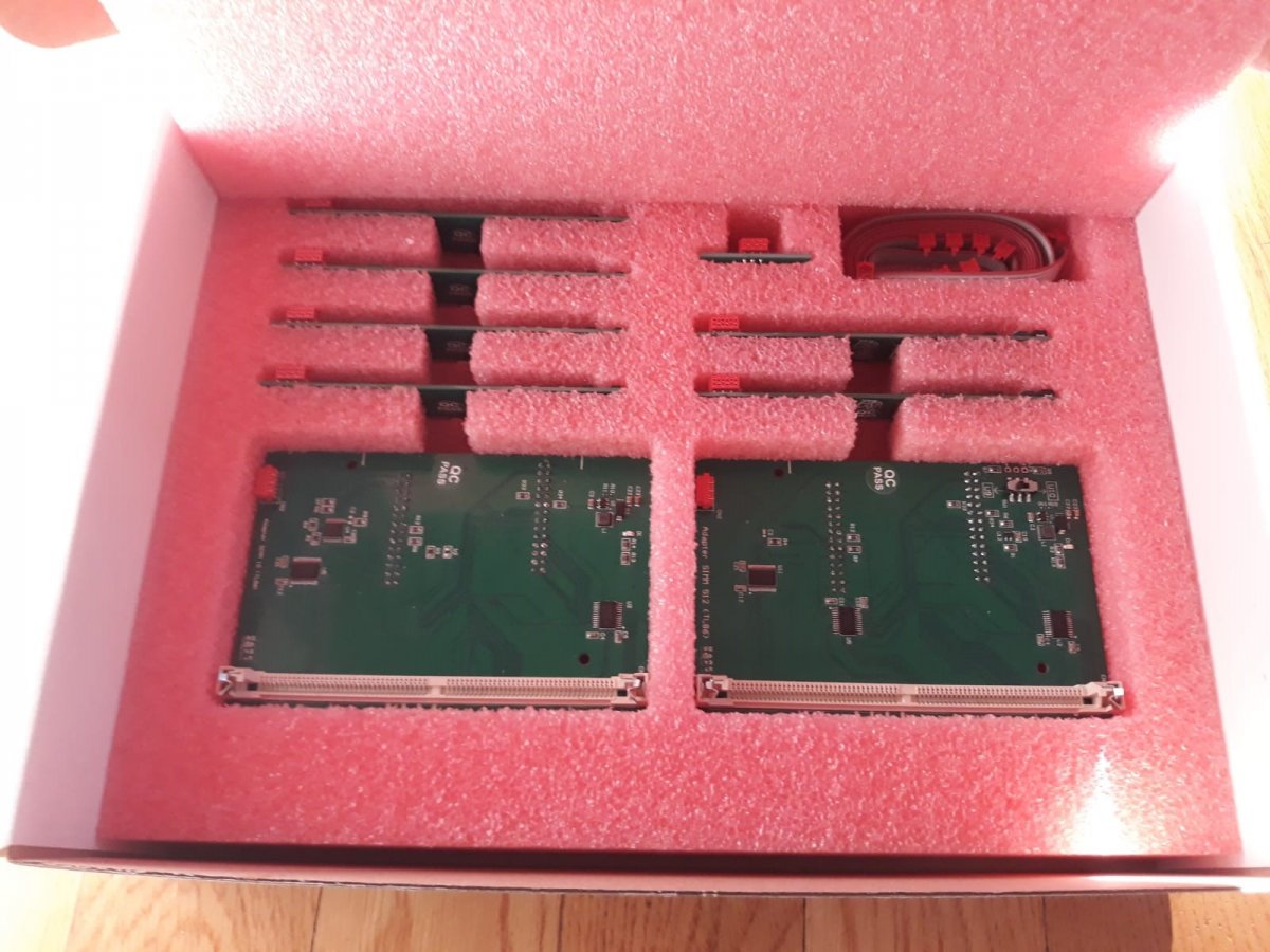

New CPSIII Ultra Simms !!! With 8x the capacity of a regular SIMM
